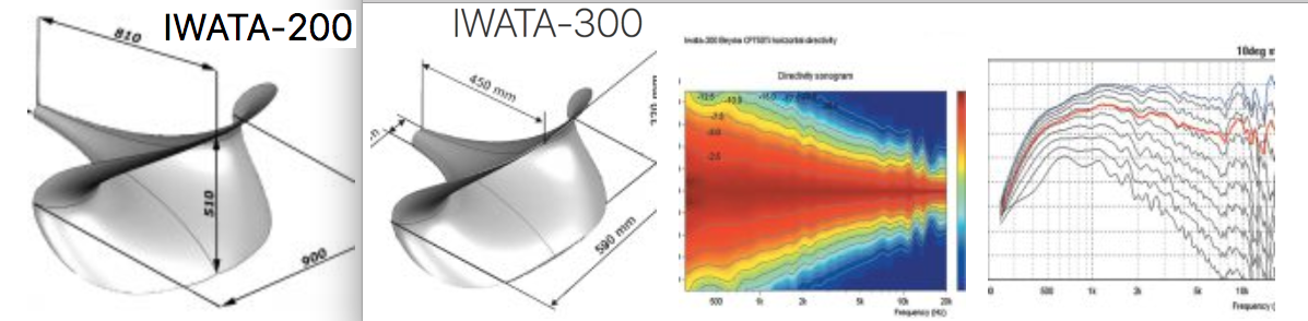

The Iwata series of horns are not constant directivity, their polar response is similar to your AH425.But I assume that Iwata 200 is among the best of the very few constant directivity horns available for above my midwoofers.
The Iwata 200 is 900mm (34.4inch) wide, it can be used to a lower frequency than your AH425.
He uses a very large, beamy horn with an unusual driver sitting atop various cabinets in his unfinished system.And Camplo advised to go with the largest horn my cabinets and budget can support.
More than six years since he started on a quest to build his monitors, originally the plan was to copy the JBL M2 specs, a monitor using a shallow, wide constant directivity horn.
Audiohorn's largest X-Shape is less then half the width of the Iwata-200, his largest bi-radial has a similar width as the Iwata-300. They are not comparable in size or polar response to the beamy horns.So far, I can find only these constant directivity horns of comparable size.

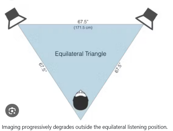

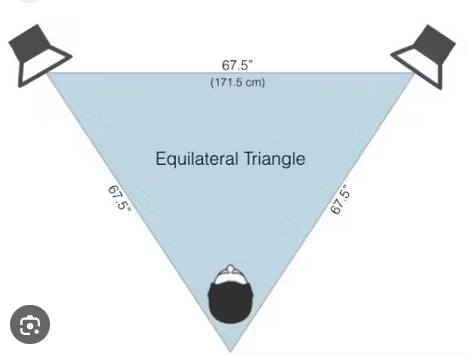

For stereo imaging to present a reasonable facsimile of the recording, it is assumed an equilateral listening triangle will be used by the listener, as it was for the recording and mastering engineers:
Imaging progressively degrades outside the equilateral listening position.
I like to arrive or book seats early at movie theaters to get that position.
As my hearing has degraded with age, I find the "sweet spot" has become smaller, at most one row ahead or behind, and a seat or two left or right and the "suspension of disbelief" dies.
If you increase your equilateral triangle dimensions over the minimum required by your screen size, it makes the asymmetrical room reflections more apparent, degrading imaging.
Wider dispersion increases the coverage area, but won't improve imaging, hence my reluctance to recommend any constant directivity horn over your beamy (but very smooth) AH425s, considering you are the primary listener.

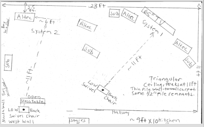

But Weltersys said he needs me to describe my room in more detail beyond that flaky sketch I posted. Looks like I have a schittier (asymetrical) room than I thought, leaving me with less choice among horn options without consequence. However, no matter his final evaluations of my room, Art will still probably nudge me towards using the AH425 horns, just because I have them. 😉
So let me get this straight, you have the altecs, you have the radian cd's and the azura 425's and you're just wringing your hands and stressing if they are the right choice but have not tried them? Life is short brotha.Art will still probably nudge me towards using the AH425 horns, just because I have them
That's an early "idealized" sketch, where I thought my room was acoustically better than you've now described it to be. Indeed, if my room's size and acoustical environment could support it, I'd much rather dedicated these speakers Troy's building for me (horn/driver TBD) for music only. And might those be best placed diagonally, as shown in the sketch?Imaging progressively degrades outside the equilateral listening position.

Then have the TV towards the northeast corner on the east wall (it's there now). And get a pair of Revel, Wharfdale or other brand of mains and center speaker to use with my subs for a 3.1 system for DVD and BD movie sound. Hopefully, the reflections created by those extra objects in the room could still be reduced after careful boundary effects measurements and room treatment.
By dedicated Troy's build for music only and placed accordingly might that allow me more freedom to choose among horns?
