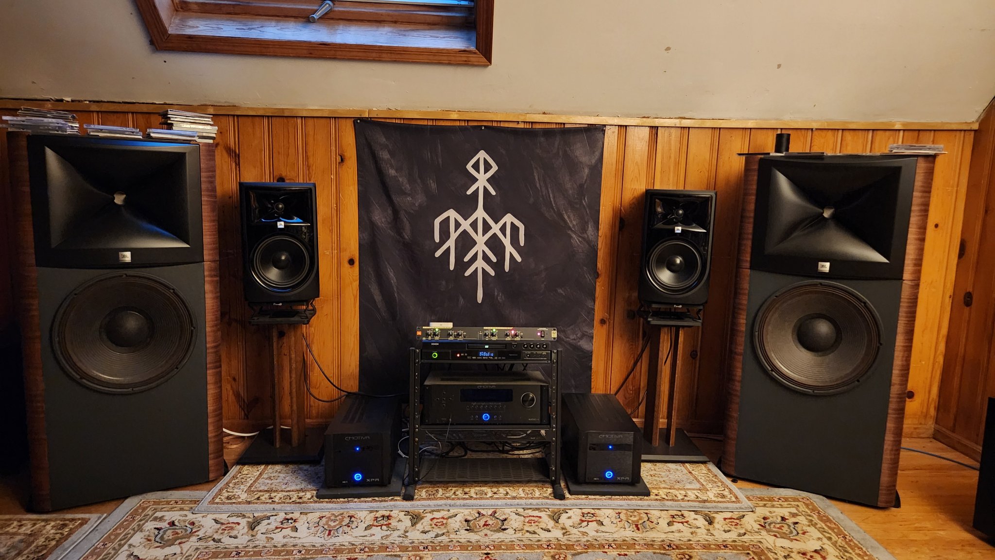

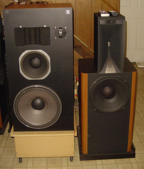

Auditioning those three speaker systems.
Getting a pair of JBL2450J restored and Be diaphragms installed by end of April.

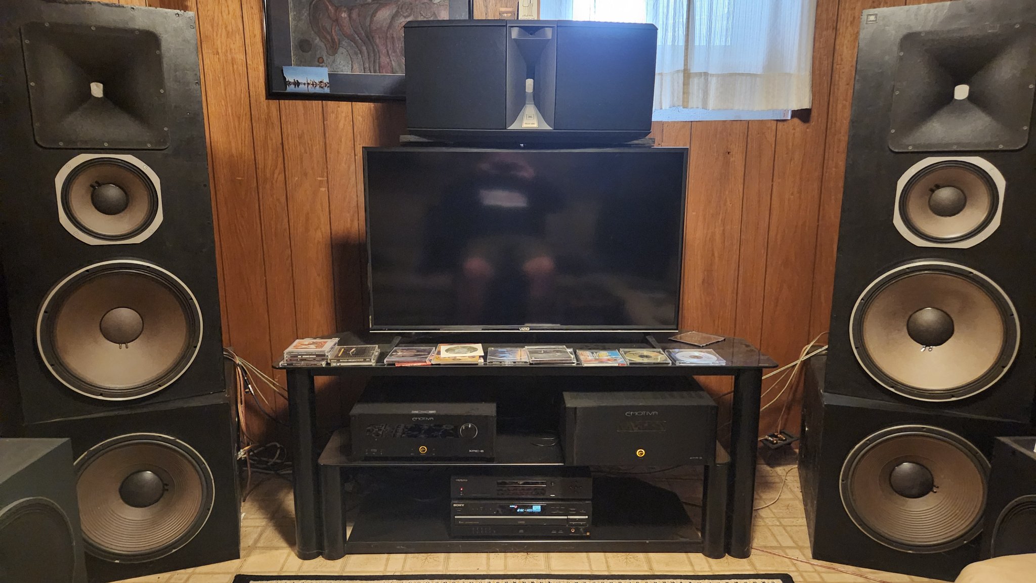

I have 2 systems that are using 100 X 100 and 120 X100. My third uses 80 X 80. In all toe in and distance are key. My best imaging are the 80 X 80 and the 120 X 100. The 100 X 100 is no slouch but takes a back seat because of size and distance between drivers. As with any system once you dial them in your are good to go,
Not sure what you mean by what aspects? Either they image well or they don't.
The 4344 compared to the Array Clone 80 X 80 using the same Be load as the 9800 is exemplary. The 4344 is old school and as much a I like it pales in comparison. The passive M2 120 X100 is right up there with the Array and has even better image stability. My active 4 way using PTH 1010 100X100 is the "DOG" but my reference point and would surprise anyone going on looks alone.
I have a preference for CD horns, you may not hence the importance of taking some time to hear systems in real rooms so you can determine for yourself what you like. In my rooms they seem to work best.
