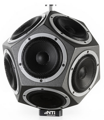

Thus, the ES290 may create more indirect sound (more secondary reflections?), and thereby generate a more spacious sound than the narrower ES450.
But I'm wondering if a true constant directivity horn may be a better choice-and if so choose that as an option for second speaker build. Like one of the JBL CD horns those here have mentioned. Or the TH4001, which at least in the horizontal plane is basically CD. Or does might that horn have some issues? https://audiohorn.net/img/bi-radial/TAD-TH4001-polar.jpg
If you prefer the sound of more reflections, adding more of your room's sonic character to what you hear, then wider coverage would be the obvious choice.
A dodecahedron speaker is near the ultimate for creating more indirect sound.
