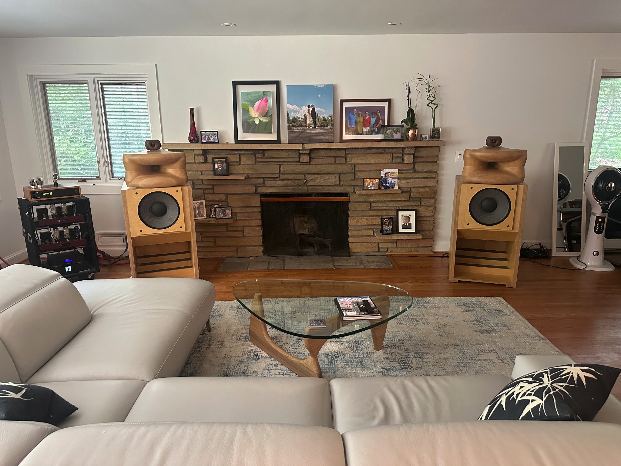

Need help deciding.
Go with the parts you have. I have a feeling you'll be fretting after the fact regardless of which you choose: At least this way you won't be throwing good money after bad.
I know that all sound like good advice. I have a pair of the AH425 horns but though they and the ES450s have similar directivity patterns there are likely some substantially audible differences-and I've given up seeking invitations to hear the AH425s.
I am not nor have time to become a competent DIYer anywhere near soon enough, so it would be unwise to have Troy Crowe spend who knows how long it would take designing a contouring filter for a 425 horn/Radian 745Be combo. Furthermore, Pierre and g3dahl were the only ones I know who did this. Gary ended up rejecting the "hardness". After numerous attempts Pierre's filter worked a while. But he permanently swapped the Radians 745 Bes into TH4001 horns, and sold the 425s, which as I've noticed quite a few have.
AFAIK, Gary has long and continues enjoying the 425 horns with Yamaha JA6681B drivers, albeit without response > 10kHz, due to problems integrating his Raal Lazy ribbon tweeters; see attached. However, I recall Weltersys recently noting those tweeter issues might be due to lack of absorbent material applied to rear of 425 horns (?). I also have a pair of JA6681B drivers tested by Troy, but won't risk getting those pricey Raal ribbons for want of a proven system, and no other practical HF range solution looks doable.
I thought of going with the tweeterless Yamaha/425 combo atop my clones of Gary's midwoofers if I had at least once heard the 425s. But never even heard the Quad 57 ESLs, which I think Lynn Olson once likened them to.
Then is the ES450 horn with B&C DCM50 8 ohm/Fostex T96A + Low Diffraction Lens. At least I heard that combo. I had two hours hearing it play my files on Glen's system, though I was a bit tired and anxious due to almost failing to fix a software driver glitch on my laptop which could have made the whole listening session impossible. It all had a relaxed and neutral and generally agreeable sound, but I'm wondering if the 16 ohm version would have worked better for Glen's Triode Labs 45 tube amps, as the 16 ohm version is commonly used throughout most of Troy's builds. https://josephcrowe.com/pages/project-matrix?_pos=8&_sid=4c8e4bf2a&_ss=r And one of my amps will likely insist on it.

I thought about using the Radian 745Be in the ES450 horns, but not if a throat adapter was needed, assuming Troy's contouring filter could make that two-way combo way sound better than what I heard from the ES450 last month.
Otherwise, I'm inclined towards deciding between the ES450/DCM50 16 ohm/Fostex T925A and AH425/Yamaha. Either one should give me focused direct sound and very good imaging.
Beyond that, how to decide? This may sound trivial but unless an auto body shop is the best place to get the 425 horns painted then it has to be the ES450. I usually keep subdued lighting in my room and can't have big round white things staring at me.
What of the Radians Bes? Later after using the system and after my room is fully evaluated I'll be seeking help deciding on constant directivity horn options to build a two-way system for realizing the best spacious sound which I also want to experience.

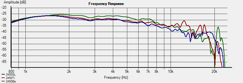

Would you, by a chance have a comparison with Ti SL diaphragm under the same input signal?
Look here:
https://www.audioheritage.org/vbulletin/showthread.php?31657-Truextent-diaphragms-measurements

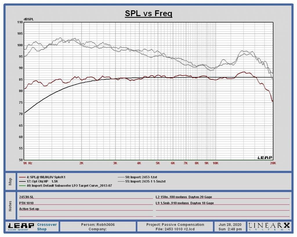

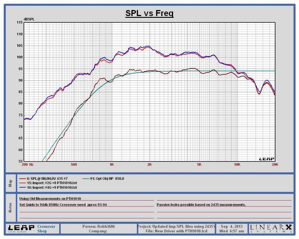

Hello

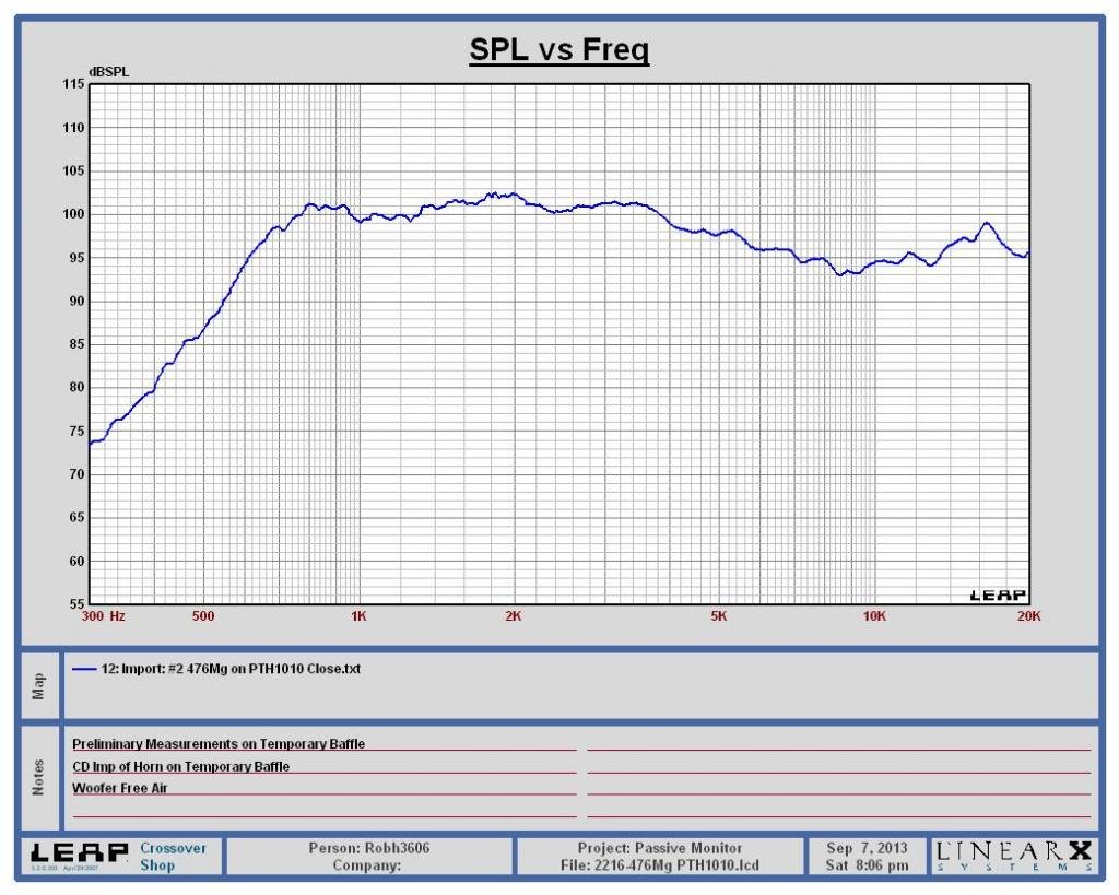

I ended up with a pair of 2216's that were power tested and a pair of 435 Be's from the JBL lab. I wanted to do a passive 2 way based on the M2 design. When I looked at matching the sensitivity it was an issue WRT a comp curve and the HF roll off. I was lucky and sourced a pair or 476 Mg's which have a rising HF in comparison. Then I swapped my aguaplas coated 2435's in my active set-up for 2453SL's a year later.
It's not a 1 to 1 but it gives you a trend. The SL's are cleaner than the embossed uncoated Ti's. Just look at the plane wave tube measurements on Lansing Heritage for various CD's.
These are all measured on the same wave guide a PTH 1010. The Be roll off can be an issue if you can't bring down the midrange below a certain SPL level doing it passive. Active like the 2435's used in Vertec it's a moot point. It's all about how you plan on using the drivers.
Rob 🙂

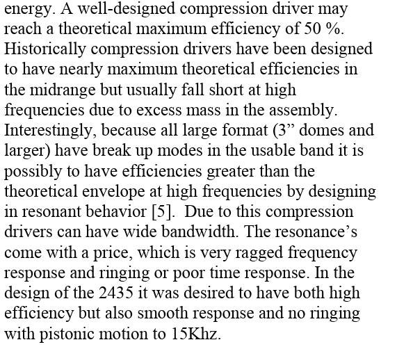

The 2435 was designed with the HF rolloff intentionally, looking to achieve "pistonic" action to 15khz and trying to avoid diaphragm and surround resonances.I ended up with a pair of 2216's that were power tested and a pair of 435 Be's from the JBL lab. I wanted to do a passive 2 way based on the M2 design. When I looked at matching the sensitivity it was an issue WRT a comp curve and the HF roll off.
There is also the different phase plug, and smooth half roll surround.
Your 476's also incorporates a copper shorting sleeve in the motor structure to keep inductance flat so there is no rolloff due to that, which will help with the rising response.
Whereas the TAD's use the half roll surround resonance to extend the 'flat" response.
Same does the TI/SL drivers with the diaphragm resonnaces, just the SL is damped.
And that is the idea of the diamond surround and Coherent wave phasing plug too.

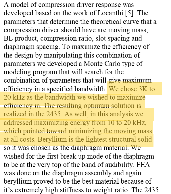

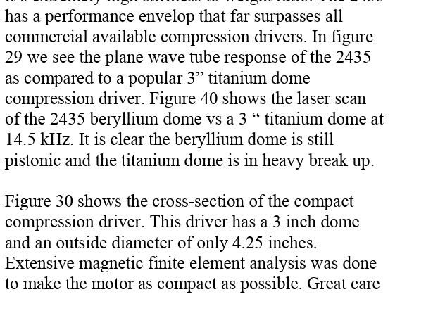

Hello Arez

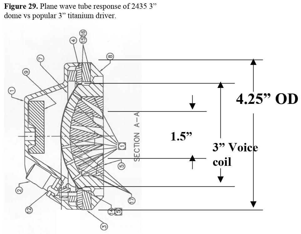

Not sure about that. It contradicts what's in the paper I highlighted the section. Pistonic in the last octave is not necessarily rolled off. You also have to remember intended use in the Vertec's. They were EQ'd +12 Db @ 16K then a low-pass at 22K. Yes use a mylar surround with ferro fluid.
Rob 🙂

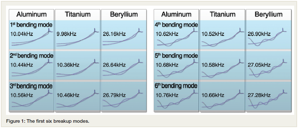

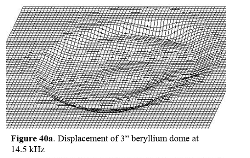

The first picture explains it very clear actually. actually Also fits Buttons rationale when it comes to hf driver design.Not sure about that. It contradicts what's in the paper I highlighted the section. Pistonic in the last octave is not necessarily rolled off.
There is no way to avoid resonances in a 3-4" dome at 15khz, wavelength is ca 22mm, the wavelengths are too short for such a large surface and you get bending modes/breakup in the diaphragm even when using Beryllium. As far as i'm aware there never was made a CVD diamond diaphragm for a compression driver, also would be heavy. Mitsubishi/Diatone also had a interesting boron/ Carbon material from 2016 that looked promising.
This is the diaphragm in question at 14,5khz, it's already not pistonic anymore per se.
Just as with a woofer/mid whatever going too high.
Yes it is as there is not a single large format compression driver that does not exhibit bending modes/breakup and resonances when used out to 20k, the question is more how many modes are acceptable, and how well the diaphragm is damped, how the surround acts in damping resonances etc.Pistonic in the last octave is not necessarily rolled off.
Also a dip might be easier to live with then a peak caused by the same.

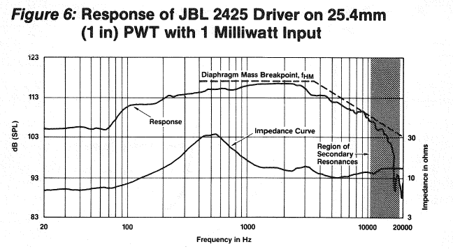

There is nothing you want to do to reduce the drivers output in band, the challenge is the fairly large HF dropoff that's there already.
Only a concern if you want to implement a tweeter.
Either the HF is dropping past the mass break point - fHM , or the response is "modulated" by resonances / secondary output to extend the useful "flat response", there is no way completely around the laws of physics. That is disregarding any horn, as measured in a PWT.
As you can see in any compression driver the low end has output climbing until the mass breakpoint, before it falls off just look at the pic. below.

If you want to experiment with taming the top end of it, kill the large breakup modes after 20khz and measure/evaluate.
