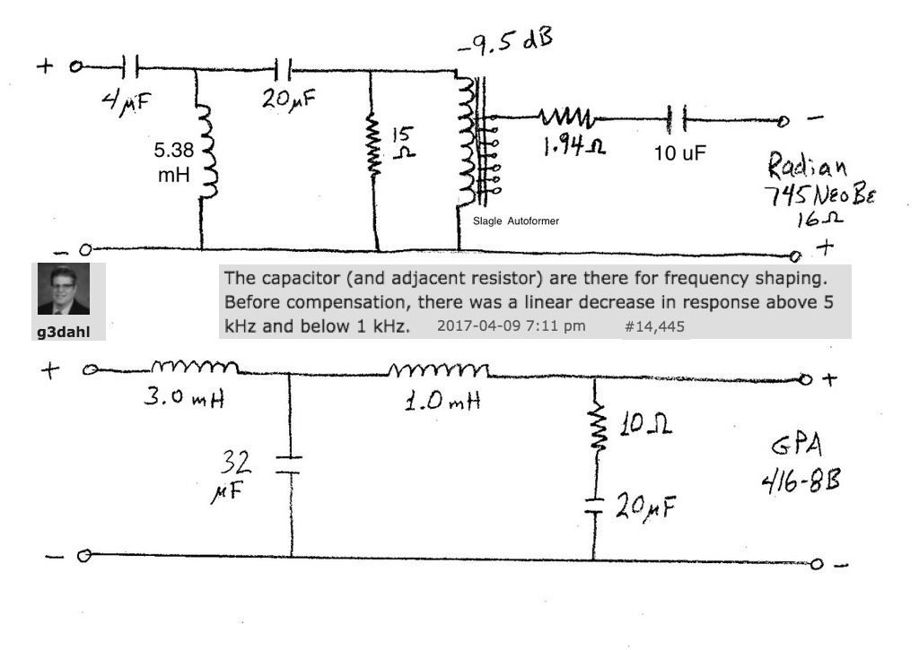

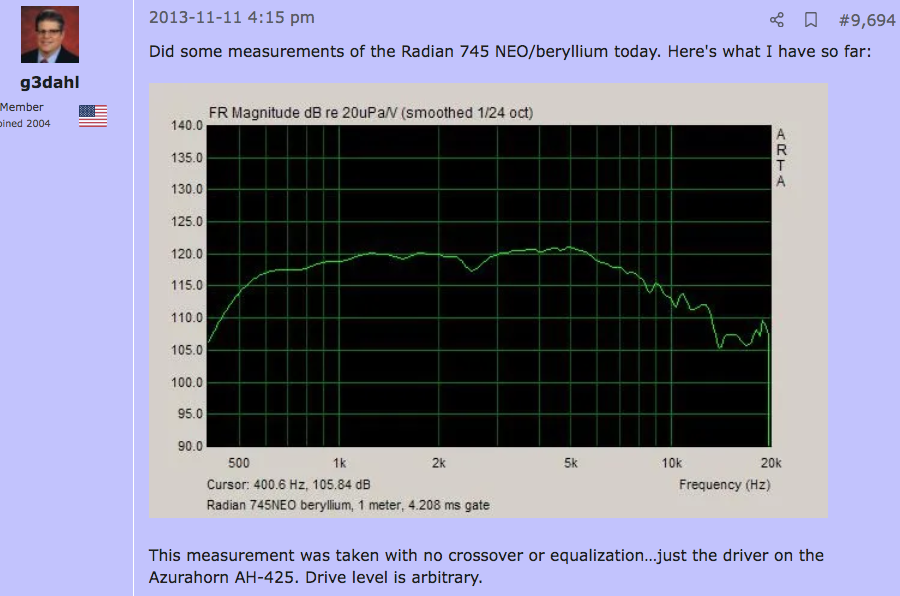

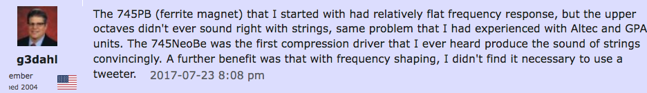

The -6dB downward sloping response of the AH425/Radian745Be is easily corrected to flat with a single capacitor and resistor.Last week I thought that if Troy agrees to this, I would send him my 425 horns and use them with either the Yamaha JA6681B drivers-exactly like Gary Dahl has in the 425s above his Altec midwoofers that I had cloned-or another driver. Unlike the Yamahas, the Radian Bes need EQ and must be done very precisely-and which was why Gary gave up with using the Radian 745Bes originally in the 425s when he failed to perfect the filter.

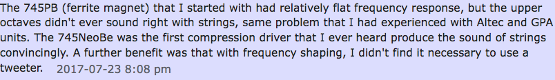

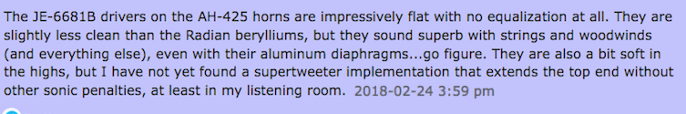

Later, Gary switched to the JA6681B drivers, but finding them soft in the high end, added RAAL ribbon tweeters.
Then in 2018, he indicated he hadn't yet found a supertweeter implementation that extends the top end without other penalties:
I'd guess he preferred the "soft highs" to the convincing string sound.

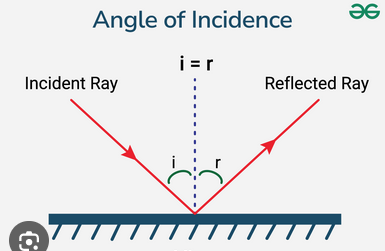

Your room walls will react to high frequency sound waves similar to a shining a light at a mirror, the angle of the reflected waves are equal to the incident ray:
Non-symmetrical reflections will distort the sense of space present in the recording and make localization cues amorphous.

It is less flat for two reasons. The Be diaphragm has a higher midband sensitivity so there will be a more pronounced 'hump' before the mass breakpoint.The Radian 745Neo becomes less flat when equipped with a beryllium diaphragm. I did as much as I could to tame its response in the crossover.
The Be diaphragm is well damped, and the breakup is almost an octave higher.
While the AL diaphragm, judging by the impdeance curves found and physics, is having a secondaty resonance 10-12khz ish"extending" the respone further.
