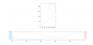

Perhaps just a small round lip would be enough (e.g. to continue a little further at the maximum curvature).
One more -
And what about a circle/torus from the point of highest curvature circling in on the backside of the waveguide?
I have all the math ready:
How do I get this in ath or ABEC3?
Edit: that is exactly what I meant @mabat! I didn't refresh the page before posting this...
How do you calculate the point of max curvature? I can do it only numerically (haven't even tried to solve it analytically).
I have no special powers... I eyeballed it 🙂
I'll see if I can convince (wx)Maxima to find it for us.
Edit:
Nope...
Edit:
Nope...

I managed to add bezier curve for the backside in Desmos but not sure if its any help. https://www.desmos.com/calculator/e2dygvmtlh
Scroll to bottom, few parameters to change the curve.
Basically added this https://www.desmos.com/calculator/lavlfhvstv to your R-OSSE example without knowing much about what am I doing. Idea was to be able to make sure the driver fits in without affecting the waveguide part.
edit. Seeing it there in desmos the transition looks sudden most of the time and probably diffracts. Some eyeballed parameters look nice and smooth though.
Observation on the max curvature thing. On the good waveguides the max curvature seems to happen quite close to the lip and it can be quite tight. If you use the max curvature and stick it there wouldn't it make quick turn around on the lip? Perhaps its fine for optimizers to seek out answers though. Might be hard to determine length of the extra part though? Just thinking out loud.
edit. hey, how about if you check out curvature just on last point (tmax) and use tmax to zone in on the max curvature, until the roundover is nice? Well but again where to end the curve then.. perhaps you are already on to it 🙂
