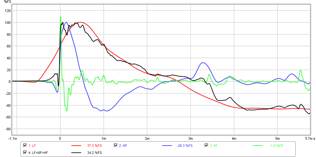

I finally figured out how to plot multiple traces of any parameter ("Overlay" plot feature) 🙂 REW actually is a very nice fully featured plotting package in general. Nice graphs.
Your plots of the different SR's for LF/MF/HF/ALL inspired me. Here is what I have - they sort of resemble what you have.

Thanks the plot later in day after job time will try analyze to see if we can find some clues.
A quick comment when compare to my electric is HF at 110% MF/LF at 100% is good, but sum shall start at 100% make some very steep sawtooth (HF fall off or call it system LP) and then triangle shall first real start at aprox 85% falling off to the right. In sum that we clear can see raw LF hump turn to 100% is a error and points little to errors PLB showed us which was timing offset and amplitude lower down in slopes but its complicated setup we also have a LF and HF that where they meet in air have to cansel to get right slopes to blend with MF. That HF and MF goes too negative by over 40% i don't know but will check tonight mayby its to steep slopes or suddenly slope fall off deep low.

Here what XSim get out of the IR-1 file when asking a 140Hz square wave:
