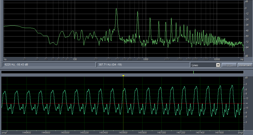

Some humor. Here is waveform of cello playing G on D string with bow and other strings not damped:
Waveform is not unlike square wave with 25% duty cycle. Recording played through most speakers sounds like cello recording played through a speaker. When played through coherent speaker it sounds like cello.
Recording was made by me in living room with microphone at about 1 meter.

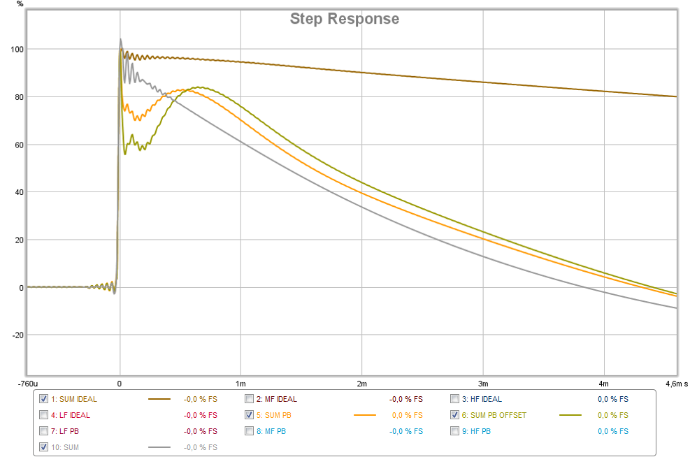

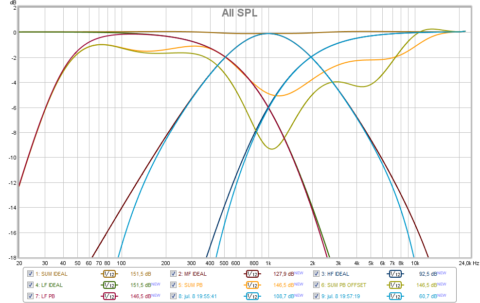

Thanks for looking into this. So is the LR2-BW1-LR2 the simplest way to get a response that sums flat and has decent cone control for woofer and tweeter?
Hi xrk971,
Attached are my simulations using idealized drivers mounted on an infinite baffle, plus a sim with each driver having a limited bandwidth of 2 decades in frequency and including appropriate acoustic offsets.
Hopefully, there is enough data defined in the block diagram for you to understand the basis of the simulations, but feel free to ask for more info if anything is unclear.
Hope this is of some help.
Peter
Peter

PLB,
Thanks for doing this! I am trying to figure out what you did. There are two systems, the first being LR2-BW1-LR2 at 0.5 overlap, and the second is LR2-LR2-LR2 at 0.71 overlap?
So based on the shape of the response that I have, it looks like it is acoustically, LR2 all around, given the peak on leading edge followed by dip and rise? Is that what your sim is trying to show?

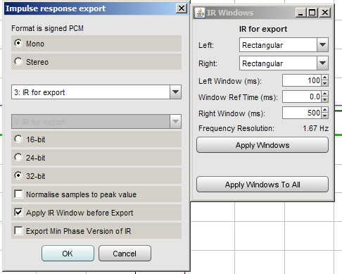

PLB,
Thanks the documentation its nice made.
Did copy your setup by looping back a USB soundcard at 16bit/48kHz thru JRiver DSP engine with same filters plus delay setup and listening in loop with REW. Below is REW plot and added the orange which is error still present even drivers are aligned but bandwidth limited.
xrk971,
Think PLB try to point out if the electric XO slopes are connected perfect ideal drivers DC-infinite bandwidth system sum are perfect. Then when he use same electric XO slopes at real bandwidth limited bandpass drivers, a 40-4kHz LF, a 100-10kHz MF and a 4kHz-40kHz HF and at same put the acoustic offset error in by a 0,1mS LF delay and a 0,03mS MF delay then system sum is full of errors, and mayby its more the SR error he want to point out looks some ala yours. The below SR plot is a REW copy of that PLB did, brown is perfect system with infinite bandwidth, grey i added and is a 40-22kHz system (X's OB) with no errors for bandwith or offset, orange i also added and is the bandwidth limited drivers, and gold is the bandwidth limited drivers plus their acoustic offset errors.
So it's simple X : )
First get the drivers to perform their slopes acoustic, but important its also done below -20dB and down deep.
Second get acoustic offset callibrated 100%.
Third get their SPL sum calibrated 100%.
Fourth enjoy square waves and music....🙂
Fifth really easyer said that done 🙁

Byrtt,
Thanks for the explanation. That is neat to do it with real audio signals loop back thru sound card. That is real data we are looking at and not just theory. As you say, it is simple but hard in practice. This may explain why Dunlavy used 1st order electrical, to arrive as 2nd order acoustically.
