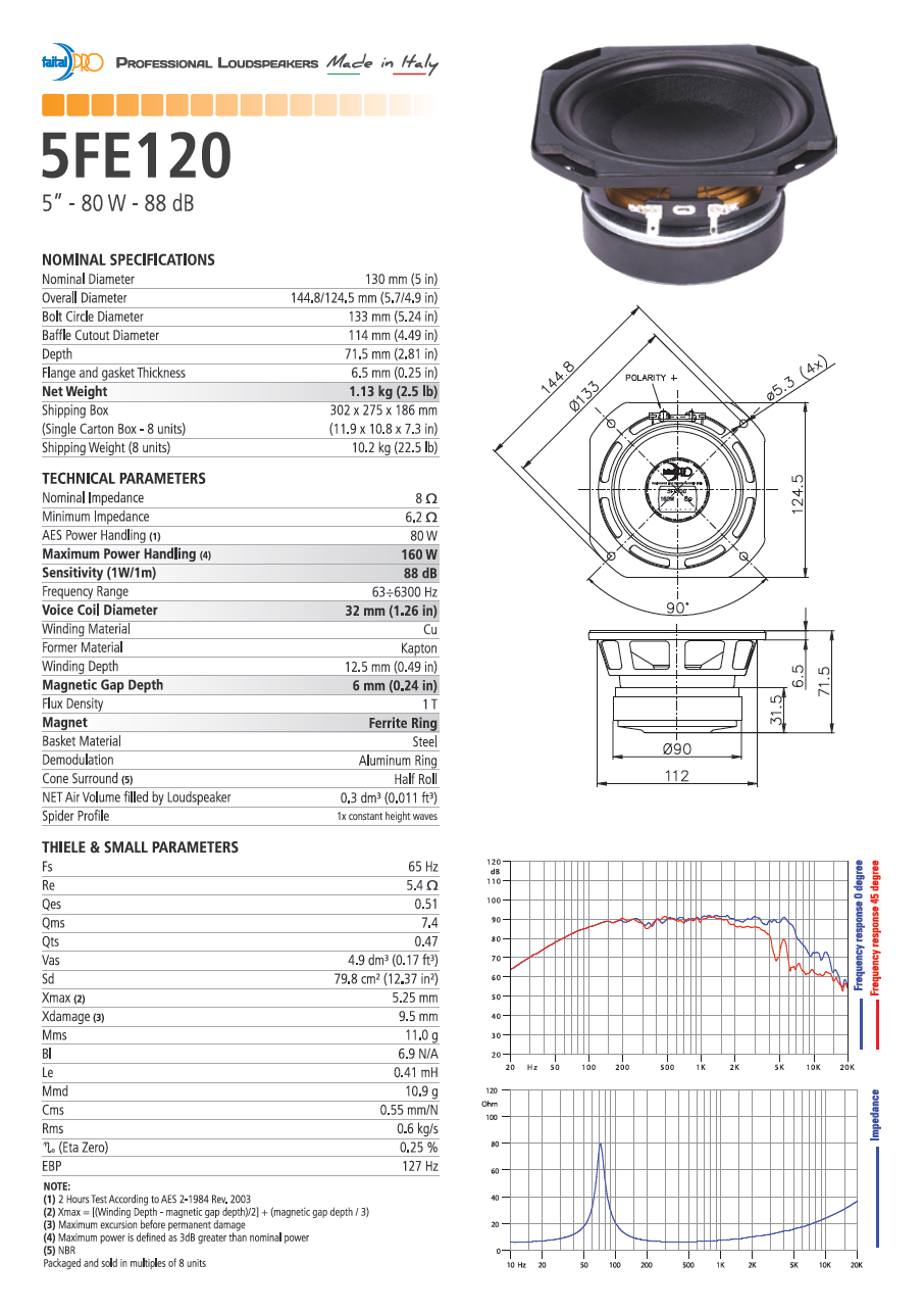

10F as the tweeter is what I'm reading there, Faital Pro as the mid filler.
Ok, so the 10F is a tweeter with super wide bandwidth, and the 5FE120 is a mid with super wide bandwidth and reaching into the bass, thus easier to get textbook slopes on all drivers.
Coincidentally, it turns out that the woofer from a coax is in general, designed to have pretty wide bandwidth to start with in order to xo with a CD around 2.5kHz. So I lucked out in that regard by using it an octave below its usual XO point.
That 5FE120 looks pretty nice. Hmm... I like the XT25 too - both about the same price.

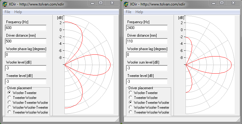

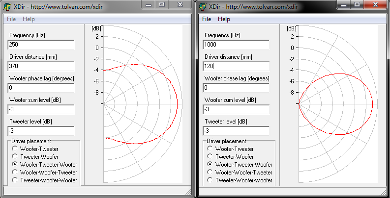

Thought was for that 10F / 5FE120 / Beta12cx combination Fx 500Hz with gamma 1,0 in WMTMW config.
Then it gets longhaired because the left one says 250Hz which is the real acoustic XO point between the LF and MF and right one says 1000Hz which is the real acoustic XO point between the MF and HF where center for filler is 500Hz.
Thanks.
How ugly is it with my current MTMWW setup as described on post #1 with Fx of 1200Hz?
Thanks.

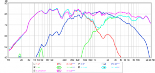

Its actual the first picture in post 112 set at 600/2400Hz acoustic, for the CTC distances took a guess and must be close enough. Think the LSR305 monitor you tested some time ago would have vertical lobe mid between the two shown at post 112. Having transient perfect acoustic lobe think will pay back when wide as possible versus horizont dispersion to battle it not just happens at one point in space.

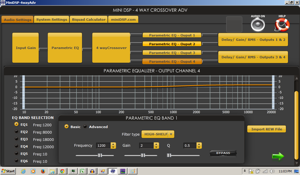

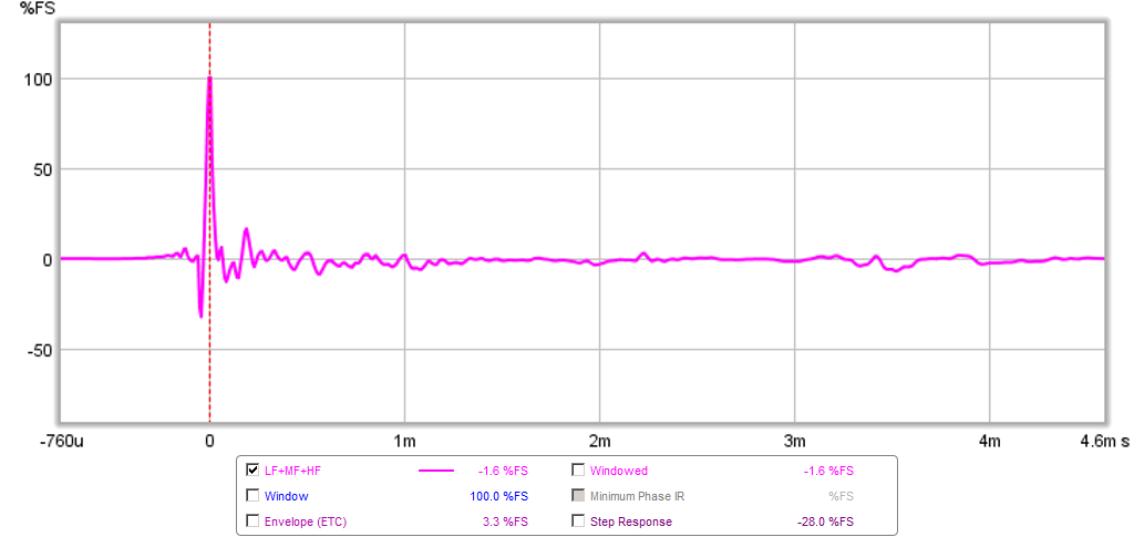

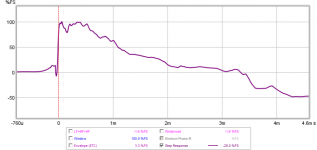

Well, I tried to figure out how to improve the step response. I have a sharp peak followed by a dip then the ramp. Changing the time delays did not help, and by looking at the SR from just the mid and tweeter, I could see the problem was that there was excessive ringing in the HF that was causing the dip. Removing the two PEQ's in the tweeter made the SR much better. The Frequency response of the tweeter is not as smooth now and has a downward tilt. But I could not hear the difference really in the lack of highs. The subjective sound overall though was improved as it sounded even more cohesive now. The guitar on SRV's Tin Pan Alley sounds especially good.
Here is the HF PEQ diagram - just a mild high shelf is left:
Here are the measured acoustic XO and response curves:
Here is the measured impulse response, note the reduction in ringing:
Here is the measured step response:

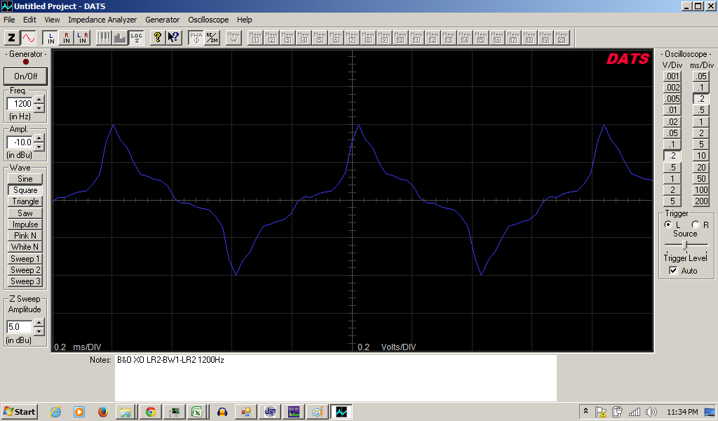

However, I tried the square wave at 1200Hz and it is not working out. Looks more like a triangle wave. Is this indicative of bad time alignment still? What am I doing wrong that it is not even close?

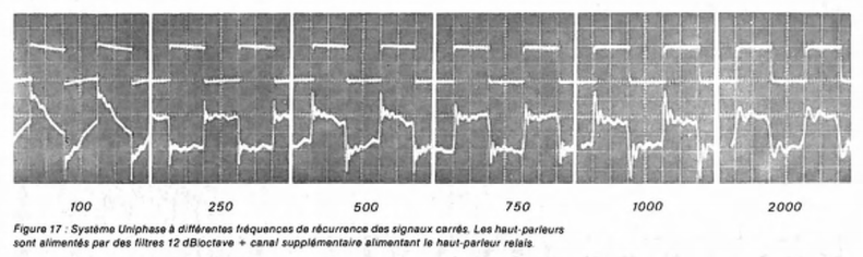

Well think you on the road below is the old B&O review linked to at post 70.
Your 1200Hz is much looking like the 100Hz there, isn't this figure indicative we have more HP filter function than we liked to : )
Thats quite strange because the step response indicates that it should be at least as good as the B&O example.
Can you do the same measurement outside ? As BYRTT indicates it looks as if we have a highpass function somewhere. But maybe it is something else like a superposition with delayed sound that is causing it.
