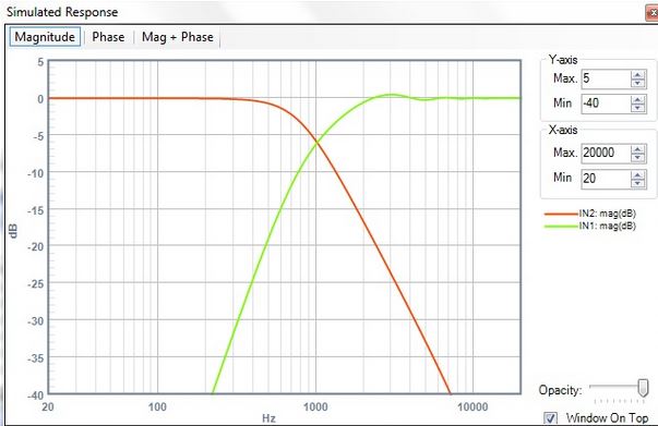

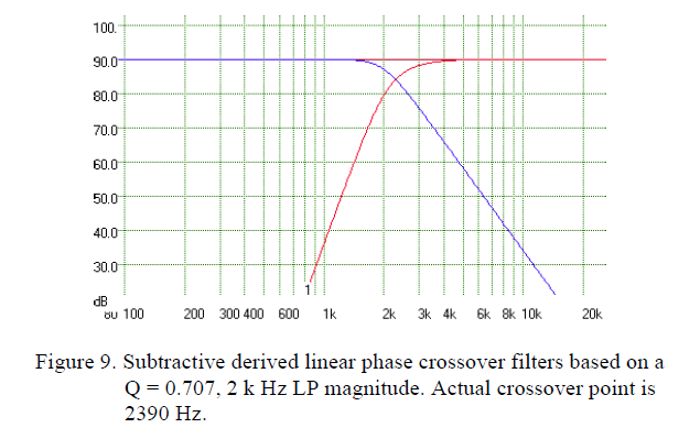

Subtractive-delay (Lipshitz-Vanderkooy) for instance. But I don't know whether the GUI of the Mini DSP does support it.
With sigma-studio for instance it is almost a child's play, apart form the bug that I reported in this thread:
https://ez.analog.com/message/31313
You can see one example if you scroll down a little that was done by subtracting a 2nd order BW lowpass from a pure delay. This ends up in a 3rd order highpass and an overall linear phase.
As always one does of course need to know how to include the driver's natural response.

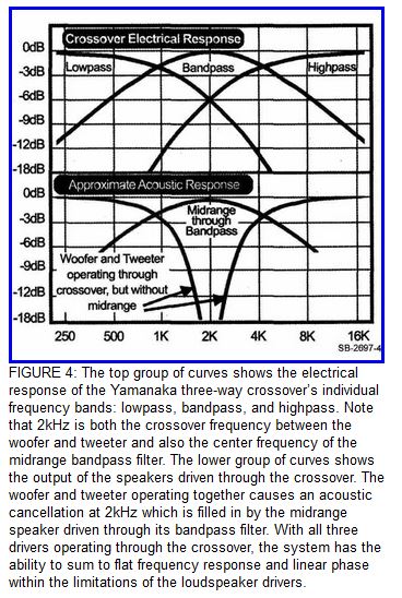

The following is in french, but there are a lot of figures which may help you :
it is a part of JM Plantefève's site.
2A & DIY
There are many interesting links in the text.
According to an article of AudioXpress, january 2007,
the inventor of the filler configuration was Yamanaka :
A Unique Loudspeaker Crossover Design with Waveform Fidelity
2A & DIY

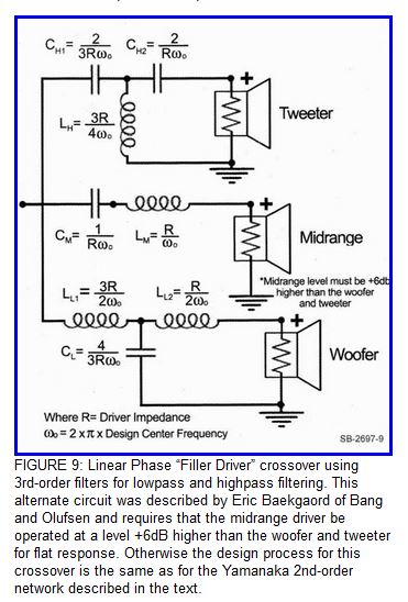

@ forr
Thanx for the gammaelectronics link
I noticed a relationship between the xover values of FIGURE 2. The values for the filler components are almost a factor of four different. C = X 4 & L = 1/4

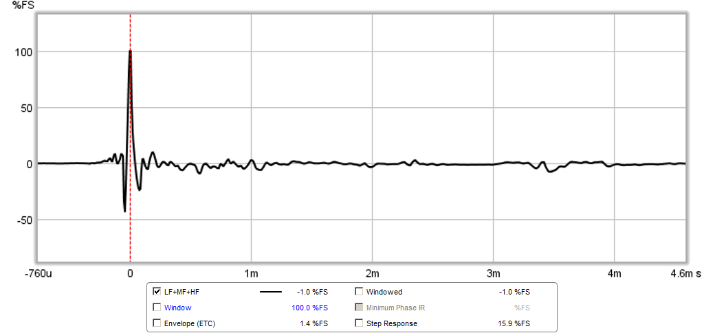

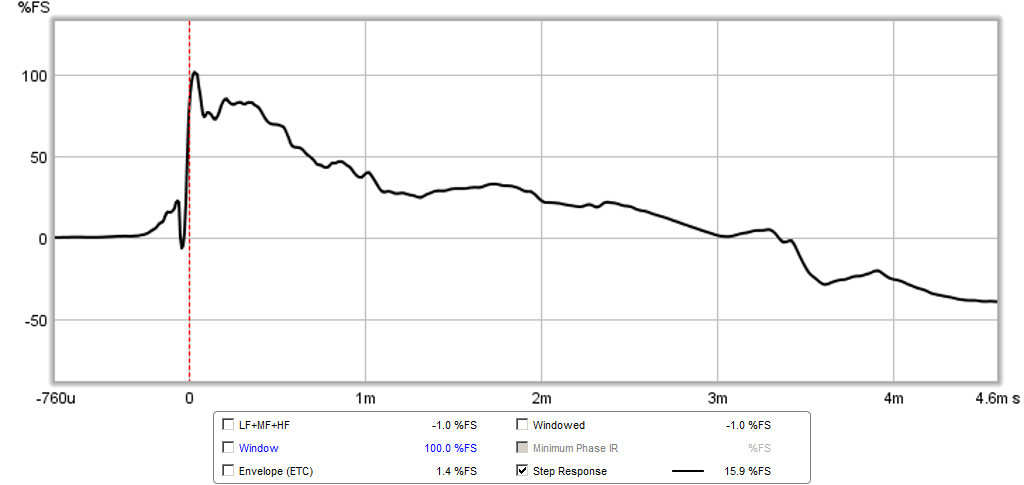

Success!
I was a bone head... I thought the filler was supposed to be negative phase... 🙂

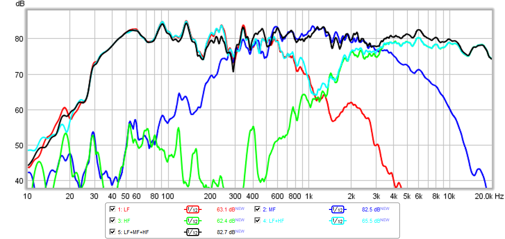

After reading some more of the writings carefully I saw that the filler mid is supposed to be IN-PHASE with the woofer and tweeter. Looking at its SR, it was upside down and that should have given me a clue.
Anyhow, I went back to the non-shaped response, from the first simple LR2-LR2-LR2 xo, and made the mid BW1 and in phase, and what do we get after some very minor delay adjustments? A SR that closely approximates a right triangle. The IR also looks very good. Thus it was not as complicated as I made it out to be. Doesn't seem to require exact textbook acoustic slopes of LR2, BW1, just setting them electrically worked because they are steeper than second and first order once the electrical and natural response were added.
Acoustic XO measured from 1 meter away (ignore LF stuff as HVAC noise was on):
IR:
SR:
Still listening to test tracks now, but so far so good. Very good sound with realistic percussion, piano, guitar, drums, all have that tight time alignment of sharp edge with a smooth follow through.
IR:
SR:
Nice! BYRTT tried to tell you 😉:
Doesn't matter, these things happen right? With all the speakers on your plate it isn't that difficult to overlook something like that.
Looks very good so far... that's a good start I'd say. The theory works well.
Sorry get confused the flip phase talk and where we are, but can we agree LF/MF/HF sections shall be wired in same normal polarity and therefor if one runs LR2 at 1200Hz for LF and HF section and we disconnect MF we get a normal 2 way system but with a deep suchout because phase 180º apart and should be, points for MF then be 600Hz BW1 HP and 2400Hz BW1 LP filters to form band pass.
That's why I said I was a bone head. Byrtt is really good at catching these things.

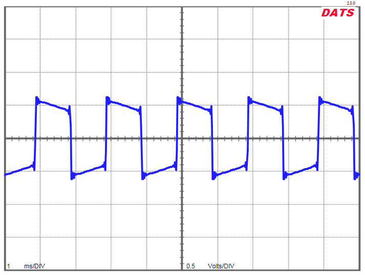

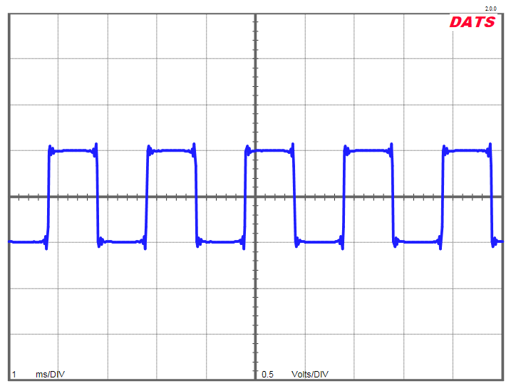

Now as we discovered DATS software have that nice signal generator and Oscilloscope (set scope to single channel up in left corner), will you at some time share OB setup SQ waves. Below is some data other SQ wave to live up to.
Picture below is DATS software 500Hz SQ-wave performance run thru XO filter with LR2 center at 1200Hz and BW1 filler at 600/2400Hz bandpass, without real drivers but pure electric summing, first is without a system bandpass set and second have system bandpass set at 40/22.000Hz BW2 slopes.
In post 70 member forr (thanks links) pointed to a nice French site and at that found this link to SQ wave performance for a B&O speaker back in 1976.
Link: https://docs.google.com/open?id=0BwTS40IaQa16ckdKOVEtQ2xSOUNoR2JhOGV4TVFjdw.

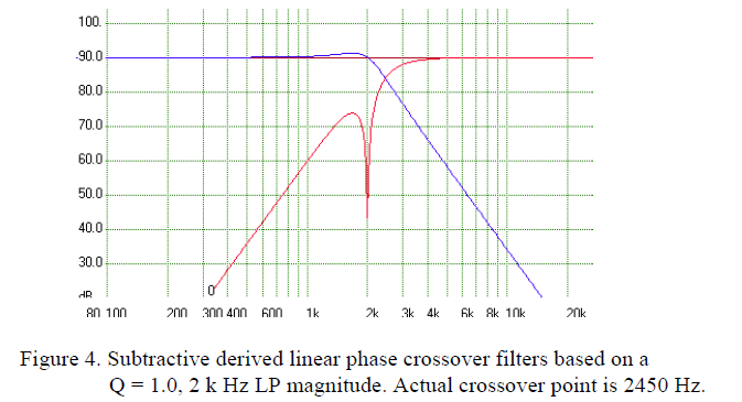

Here's some 2 and 3 way stuff by John Kreskovsky and Yamanaka and B&O.
A lot of this stuff seems to work with time aligned series filters very well. Especially Bud Fried's style. Which is a bit off-topic but something I play with a lot. Put a +3db bump time aligned design on a flat baffle and it turns into a flatter butterworth.
So this is just to enjoy really. John's subtractive filter with the deep tweeter notch is most surprising. Who'd have thought of trying that? 😀
