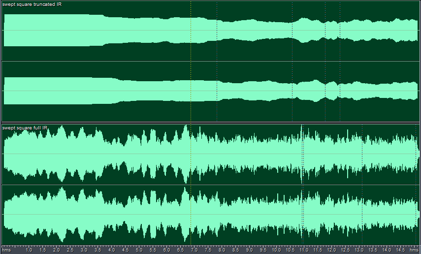

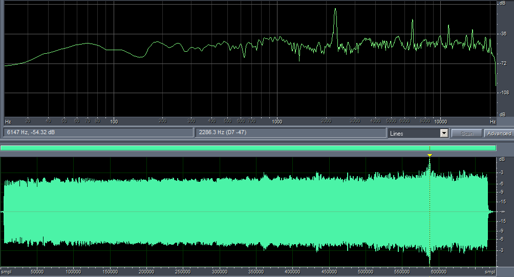

Co-opting REW impulse response import for alternative purposes is a great technique; and I am not first to use it for looking at square wave results. Use of swept square wave allows poking about to see how waveform envelope changes with frequency for a given measurement setup. With experience (endless practice and goofing around) it is possible to use repertoire of software arsenal to decompose the square wave and look at specific amplitude and phase of component sine waves; useful in tweaking filters and alignment. Sure, a single base frequency square wave may be used, but always leads to checking elsewhere in spectrum in making useful assessments.
When approached as speaker alignment tools such techniques help make minutia that are difficult to interpret from IR and step response stand out.
Here are overviews of 50Hz-4kHz swept square response of R-1 and R-2 with long and short windows of the impulse responses:
The comparison makes it easy to see that room influence under measurement conditions as direct to reflected ratio require judicious use of windows to get valid and useful results for analysis and interpretation.
You initial posted square wave response is prime example; step response tells you that system should be capable of good square wave response, but that without experiences like this you would be blasting away lots of effort.
Here is example of predicted square wave response of my TC9FD FAST project using full IR of measured system; I already know that the conditions of reference measurements involve compromises that lead to fluky behavior do to room interaction because part of investigative intent is use/study of frequency dependent windowing with DRC package to get cleaner correction filters. Reference filters applied give natural amplitude behavior of system high pass, but are linear phase. Path is open to substitute IIR type high pass behavior and see how it alters system coherence:
Above an incredibly flat amplitude response is seen with a bit of concentrated peaking and dipping, overall zooming in shows quality square waves from 50Hz to 4kHz. At biggest peak in 2kHz region square wave response is badly messed up. By relatively small changes in microphone position relative to speaker, and small transposition of speaker/microphone combination within room it will be easy to see what is room effect, what is measurement distance/speaker design effect.
Here with digital tools you've recreated a great IIR based response built upon knowledge capitalizing on limited bandwidth of typical drivers of yesteryear. Many of today's drivers have much wider useful bandwidth, and sculpting acoustic response leads to ringing in frequency domain, this is arena of Bessel functions. Likelihood is appropriate dash of Bessel function that have appropriate counter ripple in frequency domain may lead to better result overall. Danley seems to do good with Bessel type functions with SH50 and other of his designs.

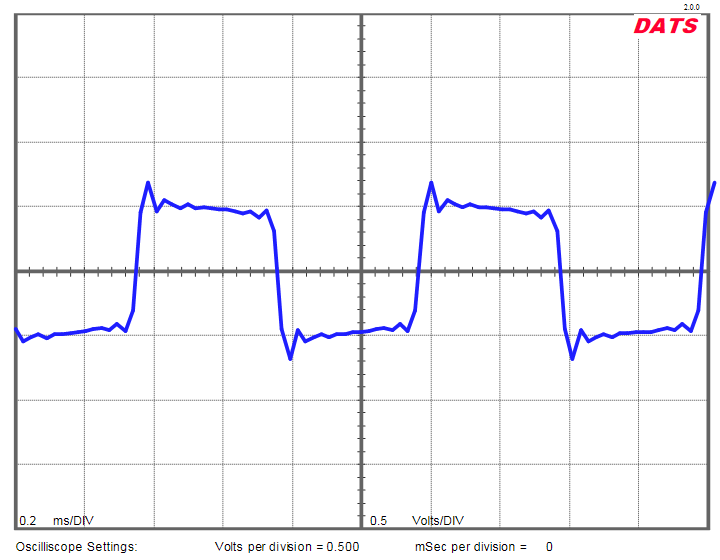

Thanks for the explanation above, and for tips on how to use REW for extra stuff like this. What software is that you are using with the above time trace on the bottom and specrtrum on top?

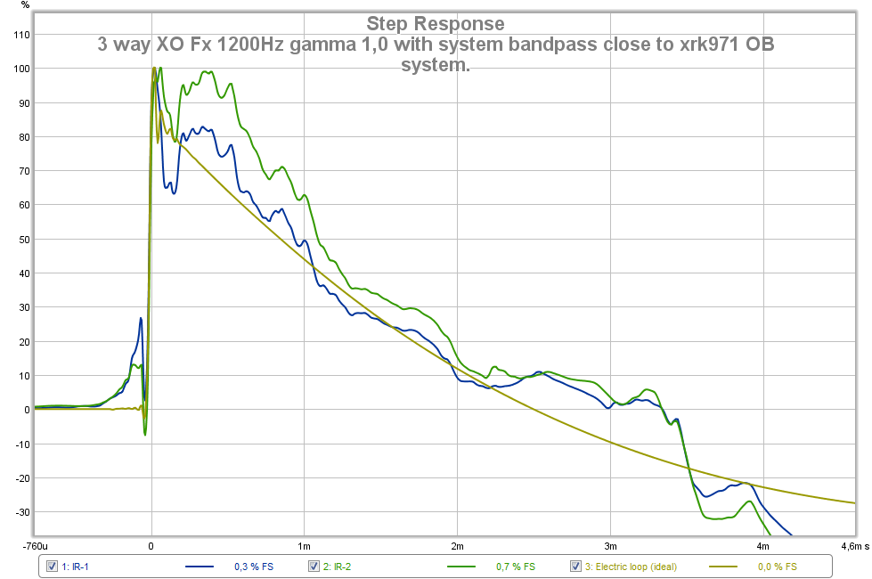

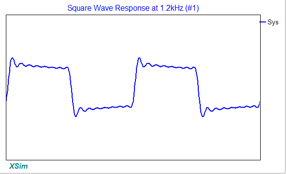

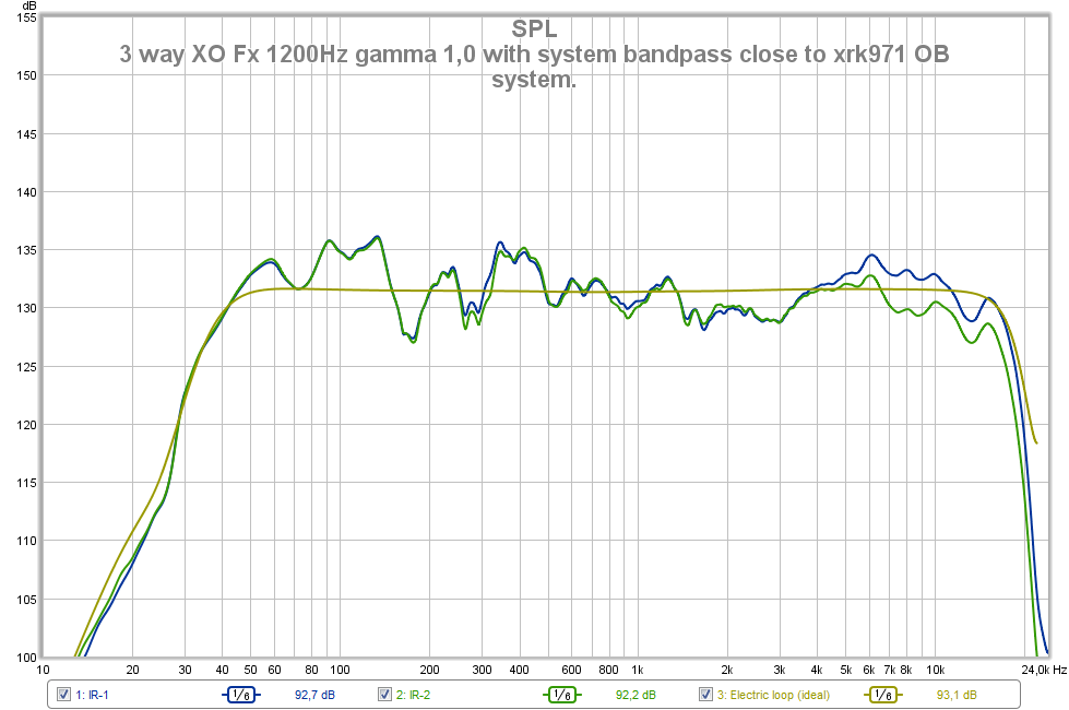

Now that you shared the two IR-wav files did set up the 3 way electric XO copy of your OB and modified it to hit same system band pass cut offs, to use as tool to see if we could find errors leading to improvements, but after Barleywaters great posts i realize no need to do more by now other than we need to send some workers in to modify your lab room to be real anechoic : )
Now they were done attach below if any interested see a slope that would be nice to have acoustic, including a test to see if DATS real live measurement and imported frd file to XSim agree for a 1200Hz tone when the electric filter is looped through.

Thanks for doing that. What is the difference between the DATS square wave and the one in xsim? Did you remove room reflections on both? It's amazing what you guys can do with an impulse response measurement.

Mayby i was short when posting, that square wave belong the more perfect electric filter gold trace in plot. Just liked to see precision and reliability the two compared, DATS software via soundcard listen live in loop and the other where REW measurement is exported to XSim as frd file which probably sweep upon FR and associated phase track data.
At present can't do the magic as Barleywater Gmad and wesayso are able to but they very kindly share and hint us down the road so we just need to get finger out of behind if we can find the time. Think i had succeeded getting into operate RePhase and that is gold for a 2 way when XO is higher order than BW1.
