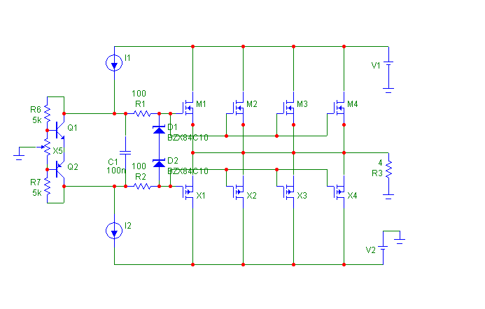

I hope images would say more than words. 50 amperes per device, exactly as said by BV. Models are 240 nad 9240.

Current 'limitation' of the Federmann's output stage, load 0.25 ohm :
It is the same output stage, same 'protection' by 10V zeners. Wire from midpoint of zeners already added, regardless that there is no current limitation in any safe area.
Why you do not read text and write what the text is not?

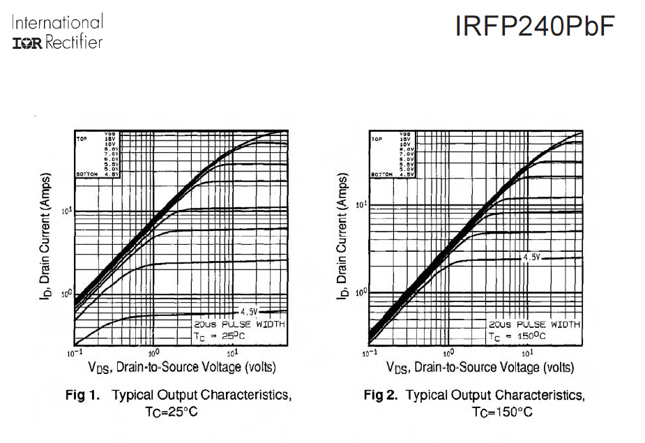

Here is why it will not work well without source resistors. Let's look at Vgs = 4.5V and Vds > 10V. In that case, the drain current is:
For temperature = 25 Celsius, it is Ids = 0.6A.
For temperature = 150 Celsius, it is Ids = 25A.
That is not a reduction in current with increased temperature!
All the parallelled transistors have the same Vgs so the hottest one will work harder than the others. Drawing a load line and pointing at it is nonsense. It is current sharing that is the problem, nothing to do with the load line.
However, the BUZ9** transistors you mention on your page do not have this problem. They can be parallelled just fine without resistors.
