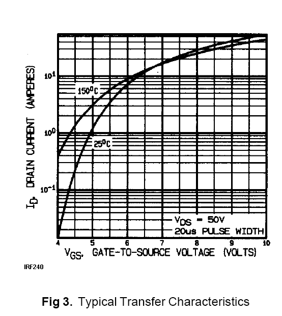

Power MOSFET is made up of many cells (transistors), 100thousand and more. As the power MOSFET is heated by power dissipation, its RDS (on) increases. It is important to select the correct voltage MOSFET. I know that no one applied, but I do.
Have a nice day.
I know that you care, but the emitter resistors are important, where the temperature coefficient is negative. Here is a positive temperature coefficient resistors, and thermal stability will deteriorate.
Transistors so selected to have the same characteristics, only those transistors can be used.
As transistors have the same characteristics, sweeping the input voltage, I reach the current limit.
I know that I did not say anything, so your decision is wrong, diodes D101 and D102 serve as current protection.

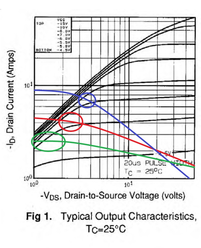

Figure II-3: Visual Image of the IRF1405Z failure. This type of visual
pattern is more attractive when observed on the surface of the moon,
instead of on the surface of parts that are trying to land there.

just of curiosity can you tell us what is the current through transistors T107 and T108?
And what are the resistor values of R114 and R115?
Thank you!

I am looking carefully, Ids for Vgs 10V (limit by Zener diode) and Vds 40V is more than 40A. It is visible in posted graph (second curve from top). This are conditions with shorted output. With Vds 40Vx40A= 1600W to dissipate for one mosfet.. Nice firework.
