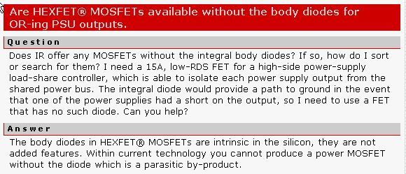

FET intrinsic diode, aka. "body diode"
I took intrinsic to mean part of the FET structure (like in a JFET (drain or source to gate)), not added on. Your not actually blowing the fet but the diode.

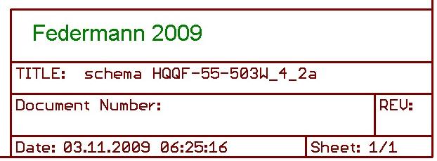

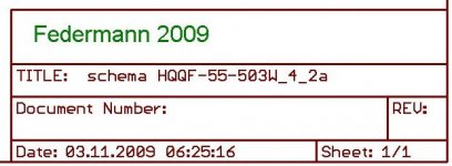

It's true, Federmann changed the drawing in post #1, magnify his picture and we can see the schematics is done on 3rd of November while the post/thread started on 29th of September. PMA has the initial drawing that dates back in early September: http://www.diyaudio.com/forums/solid-state/154104-topology-federmann-hqqf-55-a-2.html#post1966770
I changed the scheme to be correct, that some confused. There is an old scheme in MC.
