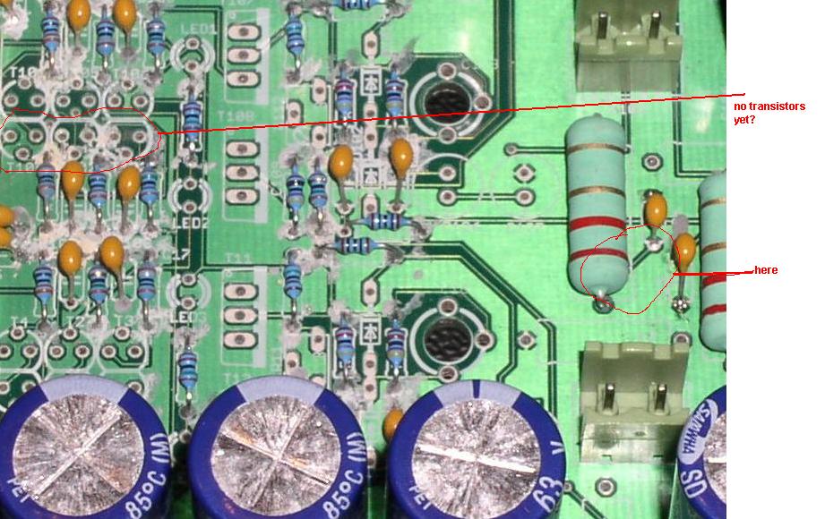

I circled the track that Pavel is speaking about.
BTW - this circuit has probably never worked yet, I can see that transistors have not been inserted and soldered yet - circled as well.

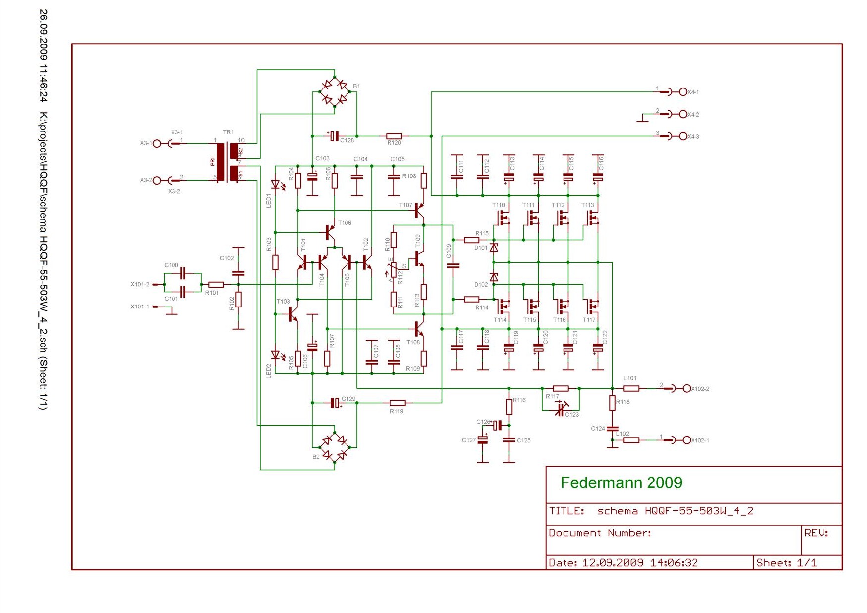

It has nothing to do with realistic construction. See e.g. for output inductors, dimensions and supposed type...DC blocking - ceramic capacitors (suplly voltage?),conected together with thick, long line, Boucherot cell too.
Is not a supporter of THD measurement range, in my opinion is not sufficiently informative about the properties of amplifiers. I we will wait until everything is ready and will be measuring and listening tests.

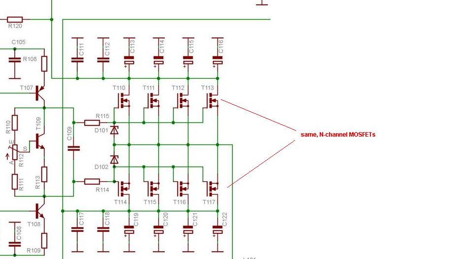

I am also very curious to understand how your novel output stage works. It uses only N-channel MOSFETs in both push-pull halves :
