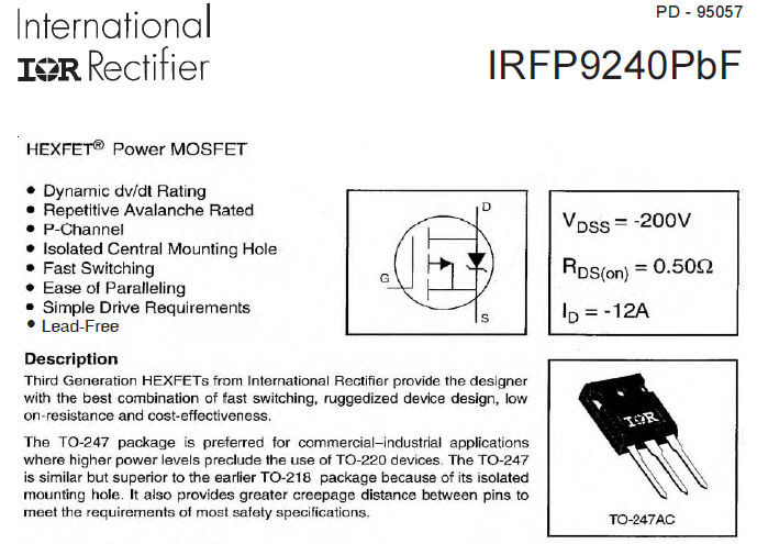

Most signal J-Fets can have their D and S leads interchanged and the device will still work. Some types are dissimilar and will not work as well, but they will still work. This wouldn't be true is there was an intrinsic diode. Dual J-Fet chips are reverse P-N junction isolated (that forms an SCR) that may cause trouble if the right voltages occur between the substrate and other leads. May be you are thinking of this?

If you look at the schematics in post #1 you will see both N and P devices.
I think he explained somewhere that it was the program he used that did the mistake.
Anyway I’m concerned about the lack of a lot of resistors in the OP stage, so if Federmann could contribute about that it would be nice.

Power MOSFET is made up of many cells (transistors), 100tisíc and more. As the power MOSFET is heated by power dissipation, its RDS (on) increases. It is important to select the correct voltage MOSFET. I know that no one applied, but I do.

I took intrinsic to mean part of the FET structure (like in a JFET (drain or source to gate)), not added on. Your not actually blowing the fet but the diode.

I have the same concerns over a lack of source resistors. I did warranty work for a company that didn't use them either. Not a successful way to produce a product, and the output matching was too tight for production. I needed 40 parts to select 4 that were close enough. That's per polarity!

- this simulation with paralelled MOSFET output devices does not use individual gate stoppers and does not use source resistors. We are persuaded by the author that it is OK

Regarding base stoppers and source resistors, I say that only a working sample of this 2 x 500W amplifier can convince me that it is OK.
