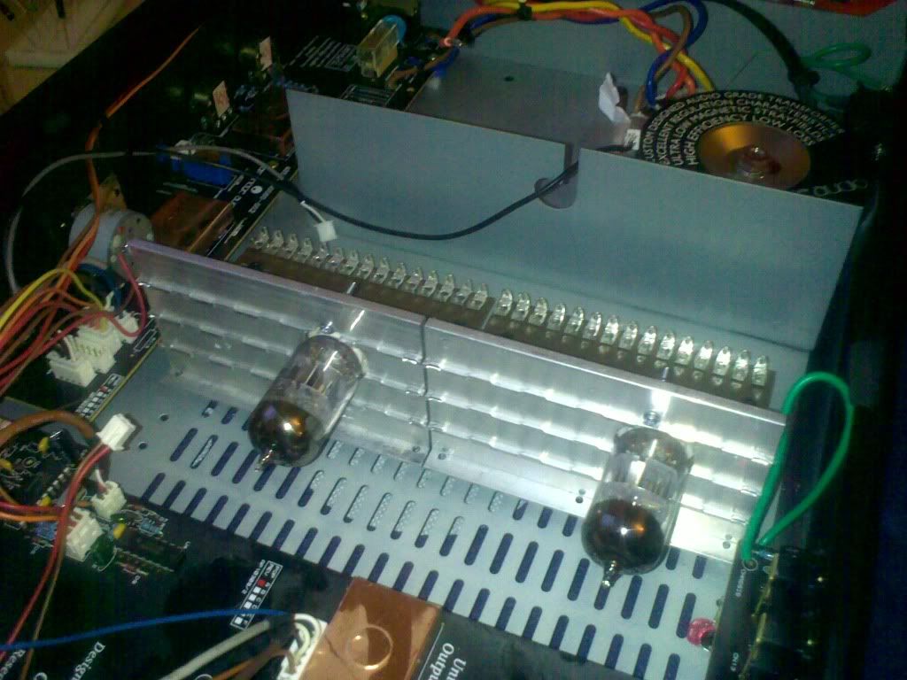

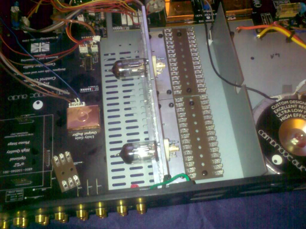

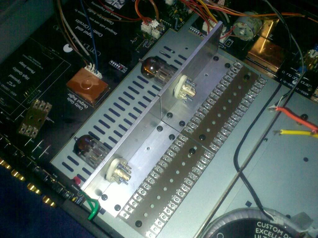

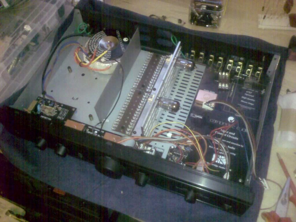

Mounted the valves and some lengths of Tag board into the chasis; my metal-work leaves a bit to be desired but as long as you dont look to close it's all looking good; I particually like the way the Tagboard screwed streight into the upstands left by the old Power Amp board and the valves lign up perfectly with the venting on the lid and base of the chassis:
