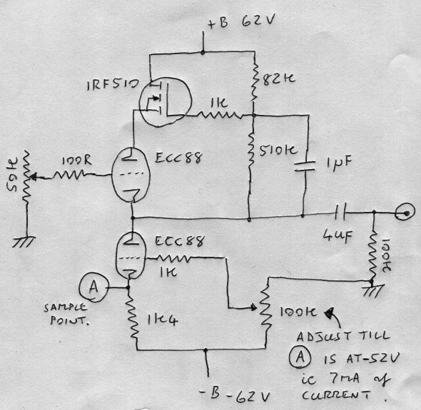

I've just be wondering while i'm building, how could this circuit be modified to drive more than one Amplifier? I was thinking of Bi-Amping at some point and also adding a stand alone headphone amp.
Can I just decouple a second output?

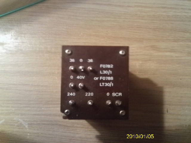

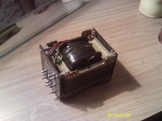

I have this transformer.
Not sure if you can see the details, this camera is rubbish:(. It has 36,0,36V and 0,40V secondaries. Its 68mm high on its side. I would say its 50-60VA. You can have it for postage if you would like it. Although I think it may be a bit low on voltage for you.
Other than that with your 70mm height you could use 2 or even four transformers to get the required voltage. Or a toroid, this does have the advantage of being able to add the heater windings without too much trouble.

I'm Starting to think about the Rectifying circuit, I'll upgrade this over time towards the Eli Duttman design;
For the MK1 do you think I should go with just Capacitance or a CRC circuit?
