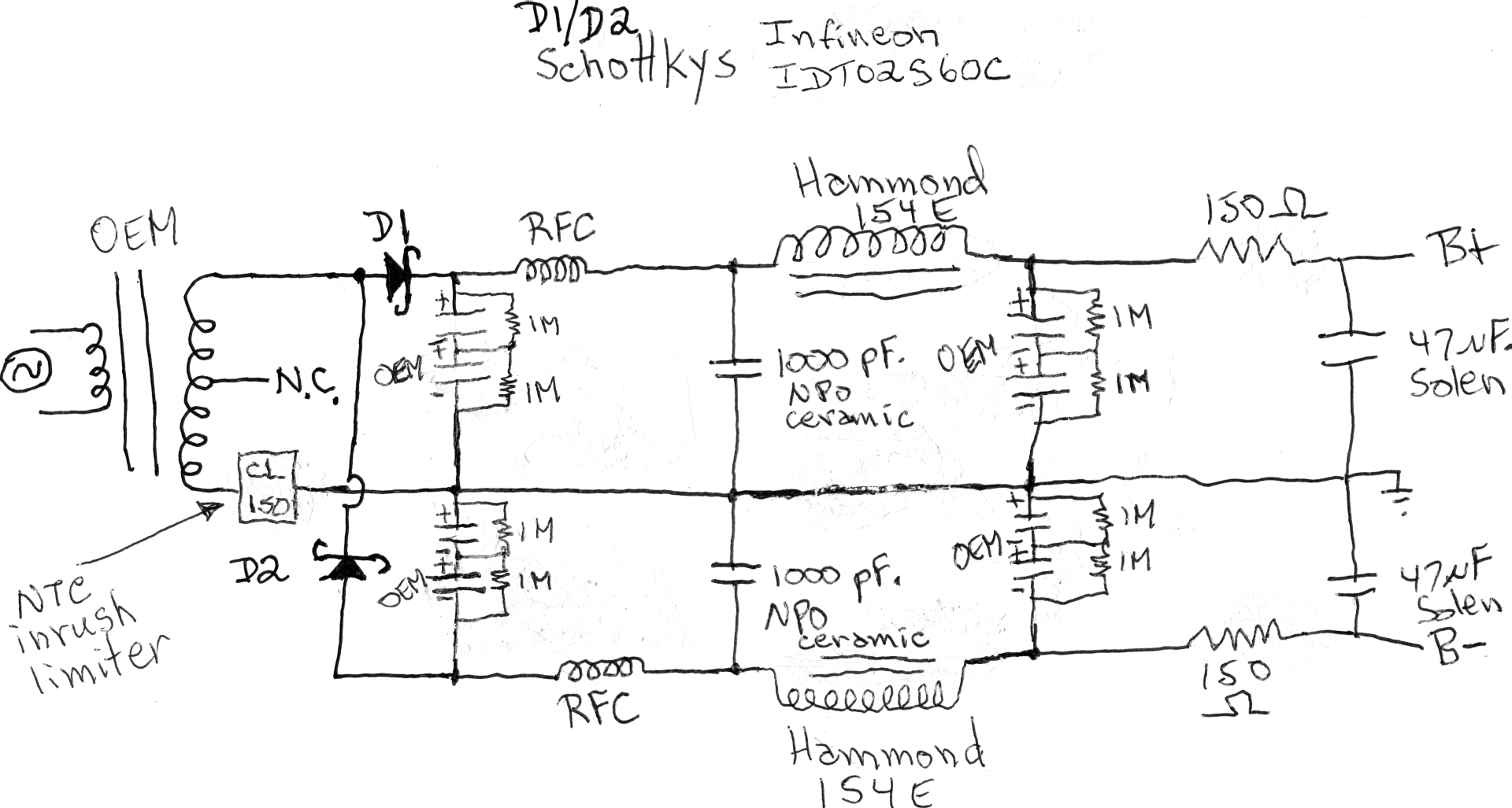

So your saying if I remove the ctr tapping from the transformer, the bridge will see two half wave 100v supplies which it will rectify to 100-0-100! Genius.JBS,
To get "100"-0-"100", the rectifier winding's CT is tied off and back to back half wave supplies are employed. Because the power trafo is comparatively huge, the large 1st filter caps. needed are not problematic. AAMOF, the arrangement works quite well. Both halves of the AC cycle are passed by diodes and no "standing" DC is presented to the power trafo.
Large 1st filter caps. come with their own set of baggage. Implicit in the tiny conduction angle is a very sharp triangular ripple waveform. Fourier's theorem tells that sharp periodic waveforms contain lots of ripple overtone components. Those overtones extend up well into RF. Immediately following the 1st filter cap. of each rail (B+/B-) is a "hash" filter made from a RF choke and a 1000 pF. NPO ceramic capacitor. A "hash" filter "dulls" the ripple waveform to the point a "classic" LC section can finish things up. The many turns of wire in PSU filter chokes create enough capacitance to short the choke out a high frequencies. It's not a problem if RF energy has been killed off before the "juice" arrives at the high inductance choke.

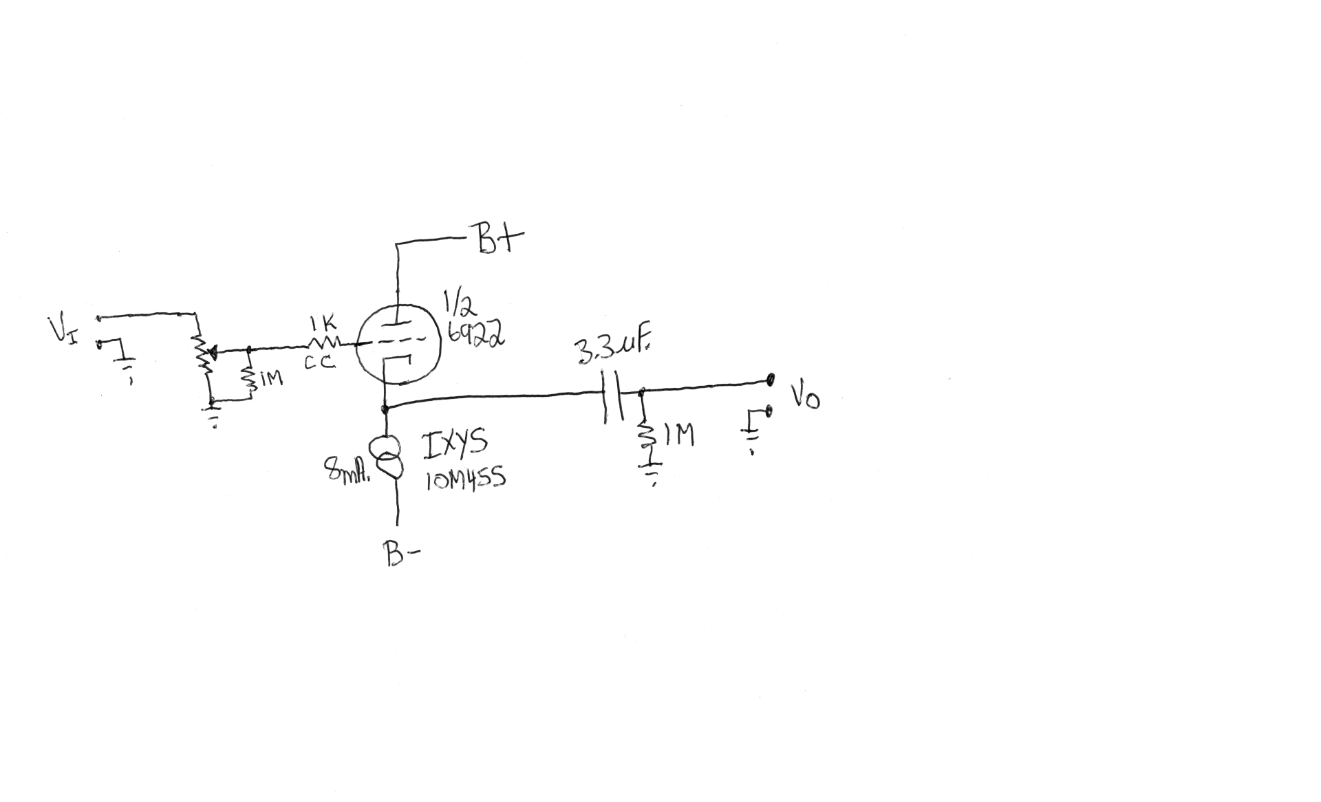

JLTi MK2 is a simplified Schematic Diagram:
This doesn't have component values, but they are fairly easy to work out. It is the best cathode follower because it removes the degenerative feedback. I built a version - but used a MOSFET at the top which simplifies the design slightly.

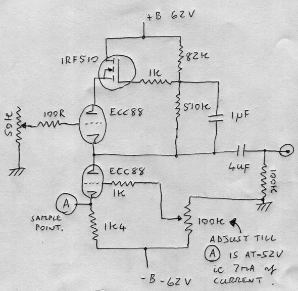

Here is my suggested SLCF unity gain preamp. I have assumed that the rails will pan out at +/-62V (45VAC*1.414).
The Bottom triode works as a CCS, since a triode makes a fairly poor CCS, I have introduced a positive element to the grid bias to allow for a bigger cathode resistor and hence a stiffer CCS. The top Mosfet sample the output and pushes down on the triode such that the plate voltage of the central triode stays constant. This gives the middle triode a Constant Current, Constant Voltage environment which will allow it to sing.
It should work with almost any equal voltage rails, but would benefit from a bit of adjustment if the rails are markedly different.

Negative! Bridge rectifying the entire power trafo winding yields a single rail. You get to recycle the power trafo and the 'lytics. Refer to the schematic I've uploaded. While it is possible to reuse the 1N5402 diodes, I would NOT. Those parts are very noisy, while the Schottkys I suggest are dead quiet. As they are very much in the signal path, metalized polypropylene dielectric in the last filter section is quite important.
I also suggest a comparatively simple signal topology. Constant current sink (CCS) loaded cathode followers are highly competent. While I'm not heaping scorn on the other suggestions, KISS is a good rule to follow, especially in a 1st "hollow state" project.

You can run the buffer at whatever current you like, but I have found that 7mA is a nice compromise between sound weight and tube life. You could adjust it up to about 12mA and the circuit should all just fall into line. Infact this adjustment allows you to tune the circuit to taste.
The voltages as drawn should be about 10V across the top MOSFET, 10V to the bottom tube triode. The grid on the bottom tube will settle to about 1V less than the cathode. All voltages should fall into line as if by magic.
I would get hold of a bit of perferated board for mounting the MOSFETS on, if you try doing them point to point and leave them hanging - chances are that in the future you will smoke them with a short. Buy at least two spare MOSFETs for when you smoke the first (and second), and remember that they are static sensitive so earth yourself before handling. All other connections can and should be made point to point onto the pins. Draw a plan of the pins and sketch out where everything will go before picking up the soldering iron.
I wouldn't go overboard on the power supply - try it fairly much as is before doing any serious modifications. I generally mount a 0.1uf cap across the diodes for snubbering, and also a 0.1uf across the secondaries to damp potential ringing in the transformer. If the last cap is an electro, mount a film cap across it. I generally use better quality rectifiers, but don't feel it is ultimately that critical if attention is payed to damping and snubbering. I also like to put a bit of resistance after the rectifiers(up to 1000R) to slow the inrush current and smooth those rectification spikes.

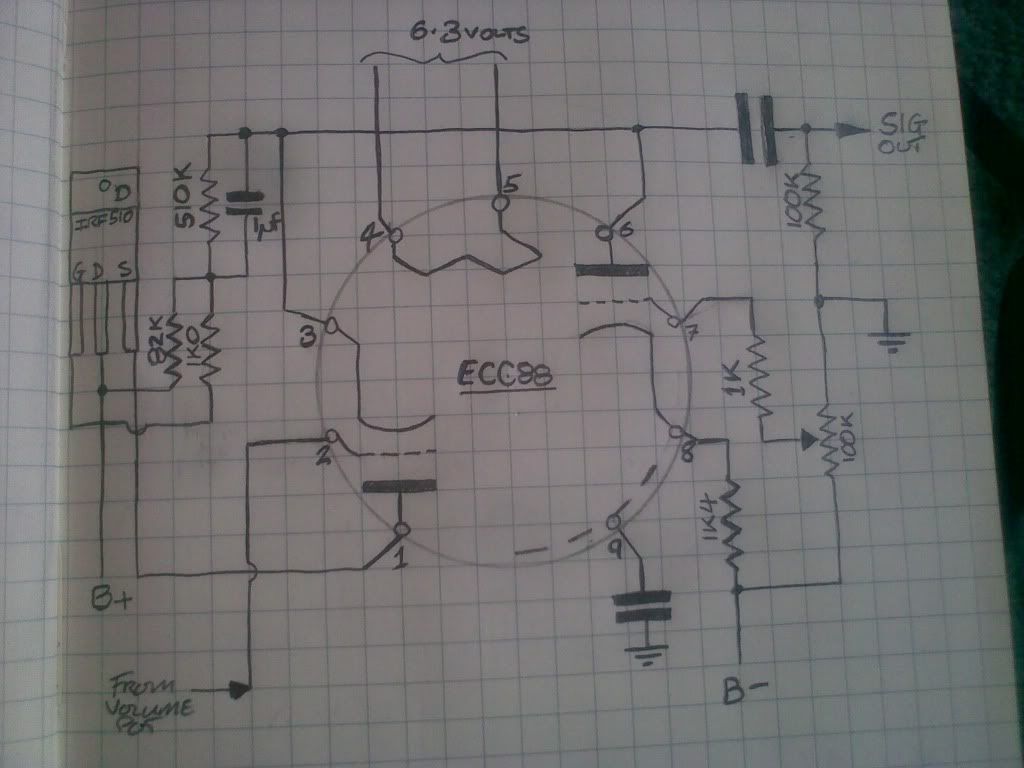

The existing volume/balance arangement is:
its a bit different to your 50k Pot, Do I need to adjust anything, or should it work as is? I dont think I've ever used a balance pot outside of the car, so loosing that would be no great shakes, but nice to have all the knobs doing somthing if poss.
One thing to pay attention to is which valve you use for top and bottom. An examination of the datasheet will indicate which one is meant to go on the bottom and which on the top.
Use your center pin as the small signal earth for the valve. The 100k cap should be a trimmer rather than a pot, multi turn is good. Other than that it all looks very good. Try to glue or tie down all the big caps, it will save on trouble when debugging/modifying later.
Your input volume pot should be OK, though probably a point for future upgrade. With this transparency of circuit it will have a very significant impact on the overall result.

The OEM power trafo is not 45-0-45. 45-0-45 is the OEM rectified value. The bipolar PSU I drew up puts things just about where the 6922 data sheet shows as "typical".
Schottky diodes are "noiseless" and don't need snubbing. Sadly, the OEM diodes are guano and noisy as the dickens.
I'm not a SLCF "maven", but a triode is a relatively poor current sink that provides a lowish dynamic load. A pentode, say 6AU6, strikes me as being better, but is the negative rail "tall" enough? Perhaps Allen Wright, originator of the SLCF, will comment in this thread.

The ECC88 is not brilliant as a current source, but its adequate, and the one used by Allen Wright himself. He makes it a bit stiffer than mine by giving the cathode 20V, rather than my 10V, but voltage is certainly limited here.
Adding a 6AU6 turns an elegantly simple little design into quite a bit more complex, and I know from experience that Allen would not approve. I say this because my latest version uses the pentode section of an ECF80 for that very purpose - and he did not approve!
The only reason I suggested not changing the rectifiers was that they could be saved with a little bit of remediation. If they are to be changed all the better. I see that I assumed that the transformer was 45VCT, my bad mistake. You can either build El Duttmans modified power supply, or you can stick with the power supply you have and just run with +/-45V rails.This places the ECC88 at the lower limits of operability, but there are designs out there such as the Musical Fidelity X10D which have very successfully run the ECC88 down at 24V. I started out using the ECC88 down at 45V in a simple cathode follower buffer and it worked. The Joe Rasmussen SLCF buffer that I orginally linked to uses the same +/-45V rails as the gainclone. So the principle is sound and proven. Running them as such low voltages eventually can lead to the grids drawing a bit more current than usual, which means they need replacing - but my Musical Fidelity X10D used the same valves for 5yrs of nearly constant on time.

Well, I've been thinking I'd build Shoogs simple circuit using the +/-45v rails and when thats running look at modding the PSU to get more voltage. I'm getting the donor amp tomorrow so i'll see what voltage the rails actually are soon.
RE: "One thing to pay attention to is which valve you use for top and bottom"
From the data sheet:
which dosen't exactly fit with this circuit, but I guess a, g, k should be top and a', g', k' should be bottom, (please let me know if I have this right) which means i have my connection diagram the wrong way around. whats the difference anyway?

Yes your interpretation of the datasheet is correct. It shouldn't make to much of a difference at these voltages, but if you upgrade the power supply in the future you will want to get it right.
35V is fairly marginal when looking at the datasheet. Expect a bit of grid current. Also getting it to pass 7mA at these voltages will make it worse. Therefore I recommend running it at 4mA initially (5.6V at point A).
If you can drag +/-70V things will improve greatly - so anticipate using a different transformer or migrating to El Duttmans power supply.
