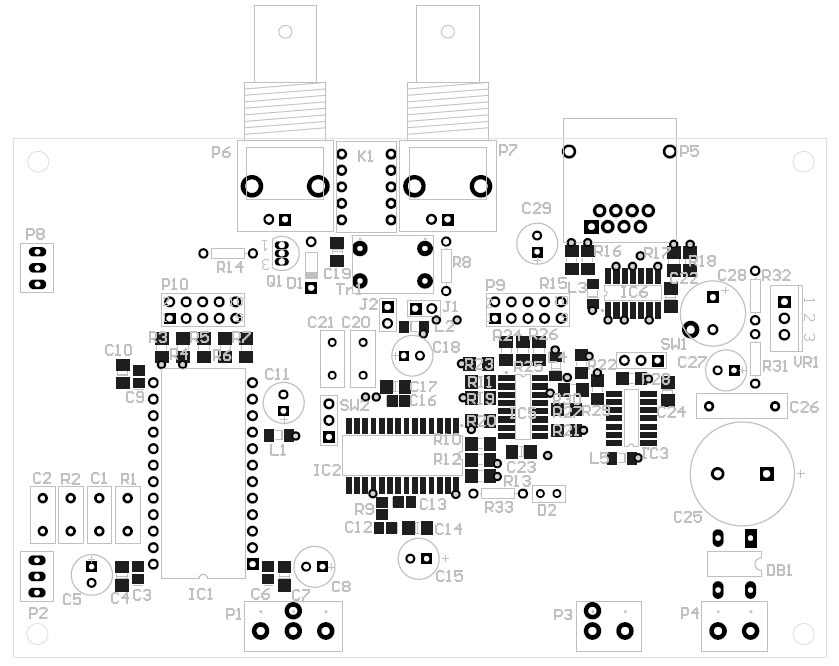

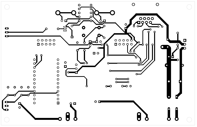

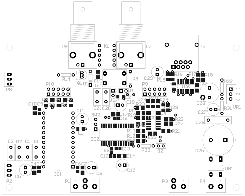

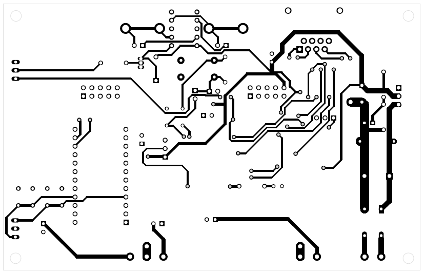

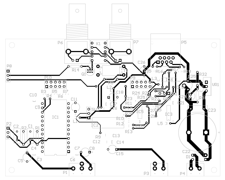

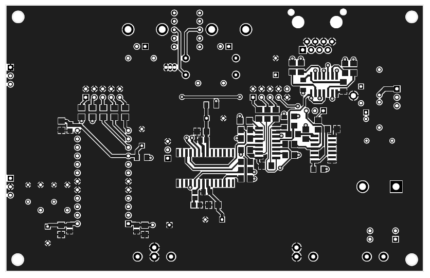

Thanks to rtd's recommendation I read tentlabs's document (Supply_decoupling.pdf) and followed their words. Check out the latest schema and pcb design.
I added the digital power supply to the board as I think that a single LM317 does the job. For the sensitive analog supplies everybody (who might build this board) could use its preferred regulator, I will use Salas reg V1.0 with Quanqhao's board.
The ground of each analog supply is connected to the ground plane at the terminal input and the digital ground is connected to the ground plane only near C25. Is this OK?

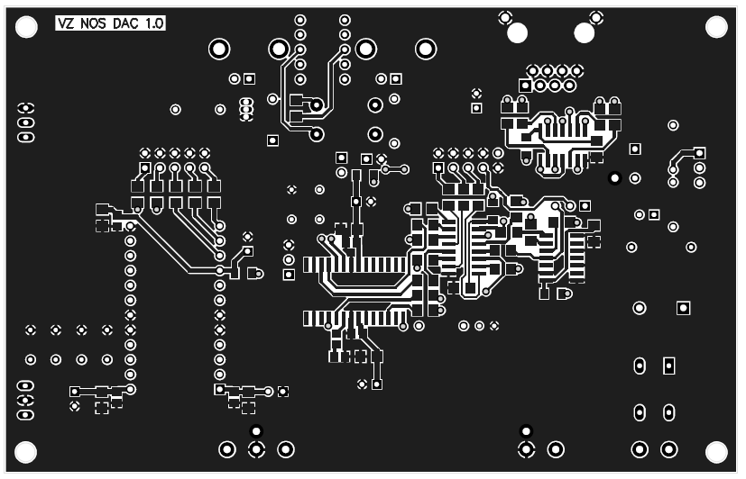

Here comes the first test ready version. All component sizes are checked and fit well. I will post a BOM later.
I added capacitor coupled SPDIF input, using J1 and J2 jumpers one might either use a pulse transformer or use small 5mm caps (Wima FKP2) and leave out the pulse transformer.
Next will come the conversion modules: a simple one with one inverter for testing and a complete, re-clocked I2S later.

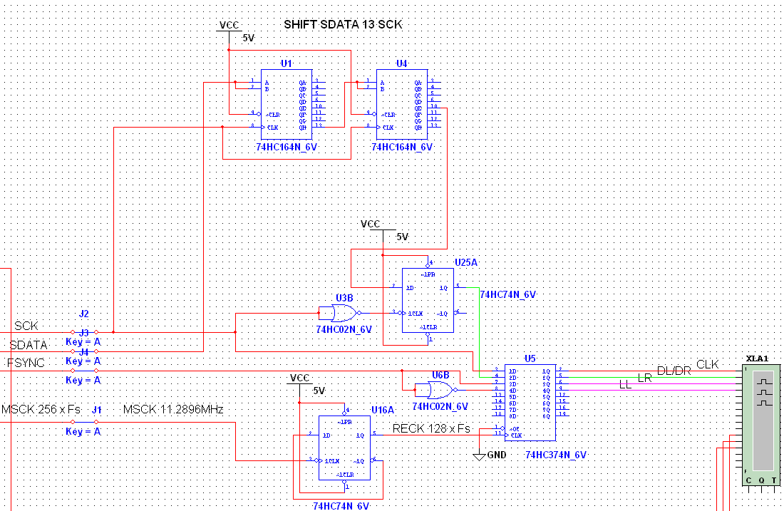

I will connect a converter board between P9, P10 with the schematics attached. It is based on a schematics posted by sampler plus I added reclocking to have everything in perfect sync (reclocking ideea taken from Eric Juaneda's converter board).Vzs,
how you convert the I2S to AD1865 input ?
At least in simulation it converts an I2S signal to perfect AD1865 format.
I2S simple
I will try with this simpler I2S converter first for testing. This keeps the 11.34us delay but converts I2S to LSBJ. It contains the same reclocking mechanism as the previously shown one.Vzs,
What you mean by true I2S input?So, in your DAC board the I2S input is not a pure I2S input
As you can see in the schematics from post #289 'DAC v1.0.pdf' the board contains an I2S input (P5 - RJ45 connector) which is first buffered (74HC125) then connected to a multiplexer (74HC257) with I2S coming from CS8414. This multiplexed I2S is then routed to AD1865 through the converter board.

According to 'DAC v1.0.pdf' the I2S input P5 has the following pin arrangement for I2S signals:
pin 1 - FSYNC (LRCK left/righ channel latches)
pin 2 - SCK (32xfS / channel or 64xfS / stereo sample)
pin 3 - MCK (256xfS)
pin 4 - SDATA (LR data according to I2S format)
pin 5-8 - GND
These I2S signals are routed to the converter board which contains either the simple or the complete I2S converter to 18bit LSBJ of AD1865.
Why do you think a middle circuit would be needed between an PCM2707 board with I2S out and my DAC board?

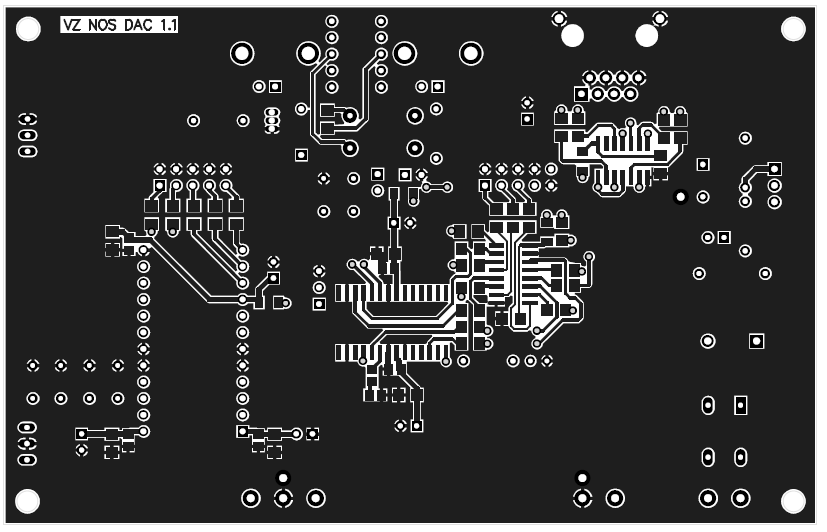

VZ NOS DAC v1.1
Hi! Yesterday I found an error in v1.0 and corrected it: see errata below.
Errata for v1.0 : changed 74HC125 to 74HC126, so no inverter is needed to enable buffer output. Removed the 74HC04 as the in phase/out phase selector will be placed on the conversion board. The whole board became more simple and the ground plane more compact.
!!!! To prevent any confusions keep in mind that neither this nor the previous DAC boards will not work without an I2S - 18 bit LSBJ daughter board connected to P9 - P10 !!!!
I will start the pcb design for the simple I2S - 18 bit LSBJ daughter board (see post #293) asap and will post it.
