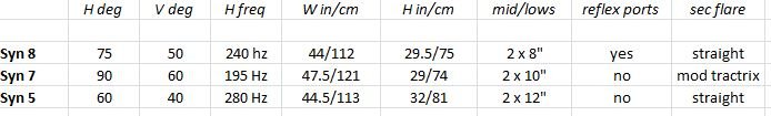

Getting back to a favorite horn/cd combo....
That's my No1 audio project right now....determining that...
For the last year and a half, other than a minor diversion into a ringed-array project, my sole attention has been on synergies.
Despite the annoying measurement anomalies compared to smoother measuring commercial horns etc, they simply sound better to me than anything else.
Of the various prototypes and iterations, three versions made it to full completion. I have pairs of the three, save for Syn5 (cause it's so dang heavy).
Here's a table of the three, shown left to right in the pict below.
All three use either the bms4594HE or dcx464 CD.
All cross between the CD and mid/low cones between 480 and 650Hz. All use steep linear phase xovers and FIR tuning.
All are tuned the same as possible, and all still sound a bit different.🙂
Hope the heavy Syn5 (on the right) doesn't finally win...will have to build another one of it Lol
