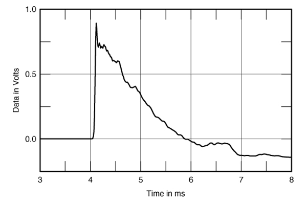

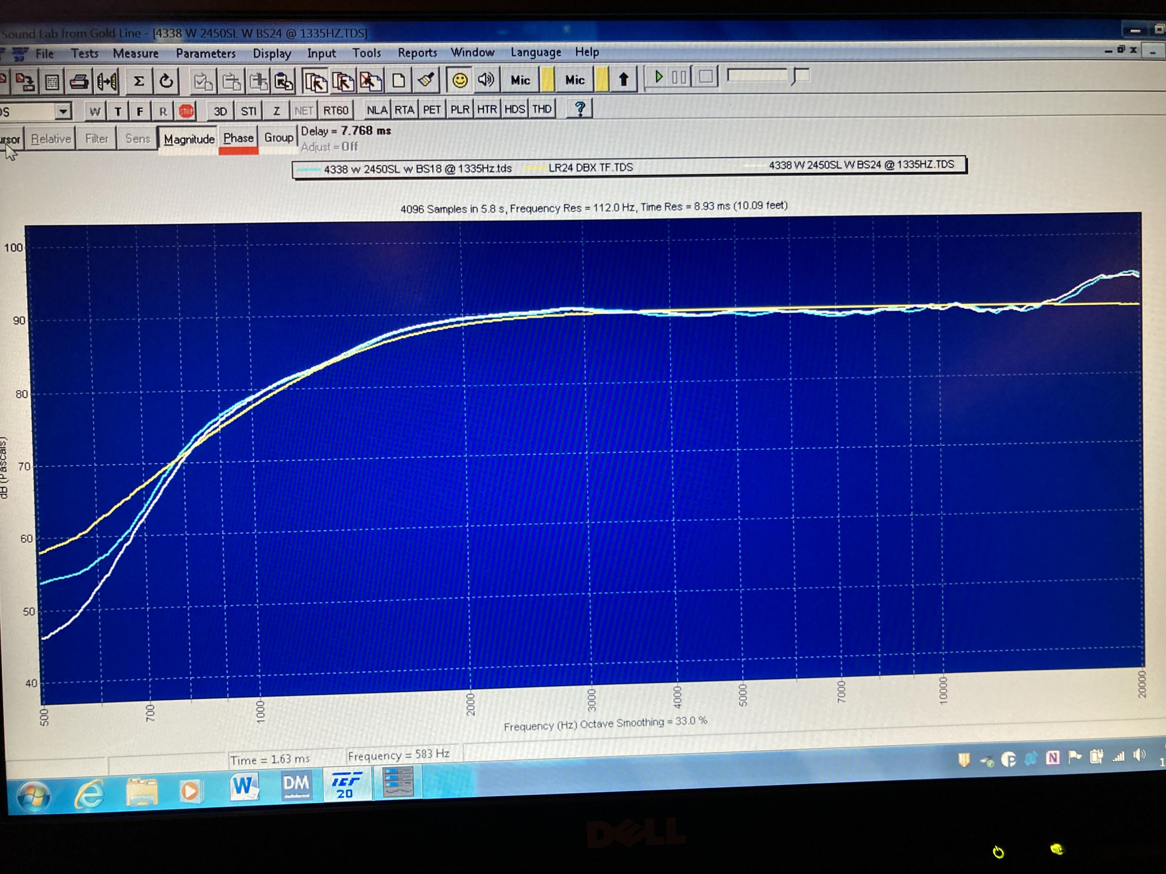

My favorite manageable size combo is the JBL 4338 driven by a JBL 2450SL. A 3.0uF cap in series and four small PEQ points gets them pretty close. The bump at the top I didn’t worry about and left it alone, there is no boost there.
Barry.
Barry.

Those JBL 4338 horns seem unobtanium. Is anyone else making them? Is that measurement with the crossover in place? Looks extremely smooth.

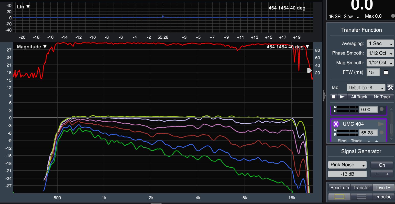

Here's a set of polars from the xt1464 with a dcx464 on it.
On-axis tuning was made as flat as possible, both mag and phase.
Then 10 degree H increments were simply measured. This is my standard starting tuning technique.
Steep 500Hz hpf in place...it would probably load lower. Very smooth to my ears.
Xover at 3100Hz.
The bms4594he on the horn measures the same, and uses a 6300Hz xover.
Maybe the dcx can handle the lowest hpf...i haven't tried finding the low freq points yet, although I'm currently using the bms on a synergy with a 480Hz hp
It can have 'the magic', or it can simply sound dang good, depending mostly on tuning i think....
For me, the magic seems to appear almost by chance when trying to optimize on-axis and off-axis tuning, all the while keeping mag and phase curves as smooth and flat as possible..
So Imho, tuning gives the secret sauce that makes the magic, ....
That is, once a certain level quality in the acoustic design is met, and quality components are used......
which makes a question like "Favorite Horn/CD Combos" such a good one
It's funny, i also totally believe that measurements are the road to the magic, but so often as i toy around with trying different things that measure too close to call any difference ...one tuning will clearly be closer to magic than the other.
I'm getting convinced i need more school/study in making and reading measurements....
