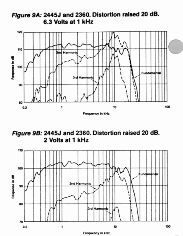

The amazing thing I found with the BMS4590/JBL2380 combo is that even though it measured very well, had less distortion than the 2445 driver, and had a smoother top octave, it did not have the magic in terms of imaging and making music feel like being played by people.
You may associate the extra "liveliness" of the additional second and third harmonic distortion with live performance.
Most of us with more "age experience" have reduced upper hearing response, those harmonics can add some "magic" that has been lost to the sands of time..
Did you EQ both combos to the same on-axis response?

Yes both combos had the same target response and were very close after correction. Tonally they sound the same. You can hear that the BMS has less distortion. There is no extra "liveliness" as you mention with the 2445. It is not a question of frequency response because it doesn't sound brighter. I am talking about the ability to place instruments in space and create a sense of being there and more clearly articulating the texture of different instruments. One would think this would be a function of the frequency response (instrument texture), and I was quite stumped to find out that the BMS just does not do it on the 2380. I tried the two drivers back and forth many times and triple checked the crossover and measurements. And once again, I would not even have noticed it if I just had the BMS because it sounds quite decent.
This is why I was wondering if other folks have similar experiences of favorite combinations of horns and CDs that go beyond what you can see on paper.

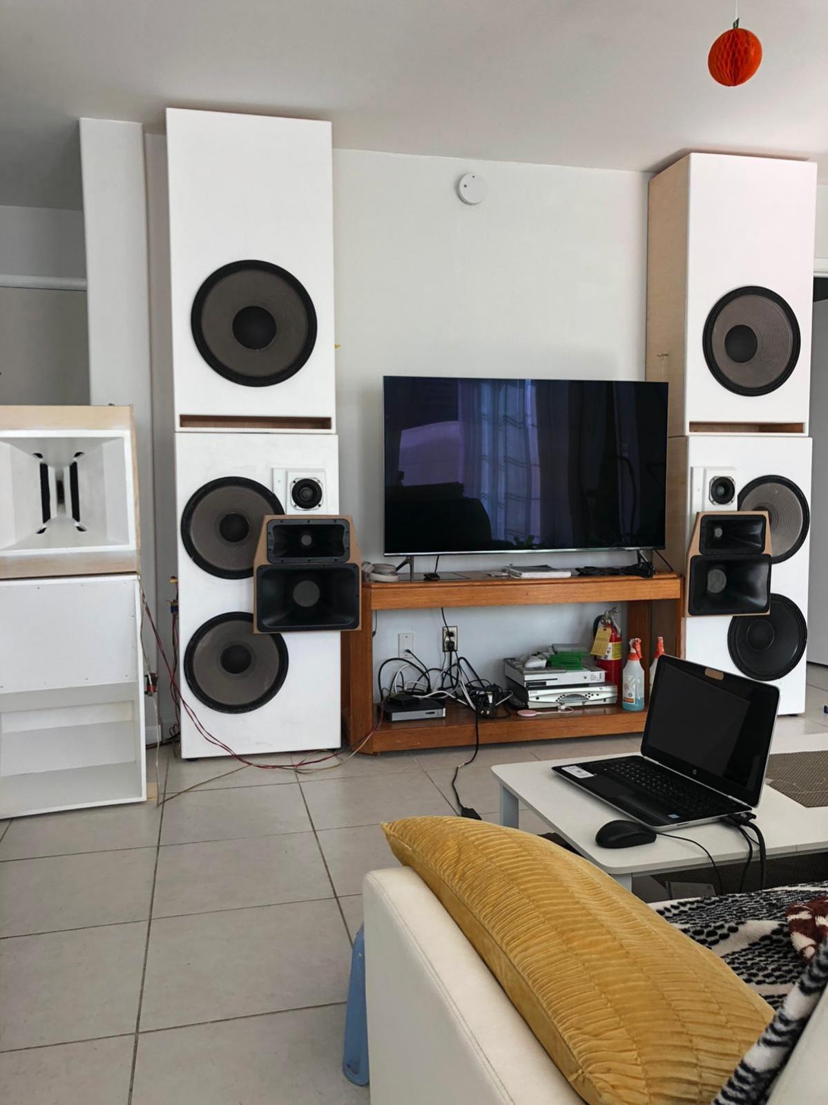

Westrex 2080/2090 on Altec 1505 horn. I've never heard anything else like it. Of course the driver is near unobotainium, but it has a realism beyond its 288 American brother. Similar to what RA7 says about his JBL, this has lifelike causalities that are hard to match. Real people in a real space playing real instruments.
Was it you who had the 2384 waveguide at one time? Could it not match your current setup for realism? I would think a 4" beryllium dome on that horn would be about as good as it gets.[/QUOTE]
That's probably will be me.
Yes, it's a beautiful match, but there is as always a compromises - top octave.
Cheap 1" driver with aluminum membrane in "Synergy" Renkus-Heinz produce better highs than my 4" beryllium JBL in any horn or WG and equalize is not helping.
I struggle with it for long time: trying different crossover points and orders, different WG, even Synergy type.
Now fighting between two choices: comeback to Synergy based on 2384WG, 2435HPL and 2169HCMCD-81H and add Super tweeter above 8-9Khz, or improving crossover for 2435HPL in 1200hz+ in 5006815WG, bellow gonna be 2169H in huge Cinema WG - forgot the part number.
Even tough the 2169CMCD is the best midrange I had in 20 years, it doesn't impressed me in 15"WG that you can see on photo - no magic there.
2384 with 2435hpl, crossed at 750hz 24db LR (1khz when cranking)
Mcm 54-580 6.5" across 1" threaded horn (pyle ph65, used by zaph) and jbl 2407 crossed 2khz 24db LR
Jbl pth1010hf and jbl 2431h (aluminum, right ?)
Probably any tractrix round (if i could live with decade dispersion) or OS round.
I think conical is an option, assuming not much low freq loading and foam up the mouth.
