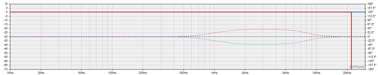

One trick I've been finding really useful is running a 45 degree phase difference between L and R from about 800 Hz to 10 kHz. You can do that using rePhase. if you're interested I can post a .bat file to convolve your FIR correction with this phase delta to produce a file that has both: the FIR correction and phase delta.
This trick seems to really pull the images together. So, even low frequencies have a clear point from where they emanate and helps with localizing snare drums, etc., that have a wide frequency range. There is a tremendous sense of being in the space. It also sweetens things up and makes each instrument more nuanced. Try it.

Interesting. Are you saying you apply a constant 45 deg phase shift between about 800Hz and 10kHz ?
I pretty familiar with rephase....which tools are using using to do that...parametric phase, or maybe a combination of filters linearization?
It is something like the attached, except 22.5 degrees in each direction.

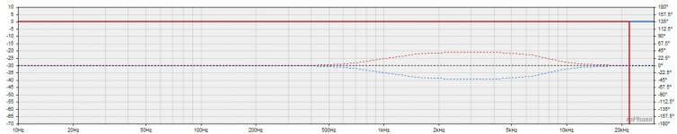

Thanks. Looks like some easy to implement para phase EQ 🙂
