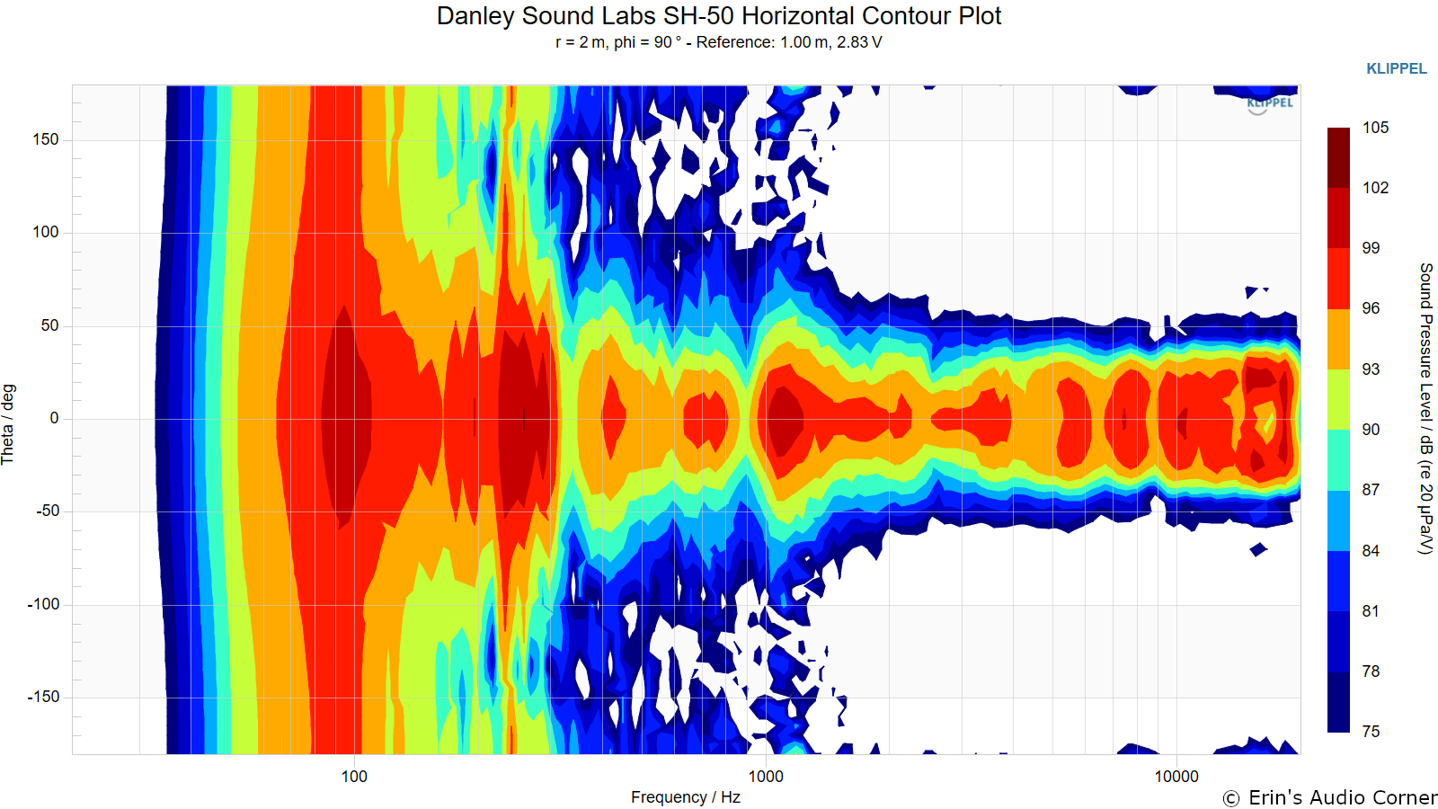

If you look at the measured response over on erinsaudiocorner , it's lumpy. The bass is thin and the speaker is kinda bright. But all of that can be equalized, and once you do that, you have a heck of a hifi speaker.
"stock" SH-50 polar response
And note that it's spectral balance isn't a "failing" of Tom Danley; the SH-50 is a prosound speaker, and they tend to be "bright" because they're designed to cover a room of a thousand people, where the treble will be attenuated by traveling across a sea of clubgoers.

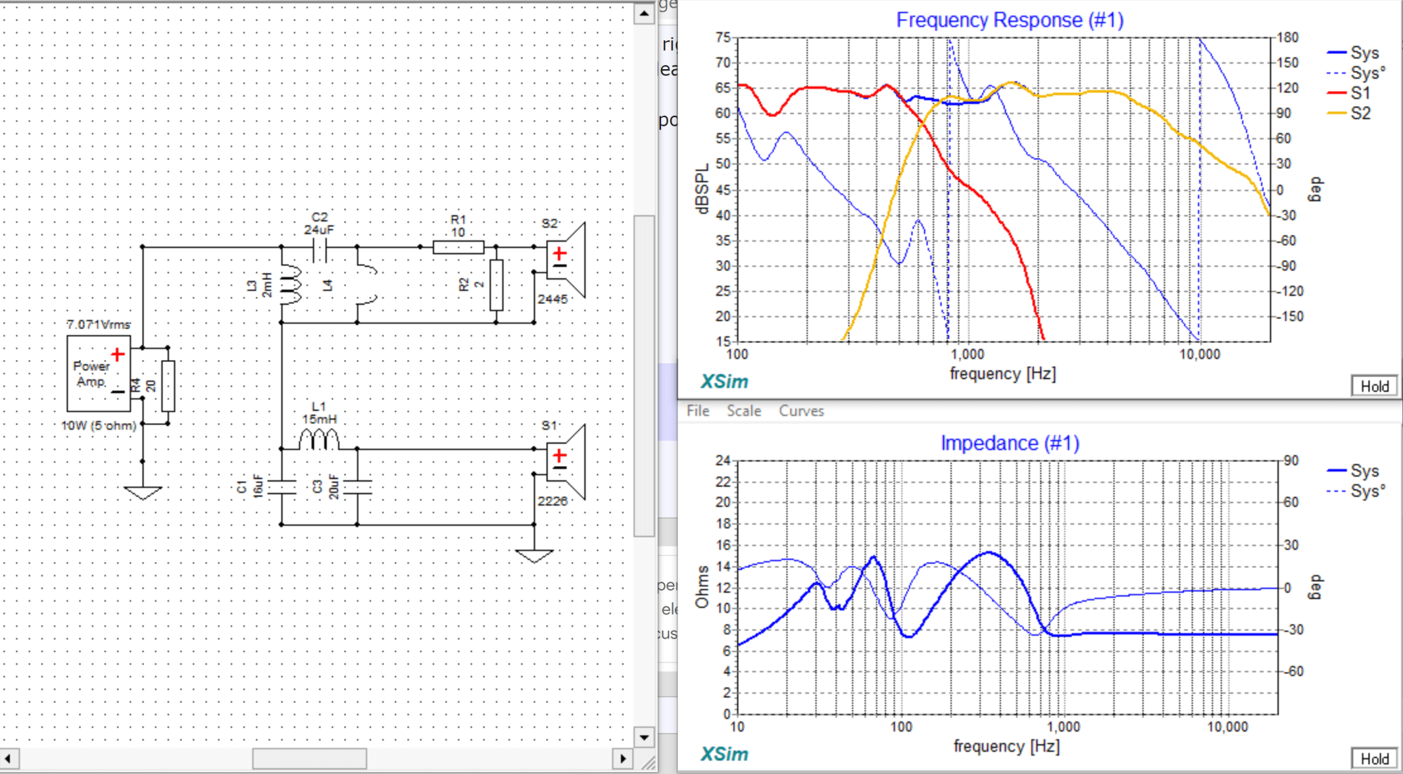

As I also acquired the same drivers for my setup recently ( 2226h, 2380 + 2445J ) for my big speaker project - would you like to share the crossover design, it would mean a giant leap in finishing my project!

Yes, happy to share. It is a bit unorthodox and requires EQ, but I will post it here.
Since this thread started, I invested in the 2384 horn and I am running it with a JBL 2452 driver.

Here's the XSim crossover schematic and response details. The crossover is around 650 Hz. In my measurement, there is floor bounce in the crossover region (around 600 Hz), which I tried to eliminate though couldn't do it completely. Beyond the crossover, all that is needed is IIR EQ (no FIR EQ needed) to reduce the peak at 1550 Hz and raise the HF (the sloping response is typical of constant directivity horns). I threw in the 20 ohm resistor across the terminals to flatten the impedance because I was driving it with single-ended VFET amps, but it is not necessary.
The crossover itself is of the "current source" type, which is quite unusual. See Nelson's guide here: https://www.firstwatt.com/pdf/art_cs_xvrs.pdf
It works nicely, producing a near ruler flat response. I measured the "after" with both drivers and it was ruler flat, just like XSim shows, and sounded like that. I played with the values quite a bit to fine tune it. However, I also settled on inductor and cap values that I had on hand. You could fine tune it a bit more.
With the current source crossover, something is just right about the sound. There is great rhythm and everything sounds right. The word I would use to describe the midbass and bass is "unleashed."
It's not perfect, but should give you a good starting point.
Have fun!

Hi ra7, great, thanks!
Would it be possible to boost the highs with capacitor across that 10 Ohm resistor in series with 0,02 mH inductor to regain lost high octave before applying any external eq?
I will surely built it and check how it sounds... btw, what is IIR EQ you use?

Yes, definitely. That type of shunt around the 10 ohm could work. I tried it too but then figured a simple shelf filter in JRiver could get me out beyond 10k.Hi ra7, great, thanks!
