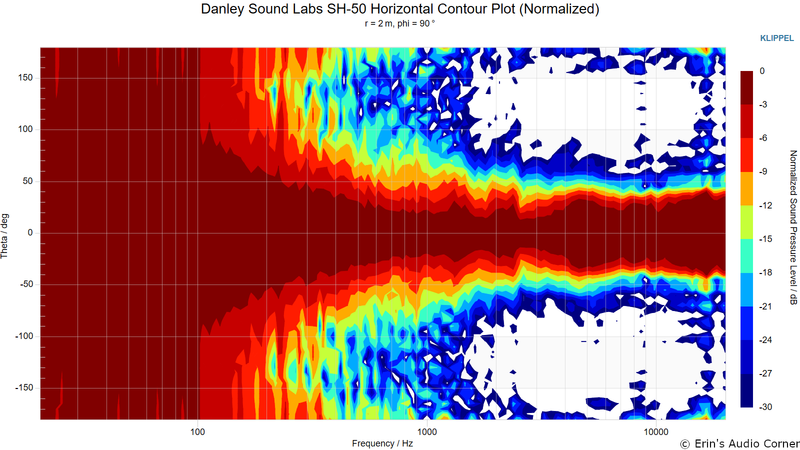

Have you seen the results of Erin's test on the Danley SH50?
Danley Sound Labs SH-50 Professional Audio Speaker Review
I guess with a bit of EQ it's quite the performer!
Standard, it is a bit more rough than many look for. Yet I don't think that will hold it back when listening to it in a room. Avoidance of reflections would be stronger than with many other speakers.
Way less ceiling bounce than average speakers:
Distortion performance is impressive, as expected:
Well it certainly needs the EQ. I didn't realize how badly. But that is what you are missing out of the box at least, if you go passive XO.
No, I hadn't seen that review but I knew about the SH-50 and Hyperion and how well regarded the SH-50 is. They are what I point to to justify my narrow directivity. I would argue my approach has same overall directivity, except smoother and extending lower except its not fair to compare one speaker's simulation to another's actual measurement.
The SH-50 shows some narrowing in the low khz region. What is distinctive to me is that it actually widens slightly in the top octave. That is hard to do in a conical horn with very little in the way of mouth termination. The polar chart of most conical horns wouldn't be a solid dark red in this region. There must be some Danley magic in the throat that Mark100 should figure out.
The subjective part of the review talks about how loud they can go and their dynamics. That is part of the Danley signature. He is less interested in the right level of delayed reflections. We've been over this ground before.
I think the reason they have such low THD is their multiple midrange drivers, overkill perhaps but provides enormous headroom and part of the great dynamics. BWaslo has shown you can get by with one mid but it seems to me that is a false economy.
I suspect that having headroom (and plenty of it) is one of the qualities that is hard to beat. So I agree that having one mid would not be a choice I would make.
The Hyperion is a domesticated version of a synergy, starting with a more sophisticated and better behaved horn. At least that's what I suspect.
Whatever you do, I'd recommend to build in as much headroom as you can (up to a point where it's still economical to do so). 🙂
If you do that, you'd be well on your way to come out quite close to (or surpass) these results.
