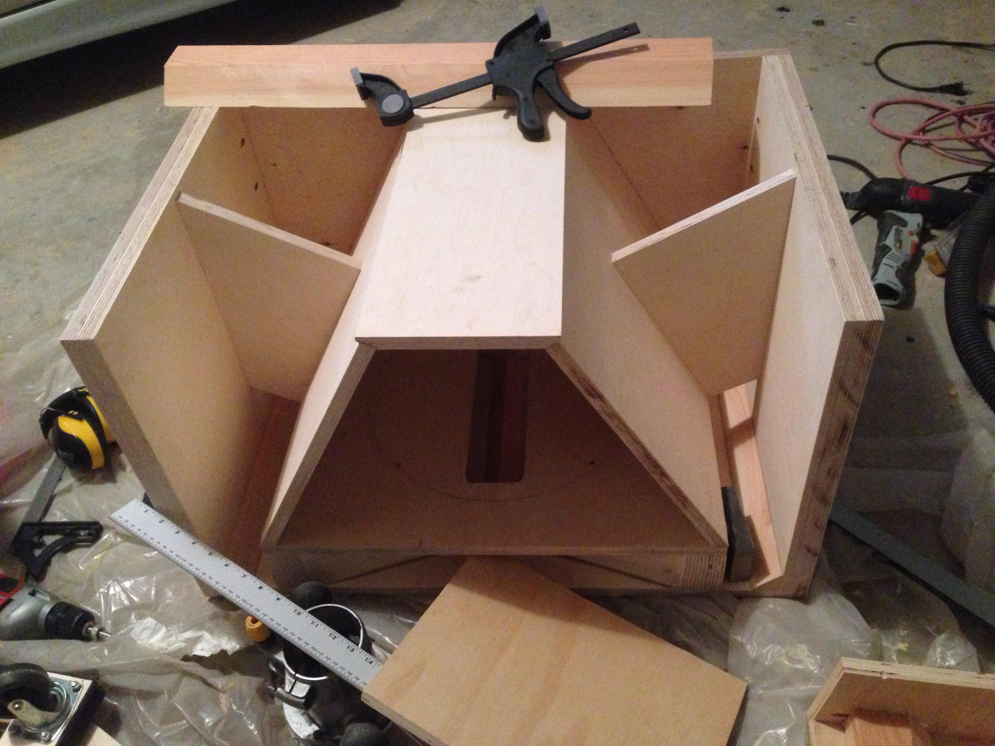

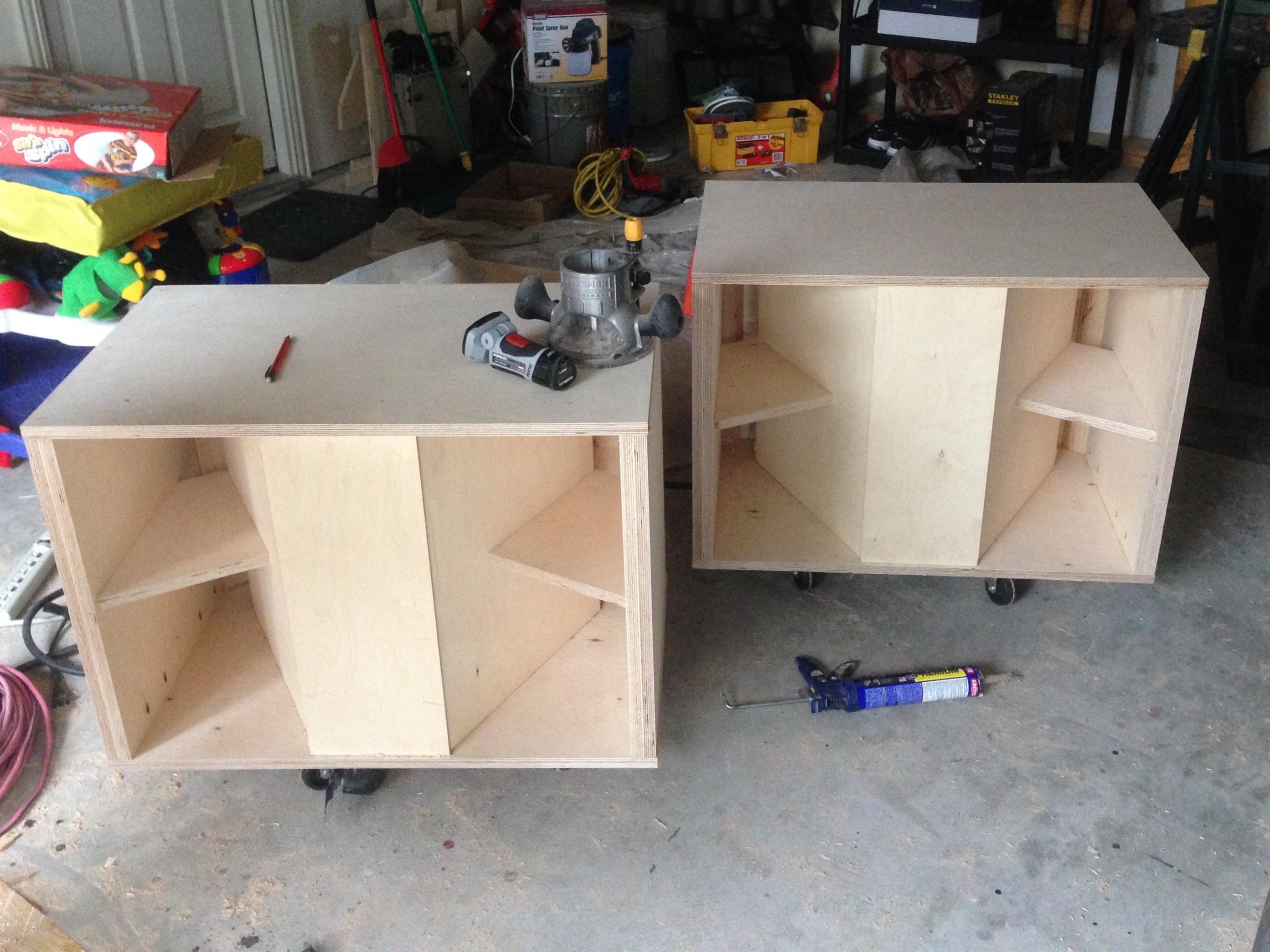

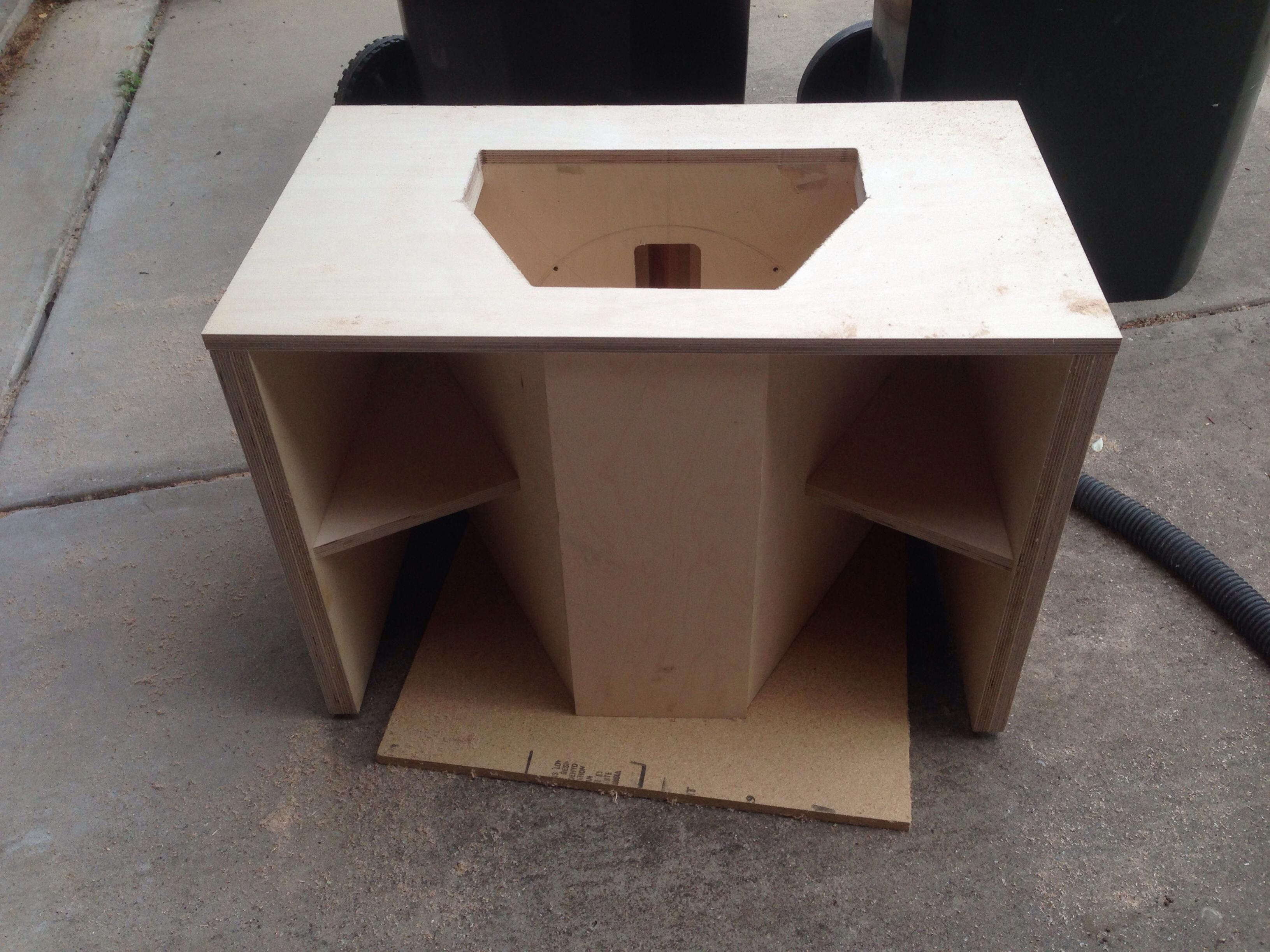

Not a lot of progress to report this weekend. Other stuff beckoned. That said, I did get the boxes prepped for gluing the tops on. I'd like to fit the custom fit braces first. I think I'm only going to use one brace per half-mouth rather than two in my renderings.
I also need to ponder whether to stain or veneer these monsters. Birch is always troublesome to finish in anything other than a natural finish
you can emulate natural patina on Birch with dilute layers of orange shellack, you can also find versions which have garnet powder to ad a warm red hue. Remember if you use a varnish for top coat it will add color as well.
Yes, shellac is easy to use. Have to be careful with orange shellac though and dilute it , lest the speaker ends up looking like it has a fake spray on tan . It's definately on my short list . Shellac definately gives the wood some shimmer too compared to Danish oil (tried it on some scrap). I'll make the final decision on which to use or whether to veneer after sanding .
I've started bracing the cabs, making micro adjustments with a router+pattern bit guides by a piece of scrap. This can take a little while to get right. I masked off everything relevant and tapped it in securely. I used liquid nails for a secure fit. If this ever comes loose in the future (however unlikely), I'll use some pocket hole joinery on it . BTW, I purposely left a bit of a lip on the front piece, to mate with a grille cover, if I decide to go that way.

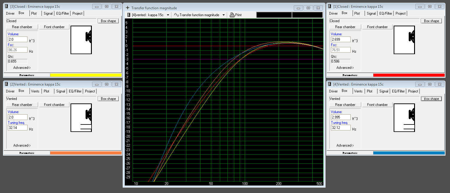

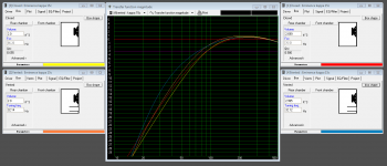

Looking into the porting calculations. I've attached DJK's instructions .
1. However, in the text of this doc, .. he recommends against my kappa 15c woofer . I can't understand why. It's low Qts and has a Vas of about 10 cu ft. Is it a question of Xmax ?
2. Roughing out the calculations, it doesn't look like I should need 4 - 5 cu.ft like recommended for the K33 /K43 woofers . Not sure if this is a question of different T/S parameters , data entry error on my part or just dumb luck. The curves on the left are with the stock volume of the belle dog house (about 2.3 cuft less space for the woofer => 2 cufrt approx) and on the right are the winisd calculations for sealed bessel / ported SC4 . If these calculations are correct, I can easily add 1 cuft via a bottom riser without having to port out of the top section.
@DJK, could you comment? Thanks
Vented box size is proportional to the square of the Qts times the Vas.
We are trying to get a B6 response, so the optimum Qts=0.312
0.312^2 = 0.097344
0.25^2 = 0.0625
0.097344/0.0625=1.557504 times the volume.
Viewed the other way, the lower Qts driver requires 0.642 the volume.
The higher the Qts, the lower a driver can go.
The intercept of the box size and bass extension equations is at a Qts=0.312 (the optimum for a B6 equalized alignment). In fact, any other Qts yields a C6, only a Qts=0.312 can yield a B6.
Just about any woofer can made to work OK, the concept seems to work best with a Qts=0.312
Your sim for 3 cu ft shows a F9=40hz, combined with the LaScala horn gain above 100hz it may sound a bit 'lean'.
You should be prepared to change port tunings to find out what sounds the best. Most people at Klipsch preferred a 35hz tuning with around 4.5 cu ft of back volume. Sims showed very little difference in bass response, but performance on music showed a big difference in perceived 'slam' vs deep bass extension.
