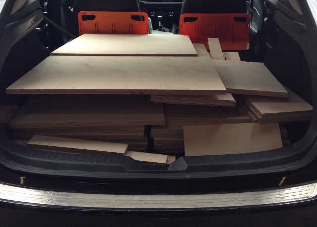

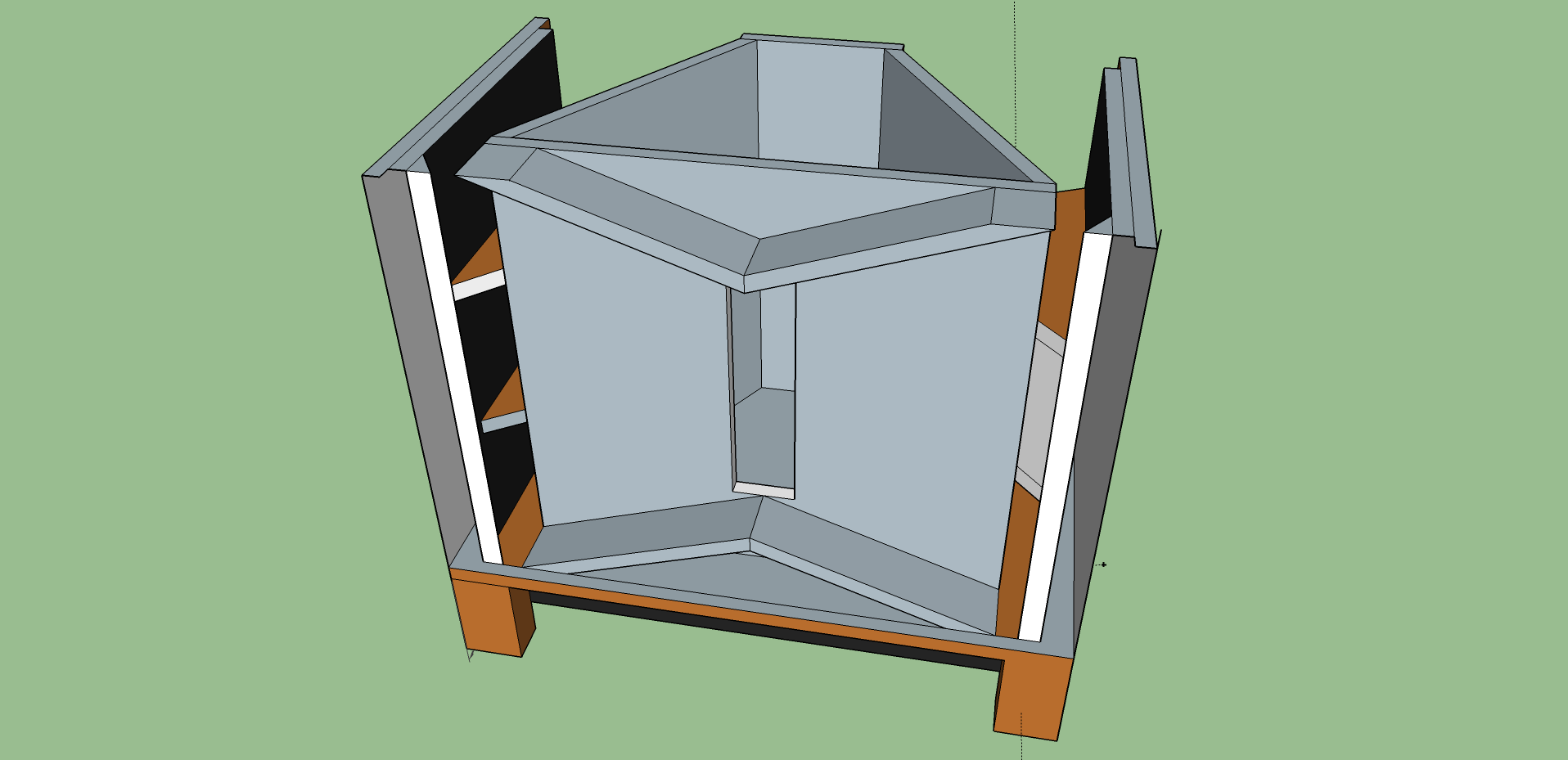

Here's the computer generated cutlist for the basshorns using 3 sheets of ply. I also decided to double up on the rear face (the sides are already doubled).
Now, I need to figure out how to get the rough cut pieces into my car 🙂

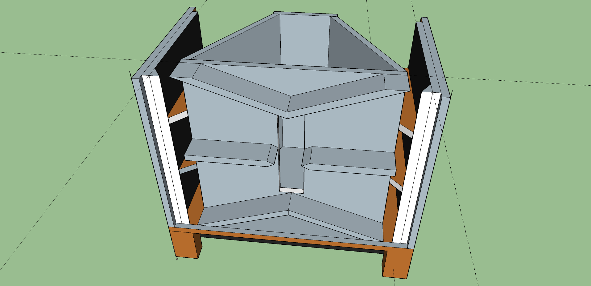

On further introspection, it seems more efficient to add a center brace to the throat area (large unbraced area), rather than double up on the rear.
My personal rule of thumb is to leave no panel width of greater than 8-12" unbraced. I'm stretching the rule a bit but there should be enough scrap to add further bracing if needed. The important thing to note here is that this is a horn, so the orientation of the brace is as important as the position. Also, excessive bracing can affect the flow of sound waves through the horn
Plywood (3/4" baltic birch) has been been cut (about 2.5 sheets worth + some offcuts) . I had a local lumber yard ( Hardwood Lumber Company of Dallas ) make precision cuts for me this time so I don't have to hack at the ply for days in my cramped garage. I've attached the cut list I used to this post. Amazing what will fit in a compact hatchback. I'll soon post a (slightly) corrected sketchup rendering that matches up with the cutlist

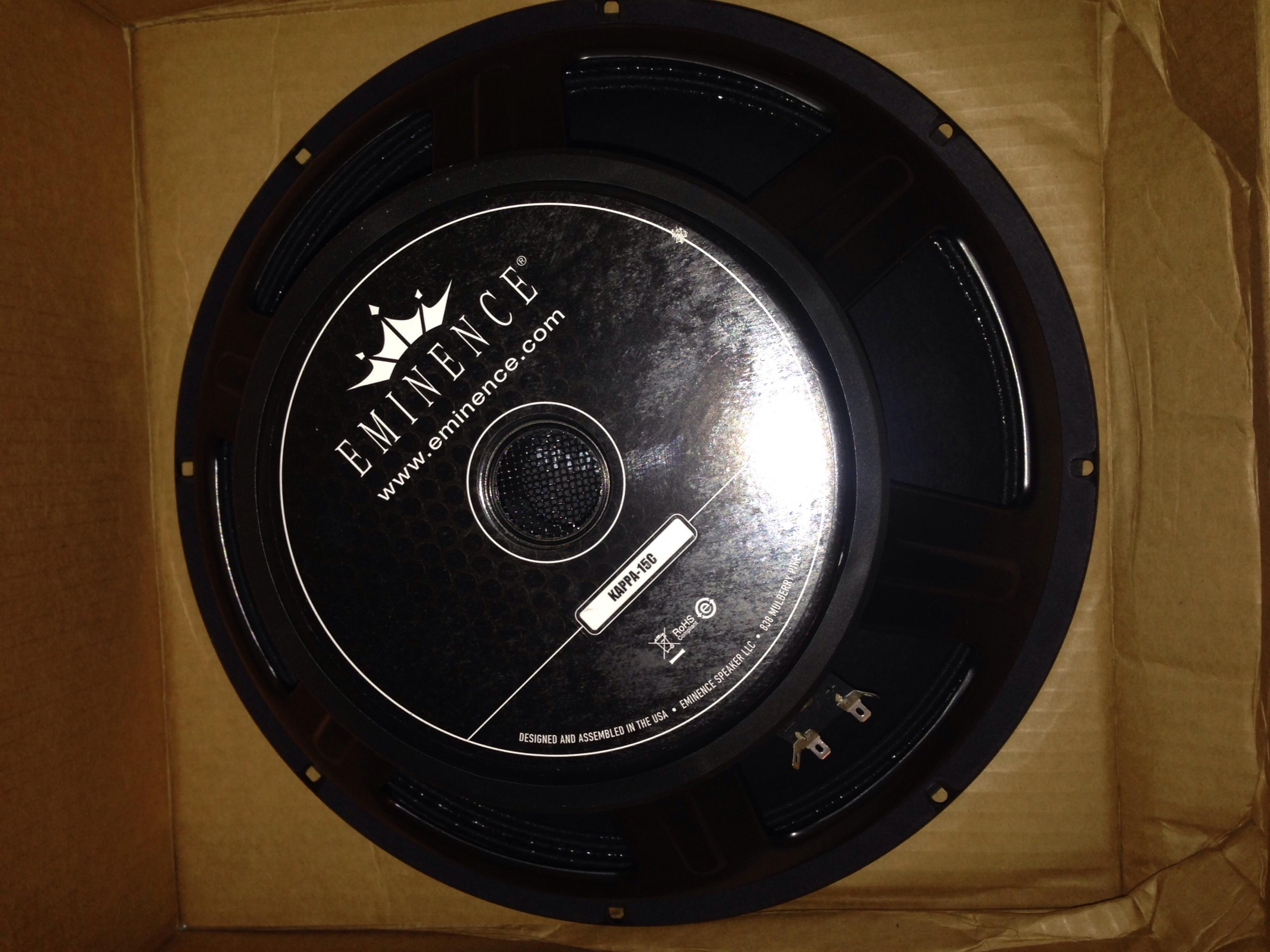

Almost done with the pair of midbass horns. Need to glue up the rear chamber, add braces and seal the top. The pic is of a test fit.

You will either need to rout a surround relief slot or use a "donut" gasket to keep the driver surround from hitting the baffle on excursion peaks.
Art
Art
Zobsky,
Art
Forgot about that , I'll deal with that then . Will 1/4" MDF be okay ?
Zobsky,
Art
I'm guessing that doubling up on the gaskets should work. any thoughts ?
Official Speaker Repair Site - Orange County Speaker - Home of GLS Audio Speaker Gasket - 1 Solid Piece (for 1 speaker)
Thanks. Unfortunately, one of the doghouses has already been glued up. Ill see what's possible wrt routing
With only 2.4 mm Xmax, an extra gasket (or 1/4" MDF) should provide plenty of clearance, but increases front chamber volume more than the surround recess I suggested that DJK showed.I'm guessing that doubling up on the gaskets should work. any thoughts ?
Increasing the front chamber volume should slightly reduce the HP frequency.
I bought a 1/4" x 2" x 4" piece of MDF,.. mostly because it's cheaper , incompressible , easily available and more customizable than an off the shelf pair of gaskets . I can always add SOME of the internal offcut circle to the front chamber to reduce its volume . More info after i butcher the wood 🙂
