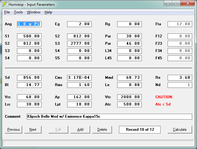

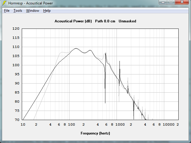

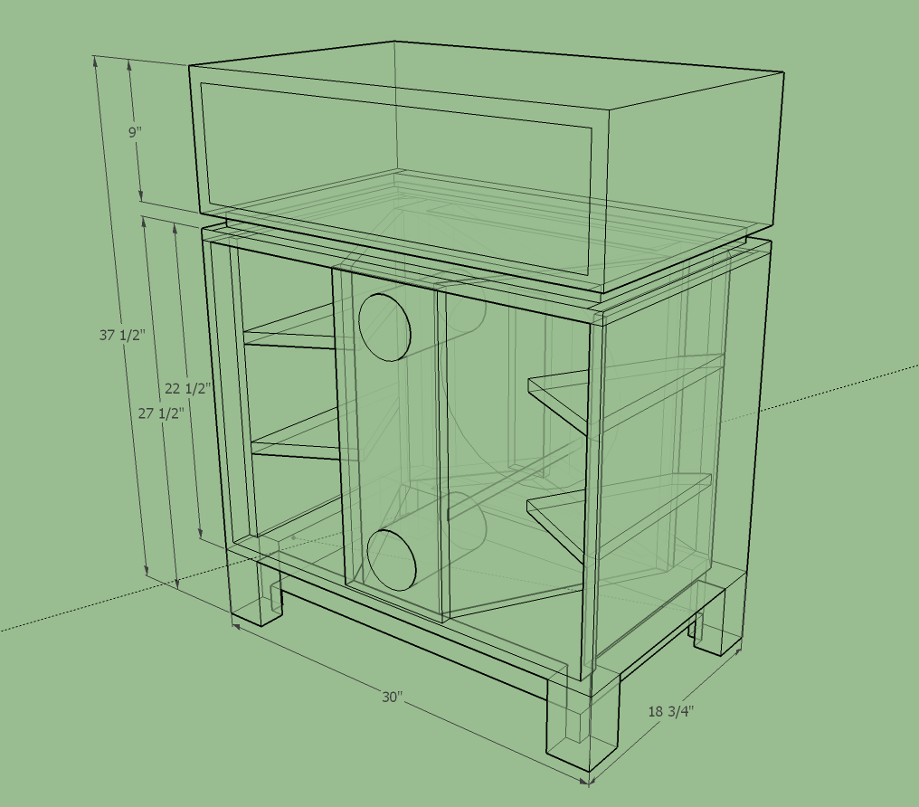

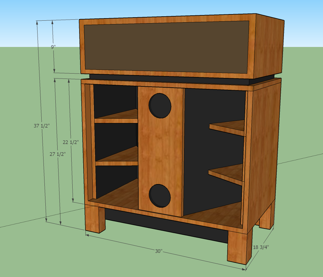

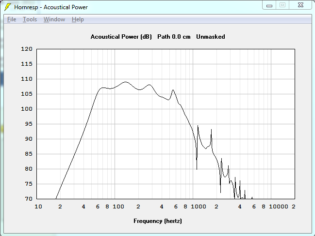

1. From these plans, I've attempted to simulate the response of a belle klipsch running an eminence kappa 15c with the DJK ported mod on the front baffle (see pic). From the sims, it looks like I don't really need to add a riser (the riser mod adds more deep bass, though at lower SPL - this level can be lifted via an EQ boost). I can live with a solid 50 Hz and implement a sub to take care of the first 1.5 octaves . Regardless. I've added an arbitrary "underbelly" to my rendering that can be increased if needed.
Thoughts on my analysis of the EQ mod (I used the stock rear chamber volume of about 68 liters (65 liters + 3 liters I intend to use by cutting into the dead space enclosed by the 2 V, the rear of the enclosure and the motorboard)?

The odd constriction is supposed to do with path length differences and such and improves the upper end of the horn.The bass highpass do look early. Have you tried reducing the camber volume by 2/3 or so? I tried several drivers in a horn similar to the La Scala and the bass was deeper with mid Q drivers (0.4 or so) so try running a simulation with a cheaper driver! You should get the horn down to 60 Hz without ports.

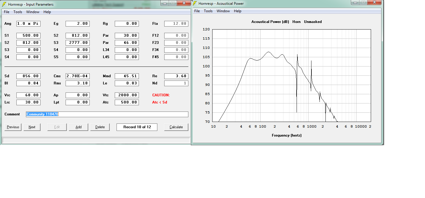

Here's the response with a somewhat less powerful woofer, the community 110470
Not too shabby for a sealed rear chamber though I can't speculate how this will sound subjectively compared to woofers with more powerful motors. The FAQ on parts express implied that this cone might not be beefy enough to handle the high throat compression ration.
Increasing / decreasing the rear chamber size does alter the response somewhat in either direction. I'll experiment with some other drivers

Looking at my initial render, I wonder if using cabinet feet to raise the speaker off the ground iscounter productive to the intended 1/4 space (wall loading) application . OTOH, the wavelengths in question are significantly larger than the height of the feet so I don't know if a few inches makes a difference.

Simulations of changing the chamber size really does minor changes in the high pass knee. That is if the knee is a gradualy increasing slope or a sharp bend or even a small hump. Going down in sensitivity of the drivers also lowers the sensitivity of the horn. But in a domestic setting that hardly matters.

2. Looking at my prototype, it would make more sense (and arguably look better) to add (removable) slot ports to the underbelly, closer to the ground place - as opposed to installed into the center board
Looks good in an Onken alignment and two look really good if a ~678 L cab is acceptable.
