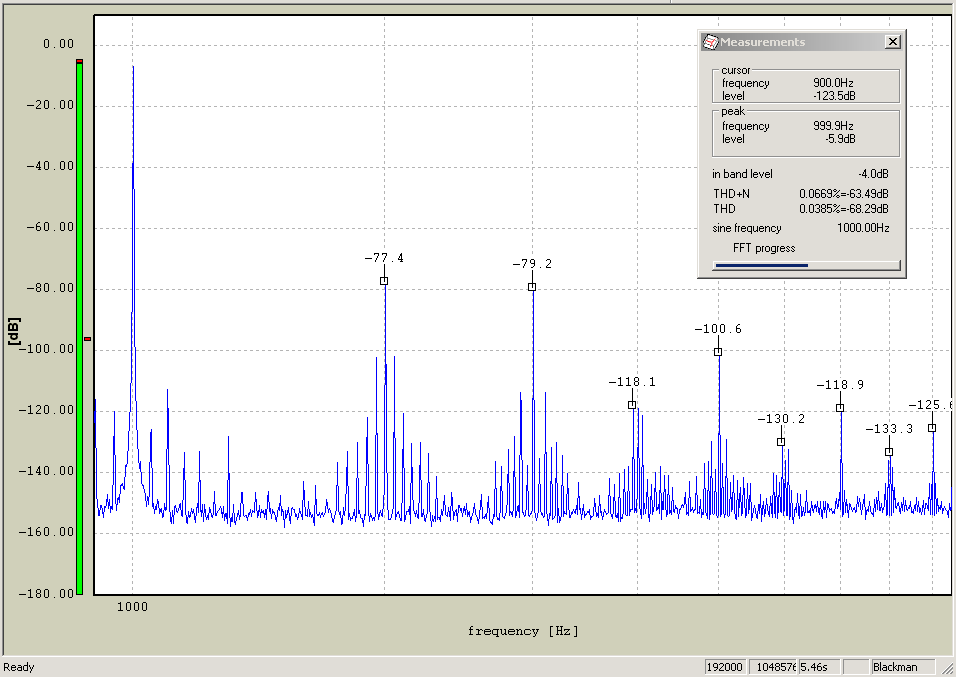

P.S. I am not completely convinced that there isn't a degree of thermal modulation "punch through" from the AC heaters, even on the indirectly heated ones. This is an area that I have been intending to look at, but just haven't had the time.
  • z-preamp-6c33c-itest-1khz-1mfft-300ma-600ohm-ip-6db-0_068-63db-thd--45hz-96khz-1w.gif

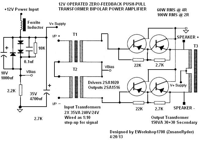

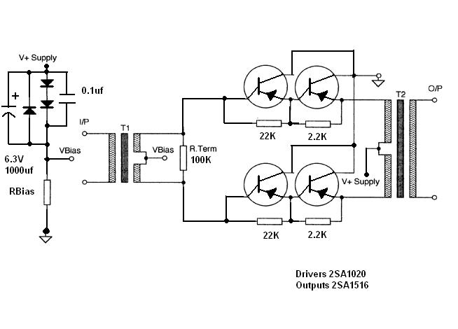

I'm in the process of building a transformer/transistor amp with PNP transistors simply for the reason of being able to ground the collector leads (metal tabs) to the heatsink chassis without insulators, and also for the (hopefully) simple biasing setup.
Regardless of MOSFET or Bipolar or Tubes, I'm wondering about the paths of current flow in the input transformer of the circuit. Where is the return path, the CT or from the other transistor? Could this be modified without CT? Do I need the opposing diode and capacitor to sustain signal flow if the required driving current is higher than what is provided by the biasing network?

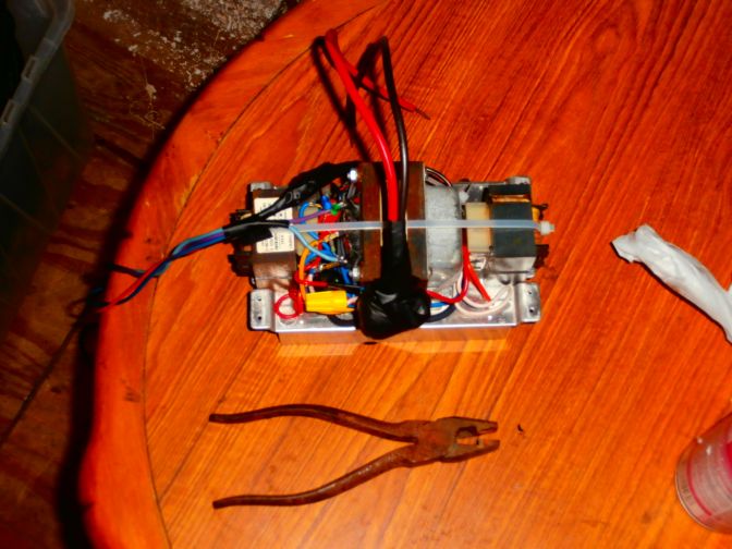

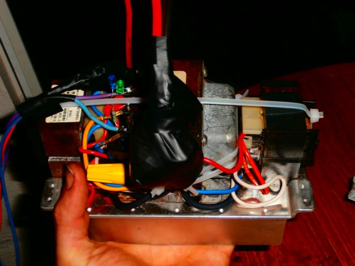

I finished it!!!! It lives, and is loud!!!!
The Bass response is really strong, this thing plays lows with ease and really moves the speaker cone effortlessly. The highs are a bit lacking, but it plays clear, adding bias picked up the highs better some.
It plays loud on only 12V! So far I have no heat at all, it runs really cool.
I finally sourced my input transformers, I found two identical 240V/24V 30VA 50/60 Hz transformers from scrap air conditioners. I run them both in series to have a CT.
I tried using the HV (old primary) winding on the output transformer and noticed lack of frequency response and excessive current draw, so I'm using the speaker directly across the CT winding driven by the transistors. Connected direct gives good frequency response and driving capability.
I'm still tweaking the bias before I settle on a value and stick with it. I will post an updated schematic with all the parts values. I'm still having fun playing with it!!!!
May make a good PA amp for simple use........

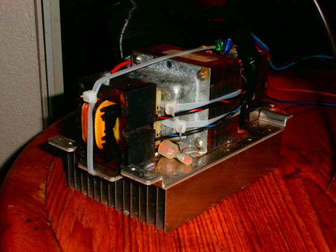

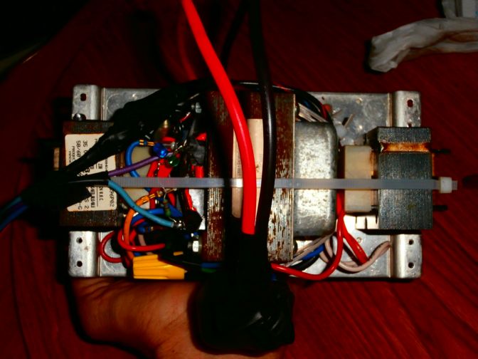

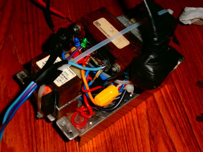

Here it is! Finally a loud and simple 12V amp that does not require an SMPS!
This is the final changes to the circuitry. Feel free to enjoy, copy, modify, or make improvements as needed. Thanks to everyone here @ diyaudio for keeping this discussion going and for the tips required to get it all right!
Also uploaded some pics. All PTP, no PCB! As you see, this is a very compact and heavy little amplifier. The output transistors are on the heatsink, concealed by the 3 transformers.
Don't mind the big ball of electric tape with the power wires, it's just covering up my 35V 4700uf Capacitor and Ferrite Toroidal DC filter.
Now about the Amp.............
Bass Response is excellent. Audio on this amplifier even seems bass-boosted.
Treble is good now, I find a trick is to put a 4.7 or 10 ohm resistor in series with input to boost upper highs.
PNP transistors work very good, screwed directly to negative-grounded heatsink with just thermal compound, no insulator required! Devices rated @ 12A, 130W each, genuine Toshiba.
This amp is STRONG! It plays 4 and 2 ohm loads with ease! Amp only gets hot playing 2 ohms, just warm with 4 or 8 ohms. Distortion comes on easy, but sounds good still unless driven to severe clipping.
Amp has High-Gain. Not much needed to get loud!
I have no problem driving asymmetrical loads. I have antiparallel LED's across the speaker output to see them light according to positive or negative swings, and lots of modern audio (esp dubstep) has signals that will drive just one of the LED's for certain notes, but the amp doesn't distort or have any trouble. I still find however, that rock music, or music with heavy guitar or drums sounds best.
Can't wait to try MOSFET on the next one!

I have found that using more iron helps greatly with low frequency THD even without approaching saturation of the core and staying well below it.
This is also something to consider.
I have finally got some suitable High Current FET's to give this a try and I too will show my results in this thread when I get around to building it.
I have made many variations using a simulator using BJT's and also Opamp's to drive the output devices as well but you can't beat the simplicity of a single driver transformer though.
Cheers !!!
jer 🙂
