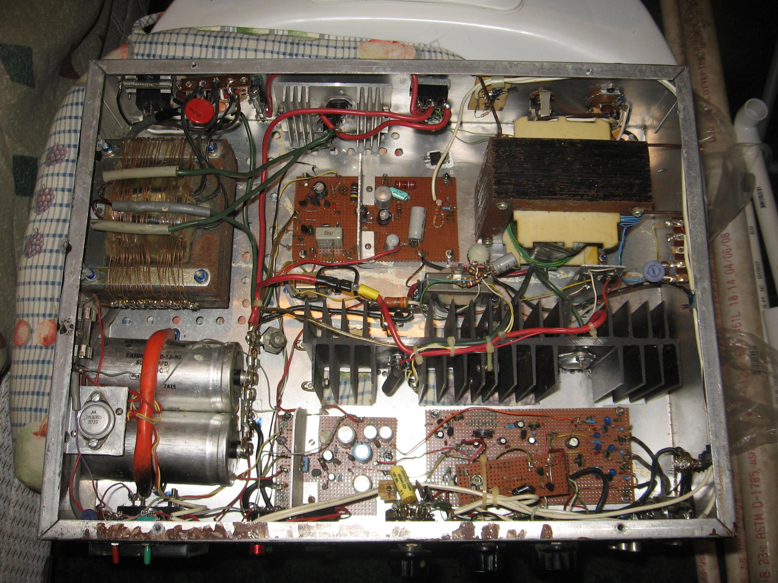

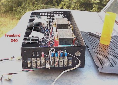

Thanks Susan. I would usually select a transformer with thin laminations from variable load service, such as a 200 VA or so transformer from an old Centronics 301 printer and then completely rewind it for my desired ratios, with center tapped windings done bifilar, as I did in a 100 Watt PA amp I built over 30 years ago.
The amp had decent sound and would do full power from a 13.8 volt supply and drive 2,4,8 ohm and 70 Volt loads, thanks to a real output transformer! It's on the back burner for a 21st century upgrade in the next year or two.
Photos: 100 Watt PA amp and 120 W + 120 W car stereo amp, both using power transformer cores in audio service.
