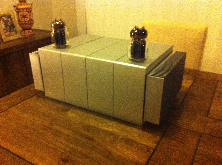

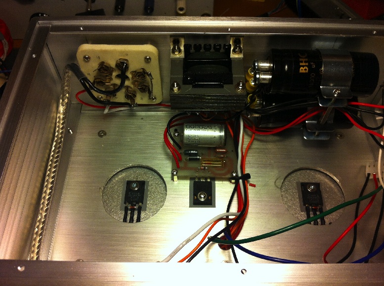

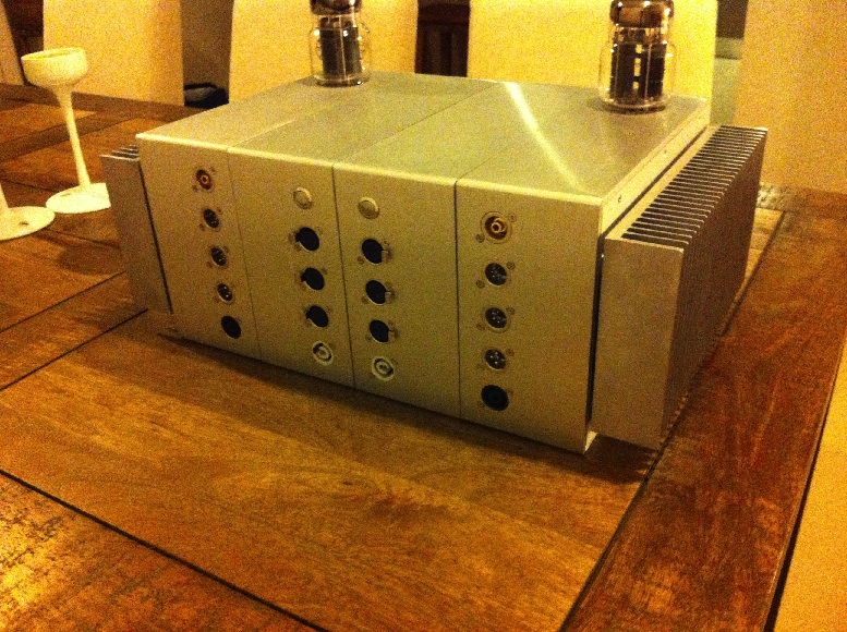

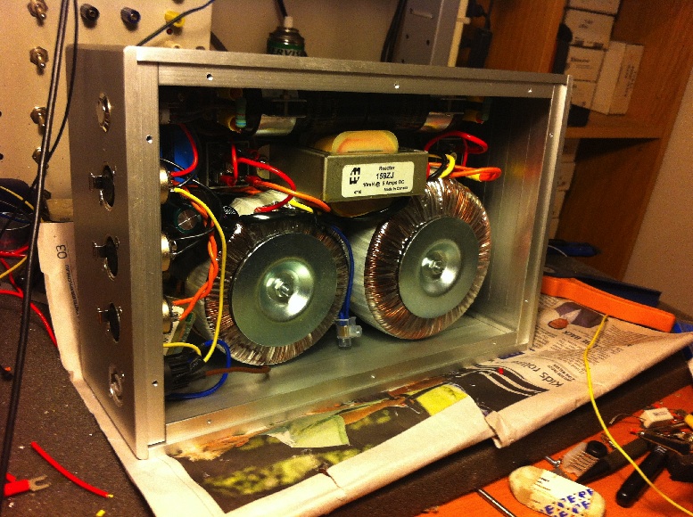

My Zeus completed
It took a while to complete it but finally it's done. I built all the transformers. I designed and built the interstage transformer as well.
In this version I included the single ended driver (or line stage).
Mosfet used are IXTH20N50D. I used an electronic choke for the tube. The other choke is for the second DC rail for mosfets.

Awesome!!!
This is really awesome...
Thank you for posting the pictures. I like the way you have packaged everything together.
Now of course is the $1,000,000 question, how does it sound?
Best wishes,
Susan.

Residual Noise
When you tested the line stage did you have the same issue with the heater? Did you resolve the issue with grounding the centre tap?
The 6c33c is self biased with the transformer own DC resistance. The current was 285mA with brand new tube. I just let the system break in for a while.
The tube's B+ is 37V and the residual ripple is about 2mV p-p that becomes 20mV at the gates. That is probably enough to hear it?
The negative of the two DC rails are joint inside the amplifier case and not in the power supply case.
The line stage transformer output and the input transformer are connected in single end. If I connect them in balanced the noise figure goes up. In balance mode the centre tap of the line stage transformer is grounded. Now both transformer are grounded at one end. That gives me a little more extension in HF because it reduces interwinding capacitance: inside the transformer the ground points are at the same starting point of the primary and secondary.

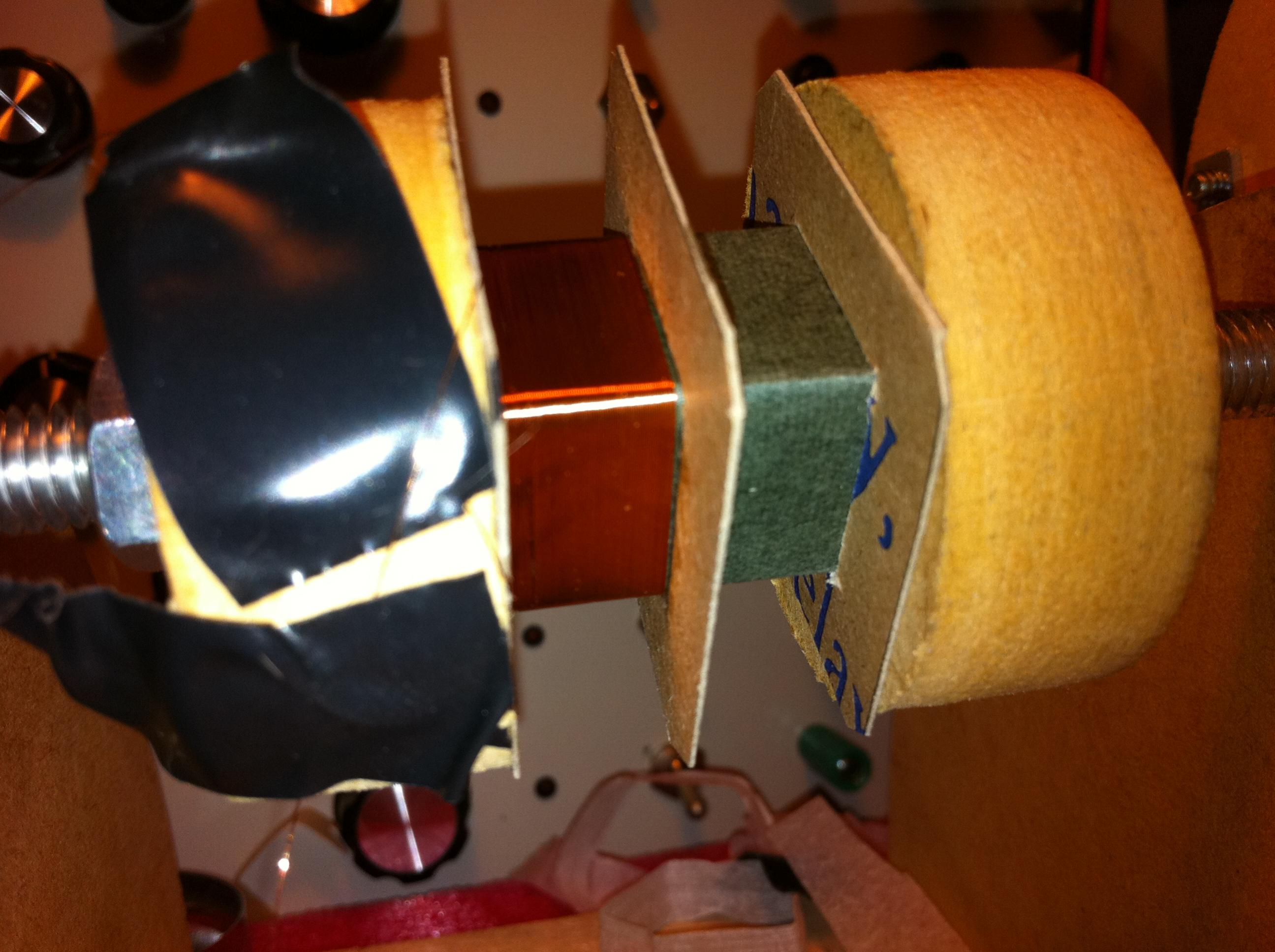

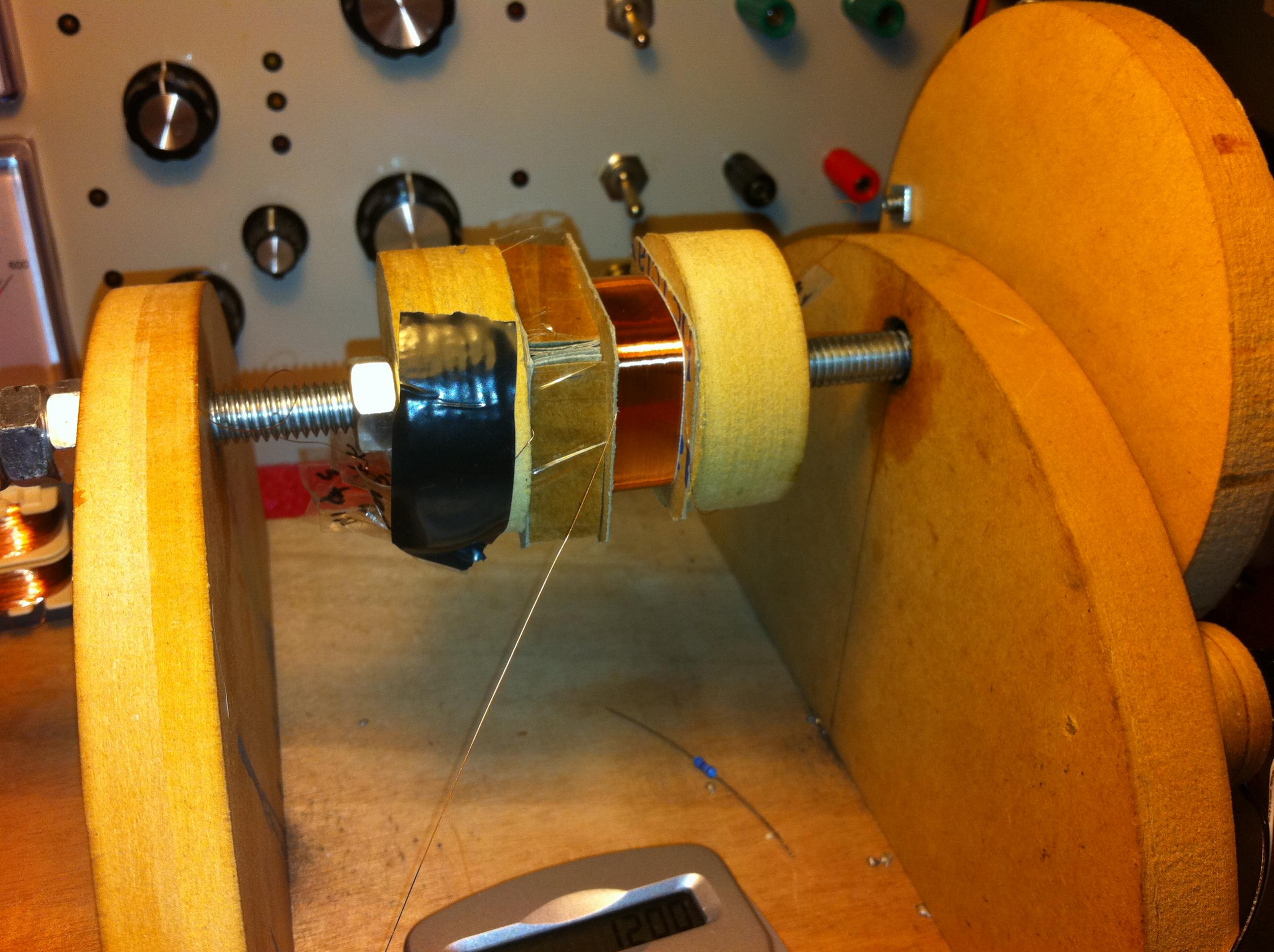

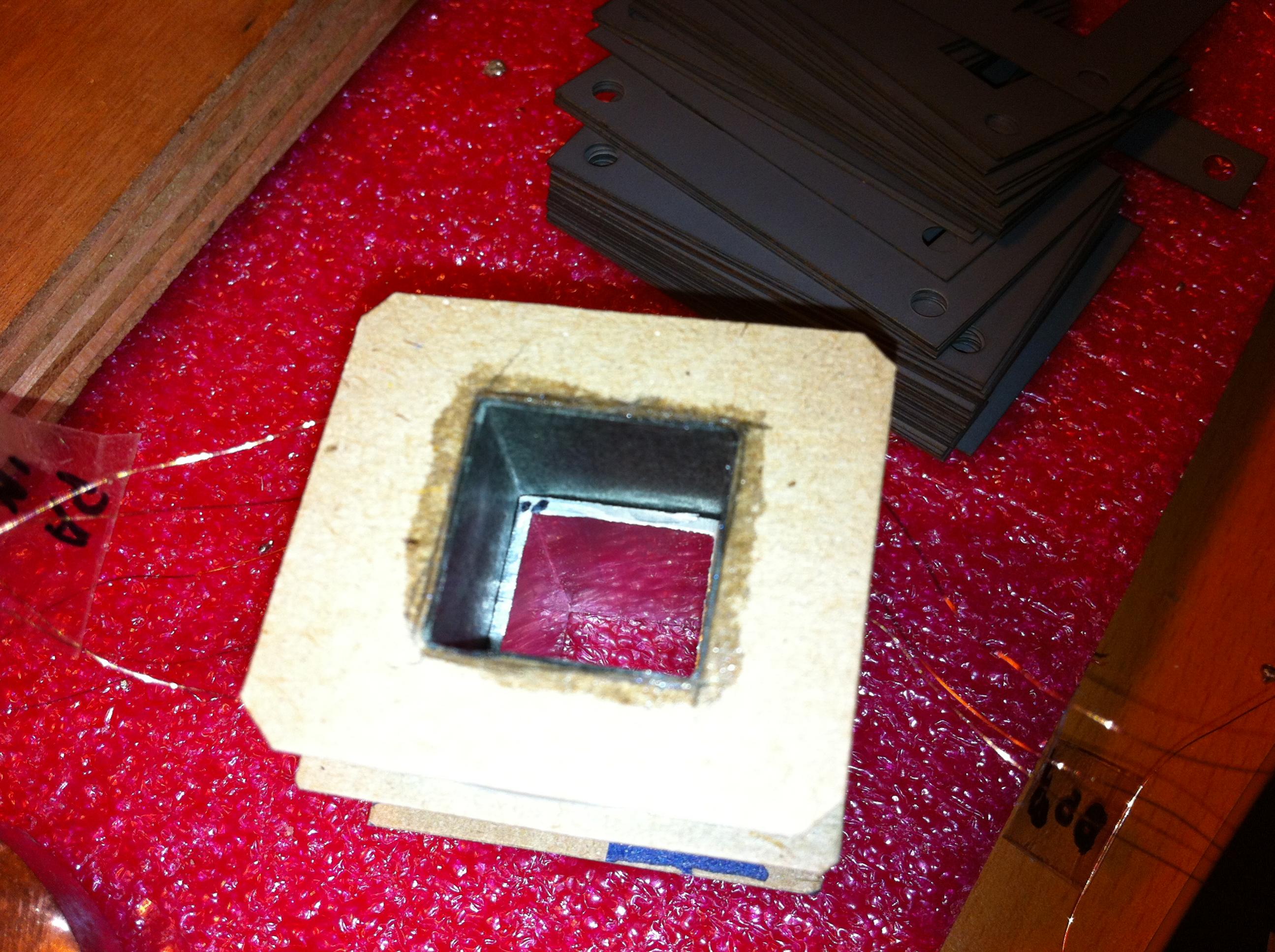

Interstage transformer
That's my winding machine built from scrap wood. The counter is a $2 calculator connected to a switch on the wheel.
The wire is connected to the = button. So just press 1+ and then the = pulse will increment by one. If you mess up you can do 1- and counts backwards. Hahaha
Second attempt of making the transformer. I made the bobbin in paper which is better then plastic. Unfortunately after 2 weeks of work the winding arrangement did not give best performance.
The winding looks quite good, congratulations. What material you are using for winding insulation, what cores ...?
When I was testing I used an AC heater supply, with the centre of the tube to ground.
However I was using my bench PSU for the HV B+ (although at 37 volts the term HV is perhaps a bit of a misnomer in this case).
My testing found that the 6C33C tubes were not happy above about 300mA, getting much noisier (not sure what the B+ was at that point though).
Perhaps you can use the 37 volts with a low drop out regulator down to say 34 volts and see if that sort the issue.
I would be thinking of running the 6C33C at around 250 mA. However my testing was a while ago so I really need to have another look at this.
Also I have the secondary of the SE line driver transformer switched with a reed relay that is opened when volume is muted to removed any turn on/off thumps. Not sure if you need this in your set-up as the power supplies are all together.
As filament supply i'd recommend to try out unregulated dc as well (use small 3mH inductors in positive and negative rail).
Thanks. The material of the former was insulating paper for transformer and the side wings and central divider hmmm a nice natural paper from a cereal box.
