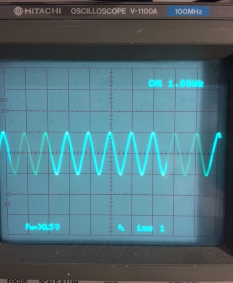

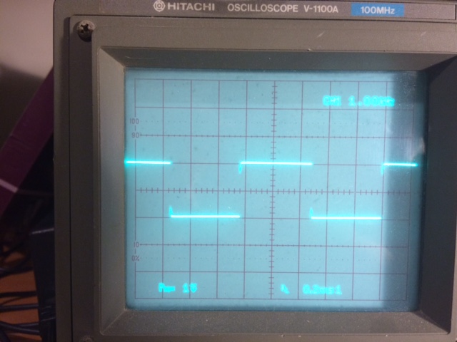

Hi Susan,
Happy new year.
I am still looking in detail for a way to improve the SNR. I got a question regarding the SE transformer. You mentioned about the quad-filar winding on each section of the former.
I found the best result only configuring SE in : SE out. Any attempt to configure SE-PP and I have lots of ringing and low bandwidth.
Here are the 16 wires out of the transformer: (S)tart (E)nd
S1A S2A S3A S4A -- -- E1A E2A E3A E4A
S1B S2B S3B S4B -- -- E1B E2B E3B E4B
To take advantage of the capacitance I connected the winding in series in PSPS as follow:
GND—(E1B-S1B)—(E3B-S3B)—(E1A-S1A)—(E3A-S3A)—Source or K
GND—(E2B-S2B)—(E4B-S4B)—(E2A-S2A)—(E4A-S4A)—Out
This configuration gives perfect square wave with no ringing even unloaded and frequency response of this stage flat up to 700KHz.
The distortion also is very low.

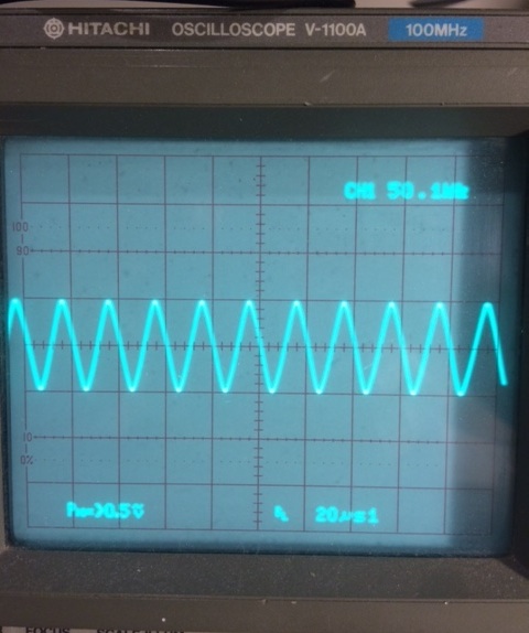

Also with regards to the large input gate capacitance of the power stage which is 2500pF, assuming I am using 6c33c with S=40mA/V in cathode follower I have 1/S -> 25 Ohm output impedance. This impedance, excluding losses, is reflected at the gates of the power stage, on the secondary of the 1:10+10 step up transformer as 2500Ohm.
The current available also is around 30mA for the gates when 6c33c is at 300mA.
Driving 2500pF gates with 2500Ohm impedance would give the power stage frequency response up to around 23KHz according to RC formula.
I also checked with the scope and the predicted rolloff is correct.
Are you having different results?

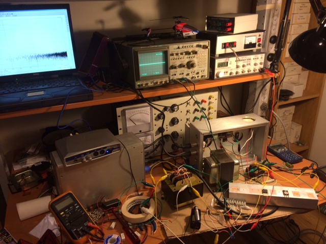

I'm finally getting some results (my ears are still ringing from the noise of the transformer ((0__0 )))
2SK1058 Mosfet SE:SE Line driver 300mA to SE😛P input power stage. Yes I built the 1:10 TX with winding optimised for SE connection.
The line stage transformer has 2 parallel P and 2 parallel S in series with the other 2 parallel pairs on the other half.
GND—(E1B-S1B)—(E1A-S1A)—Source
GND—(E2B-S2B)—(E2A-S2A)—Source
GND—(E3B-S3B)—(E3A-S3A)—Out
GND—(E4B-S4B)—(E4A-S4A)—Out
Tomorrow I will try 1324 instead of 1234
The 1:10 input TX does not like PP input unfortunately. The 4P parallel and 4S series worked on the line stage but caused lots of ringing on my 1:10TX so I have no choice but to connect in SE.
Vgs bias with floating 1.5V battery V adjusted for 300mA just for testing and added 6800pF capacitor (at hand) between G and S to stop oscillating.
I attached pictures of 1KHz Square, 50KHz Sine and 1KHz Sine. There is little difference in amplitude between 1KHz and 50KHz....... and my messy bench.

Hi there,
Thanks for the further info. Glad to hear progress and the pics.
Your bench is tidier than mine!
Best,
Susan.
