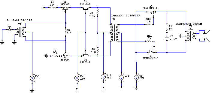

Hi Susan,
I think you will be glad to know that somebody else
design and built SS transformer coupled amplifiers.
Output transformer is custom BARTOLUCCI DOUBLE C CORE:
nominal power: 100w rms
primery impedance: 32ohms
primery inductance: 510mH
secondary impedance: 4-8-16ohms
primery DC resistence: 1.116ohms
frequency response: 10Hz-100kHz
weight: 20 kG
Input and interstage transformer is Lundahl LL1676
and LL1660/PP.
Power transformer and chokes is BARTOLUCCI custom.
Amplifier is class A-2.5A DC current in primery.
schematic:

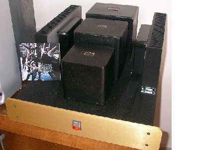

Hi Rozak,
Thank you for your post and the images.
It is nice to know that one is not totally alone in the world 🙂
Things sure have moved on in the ten or so years since my original efforts. Even though the Internet did exist at the time it was BG (before Google) and information was scarce and difficult to find even if it was on there somewhere.
BTW Is this a DIY or a commercial amp?
weight: 20 kG
Some beast. Even with being a monoblock I doubt that I could physically lift the amplifier with all that iron.
That 20 kilos is to get 100 Watts at 10 Hz. Sometimes size does matter 🙂
and LL1660/PP.
[/B]
Very nice.
One can but one doesn't have to run at such large bias levels as the push-pull follower configuration does not come out of class A even at higher powers (i.e. there is not as such the AB crossover switching distortion).
I assume there is one output device per heatsink? If so in practice this is not a good idea as the two mosfets should be thermally linked. Even with matching there will be some discrepancy and the mosfets won't otherwise track with temperature.
Any performance figures?
Best wishes,
Susan.

Hi Graham, Susan.
Graham,
Transformer made in Italy by Bartolucci Giuseppe & Co
http://www.audiomarketing.net/bartolucci.htm
Price is 614 euro for 2 pieces.
100W rms is overkill. Amplifier output power is 25W rms-8ohms but sounds loud on few watt, exactly like tube amplifier.
This is the reason why I use this topology.
Sound come not just from follower but from VAS too.
I know. I built preamp with VAS only.
My previous version,no feedback OPTless , is very good amp
but not like this one.
Susan,
This is DIY amplifier.
Maximum current in class A is
BIAS x Turns Ratio.
My follower can give 2.5A x 2 = 5A in class A.
You rigth. Mosfets is not thermally linked but local
DC feedback help. 12 hours of bias measuring show very

with my concept schematic:
It took me a while to get it together but here is my breadboard Zeus 6C33C Triode Line Driver 🙂

Some thought on the MOSFET Zeus line driver...
The main purpose of the Zeus line driver is to provide a way to drive the 600ohm input of a Zeus power amp, or any other real 600ohm load. However, if you use a high-impeadance input transformer, you get little to no voltage gain out of the line driver as it currently exists...
It occurs to me that for the power amp, we're loading the output stage with a 32ohm load source-to-source (2:1 stepdown, 8ohm speakers). What about using a stepup output transformer? Assuming the same 32ohm s2s load, that's a 4.3:1 stepup. Even is we went with a 2:1 stepup on the output (which should lower the distortion vs the 4.3:1 stepup) that'd be a help, and easier to wind, the (semi)normal quadfilar output transformer with half-way taps on the secondaries could be wired for a 2:1 stepup of you ran it backwards...
Susan, any thoughts?
Peace
Hi Susan,
Yes the bipolar circuit I am working on is similar to the Mosfet one suggested above, but current stabilisation with rail voltage and temperature variation is much less easy to organise.
Nice work with the 6C33Cs.
With your high quality input step-up transformer this gets back to a more idealistic input loading, however the output current is diminished.
Maybe this is where a power bipolar might now be correctly introduced;-
Insert 150 ohms in series with the triode anode.*
Insert 4.7 ohms in series with the triode cathode.*
( * - suggested values off the top of my head.)
Connect power NPN base to cathode.
Connect power NPN emitter to output transformer.
Connect power NPN collector to suitable power ht rail.
Connect 2,200uF bootstrap between NPN emitter and triode anode.
Adjust 4.7 ohms value for suitable quiescent current, say 1 amp.
For very high output power, NPNs may be paralleled with separate low value emitter resistors.
As both anode and cathode would here be made to 'follow' grid potential, maybe the separate low impedance pre-amp might no longer be needed!
Also, if the topology sounds good, then cathode resistor readjustment with the heater voltage reduced by say 10% could make the triode vitually 'everlasting'.
Cheers ........... Graham.
