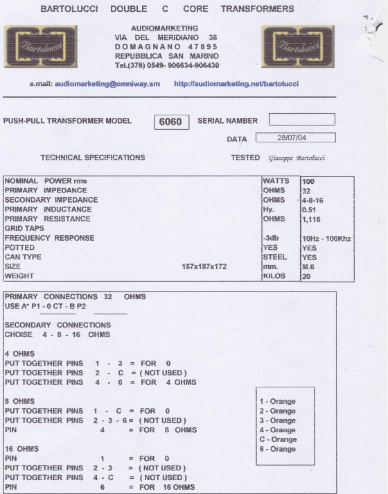

Hi Mike,
Maybe I should re-qualify my class-AB wording above.
Susan's and Rozak's output stages first operate fully in class-A for normal listening levels, and the gradual drift into class-AB at higher output powers is observable via the gentle lift in distortion shown in Susan's measurements earlier in this column.
This is not like the sudden bias set shift from 'A to 'AB in a bipolar output stage which causes a sudden increase in distortion.
I enquired further about the Bartolucci output transformer and Audiomarketing state that a 5% bias offset can be tolerated, though they did not state what nominally designed bias current is intended. Also that it is a Premium Double C core, has seven split and interleaved winding layers, plus a layered secondary combination.
A 20kg transformer must be good for more than 100W; or does a premium core saturate more sharply ?
20kg is often the checked in baggage limit for budget air travellers these days, so it is little wonder that carriage for two pieces to the UK is 150 Euros. Ouch!
Cheers ........... Graham.

Hi All,
Way back at the beginning of this thread I stated that I did not like output transformers.
My reason being that I have heard the individual effects upon reproduction due to insufficient winding inductance, winding capacitance, copper losses, and poor interleaving technique, which NFB cannot fully counter in a tube amplifier design without introducing more (phase shift related) problems.
In another thread Lumanauw is discussing passband phase change at audio frequencies, which is something I have for long now attempted to minimise in directly coupled NFB amplifier circuitry.
Rozak has above informed us of his choice for the Bartolucci 6060 transformer. This has a primary inductance circa 0.5 Henry which equates to a 32 ohm impedance at 10Hz, and is the same as the transformed load impedance.
Bartolucci quote a -3dB response of 10Hz to 100kHz. Correct.
The phase shift at a -3dB turnover is demonstrable as being 45 degrees, and I know for sure that I would be able to hear that after my experiences with a variable bass phase shifter where reproduction sounds as if correct only when the phase is true down to (and below for the likes of kick drums and auditorium ambience) the lower limit of human hearing.
So how can Rozak be satisfied ?
Also, how come Susan was amazed at how low in frequency her amplifier reproduced when the 'output transformer' was no more than an air cored 100 meter roll of cable.
Susan will recall the inductance figure better than I can ( 4mH? and was it screened twin? )
The reason only came to me this afternoon when thinking about my own version, and it is down to the driving impedance of the output stage as compared to those of the common source/emitter ouput stage requirements normally envisioned.
Assuming as little as an easy 20dB damping factor from these 'follower' designs, the Bartolucci output transformer will achieve a -3dB turnover of *1Hz*, with the phase shift at 20Hz being an inaudible 2.6 degrees for low level listening. Audio type Mosfets actually manage circa 30dB of damping, whereupon the associated figures of -3dB at approx 0.35Hz and just one degree of phase shift at 20Hz could be realised !!!!! Clearly the psu will be the limiting factor when there is low frequency input.
Similar improvements will arise at the higher frequency end, and boy do I feel dumb for not realising all this before.
So Susan, a well made output transformer does not render your's and Rozak's designs inferior, in fact with their isolation capabilities, allowance of common grounding and unfussiness in relation to PSUs - their utilisation within a 'follower' output stage does actually lead to improved reproduction.
Thanks for keeping going long enough for me to wake up !!!!!
Rozak, your system might go so low that the bass cone could 'breathe' due to unavoidable analogue-digital-analogue conversion techniques.

Hi Graham,
Thank you for your posts.
I am not sure what they consider to be a premium core but I was looking at microcrystaline split C cores from MK Magnetics in the USA.
Looking back at my correspondence I wrote:
Assuming I have my figures correct...
M6 has a saturation flux density of about 20,000 Gauss
Nanocrystalline has a saturation flux density of 12,300 Gauss.
So I would need to increase the core size from 3 sq in to 4.88 sq in. This translates to the next size bobbin which is an imperial size type 638 x 2.5", with a bit over 5.25 sq in cross section. However checking I see that 2-5/8" is available from several places, but 2-1/2" only from one. So I guess an extra bit of depth here.
2-1/8" EI Laminations have two apertures of 3-3/16" by 1-1/16" with 1-1/16" limb widths.
So each C core is 1-1/16" thick and should have a finished width of just under 2-5/8", see pdf link below.
Imperial 683 bobbin http://www.miles-platts.com/pdf/l05110.pdf
N.B. The bobbin center hole is specified as being 2.625" wide from the other supplier.
After my initial inquiry it went quite, perhaps my prospective order (test out for one pair of transformers) wasn't big enough?
I work on 20 Hz minimum at full power (I believe in having a separate speaker/amp for low bass). For 10Hz one doubles the core size (and weight). Then with the premium material increase the size all round for the lower unit cross section core saturation. Then add a full steel box. Easy to see how the weight adds up.
This is a big problem. A pair of Zeus 75 output transformers in a box weighs about 10 kg. Overseas shipping from the UK can be up to UKP 100 (or more). I can make to sell these transformers starting at UKP 95 each (plus packaging costs and VAT (17.5%) for EU countries), but shipping is just so horrendous I can't see it being viable.
Sowter, as they ship large amounts, will undoubtedly have a contract with a shipping agent and I imagine should have at least a 1/4 to 1/3 off the standard one off shipping charges that I would pay.
Best wishes,
Susan.
