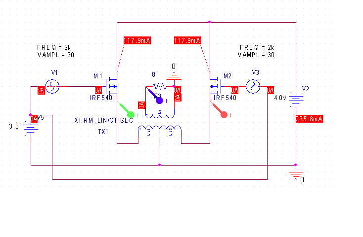

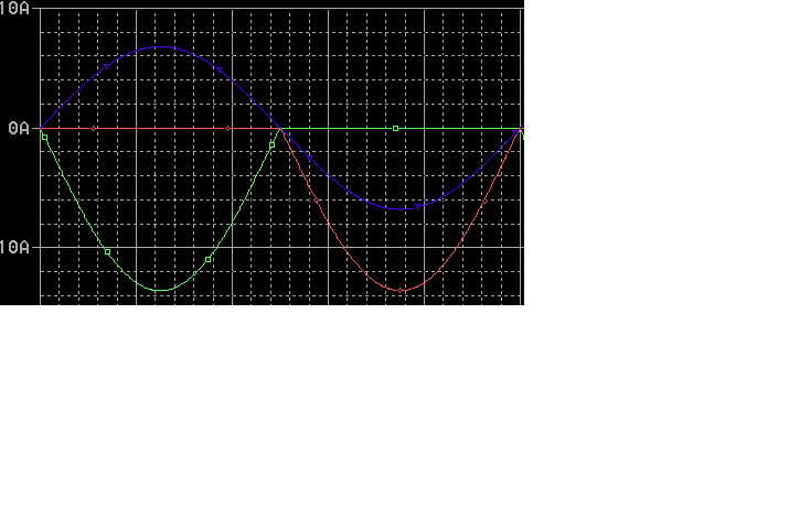

Hi Susan,
Further findings/observations.
Above I have written that your output stage operates like a class-AB.
That is close, but *not correct*.
My simulations are showing that your output stage does not actually drop out of class-A, and thus there is never any 'crossover'.
This, with fractional output transformer resistance (impedance) and no propagation delayed global NFB, means that a dynamic loudspeaker cannot cause the output devices to reverse commutate through any portion of their fixed bias potential, as can happen in a conventional amplifier before the delayed NFB establishes accurate output potential correction.
The 'follower' output halves can be biased to behave near exponentially, and thus operate optimally in an approximate 'difference of two squares' or 'd2s' push-pull arrangement.
Your biasing is but a fraction of the current requirement for conventional class-A quality reproduction.
This situation arises because the bias potential and the local voltage feedback encompass both the output device and the load on a per-half basis.
Where the bias and feedback are derived prior to the load, as with 'conventional' solid state amplifiers, then the output devices cannot maintain on-going conduction unless operated in class-A.
Thus the 'follower' output stage can run in class-A with as little as 100mA of quiescent output bias, but the transconductance characteristics might then not be sufficiently well matched for optimal 'd2s' operation.
The output transformer is an essential part of this, for distortion and error correction arising in one output half cannot jointly interfere with input drive to the other, nor can it coincidentally interact at a co-connected output biasing network, as does happen with 'conventional' global NFB/ differential input amplifier circuitry !!!!!
(This can also happen in complementary class-A amplifiers, though not with the JLH.)
My first bipolar amplifier had too low an input impedance with parallel bias circuitry and feedback shunting the input transformer (the current corollary), and thus the transformer was over-loaded at lf and hf. However, the mid range was clean, and reproduction sounded as if the output from each push-pull half was properly 'melting' in with that of its partner, which made me think about the distinctiveness of distortion that intrudes upon our experience in 'conventional' NFB amplifiers, with their tiny high frequency 'per-half' differences.
My next test circuit is having the input transformer in series with input base bias, also with the series feedback at the first emitters wrt the output transformer centre-tap (as per your Mosfets). I shall also have 'follower' driver and output devices on a 'per-half' basis bootstrapping the input transistor, with a quiescent current of about 250mA per half to approximate 'd2s' operation.
Over the next few days I am hoping to hear not just 'liquid' mid range, but all of the bass and treble 'melting' together; the audio equivalent of chocolate ?

Hi Terry,
I have picked a Mosfet at random. See illustration.
Often the increase in current with increasing voltage is greater then the decrease with an equal but opposite amplitude variation..
As you say both inputs are equal and opposite, and the more conducting half drives the other oppositely, but that does not mean that the more inactive device becomes cut off prior to overloading non-linearity, which is non-latching and without additional reactive NFB loop generated error.
I have simulated bipolar circuits similarly. They can be made to not cut off, or be allowed to do so.
*Thanks Roscoe.

Graham: what's the bias current in your simulation? What will happen if you dial it back to like 100ma?

Peace or Graham: since the circuit is so easy to simulate, maybe you can show the current going through the upper MOSFET assuming the following:
a) rail of 40vdc;
b) bias of 100ma;
c) driven by a 30vpp sine signal at the gate of the MOSFET.
Will the upper MOSFET shut off during at least part of the cycle?

rozak said:simulation
is this class A or class B (or AB if you prefer)?
