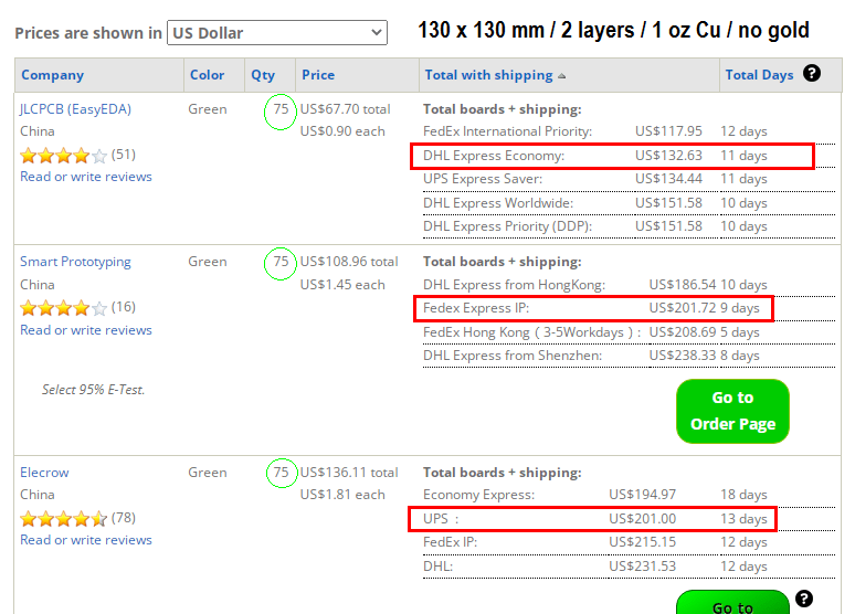

Suppose for a moment that you were Nelson Pass, and you were about to order final PCBs for the Build Camp that takes place in 30 days. Each of the 25 builders needs 2 boards, plus you want some spares in case of loss or damage, so you decide you need to order at least 75 PCBs, and you need them in your hands in 25 days or less.
What would you do? How paranoid would you be? Remember that if you don't get 75 PCBs in time for Build Camp, the attendees' fun is ruined. Would you take any precautions against fab delays, shipping delays, lost parcels, damaged parcels, union strikes?
What would you do?
If I were Nelson Pass, I would decide to be somewhat paranoid. I would pay $202 for what amounts to an insurance policy. I'd order 75 PCBs from the fab called JLCPCB, choosing DHL express economy for shipping. Then I'd also order another 75 PCBs from another fab, the one called Smart Prototyping. To protect against a union strike or a warehouse fire at DHL, I'd select Federal Express IP shipping from the second fab. The extra cost of double-ordering is $202, and is completely unnecessary if everything proceeds normally. But, if something does go wrong, I have a second chance to get 75 boards in time for Build Camp, and that second chance costs me only $202. The extra boards don't go to waste, I can always put them in the diyAudio Store after Build Camp is over. However, I don't think I would take the bat-shite insane paranoia route of triple ordering, from yet a third fab (Elecrow) and yet a third freight company (UPS). But that's just me; what would you do?
price quotes from www.pcbshopper.com ; board size estimate obtained by rectal extraction
What would you do?
My order of 100 boards for the first version arrived in about a week from PCBWAY. However I made some
improvements and I want perfection so I made some small changes and ordered a new batch.
I did not throw away the older boards, so I think we'll be OK....
