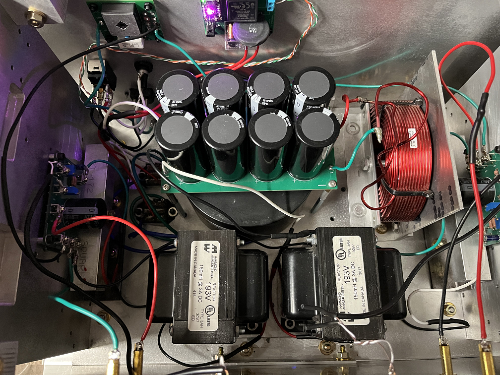

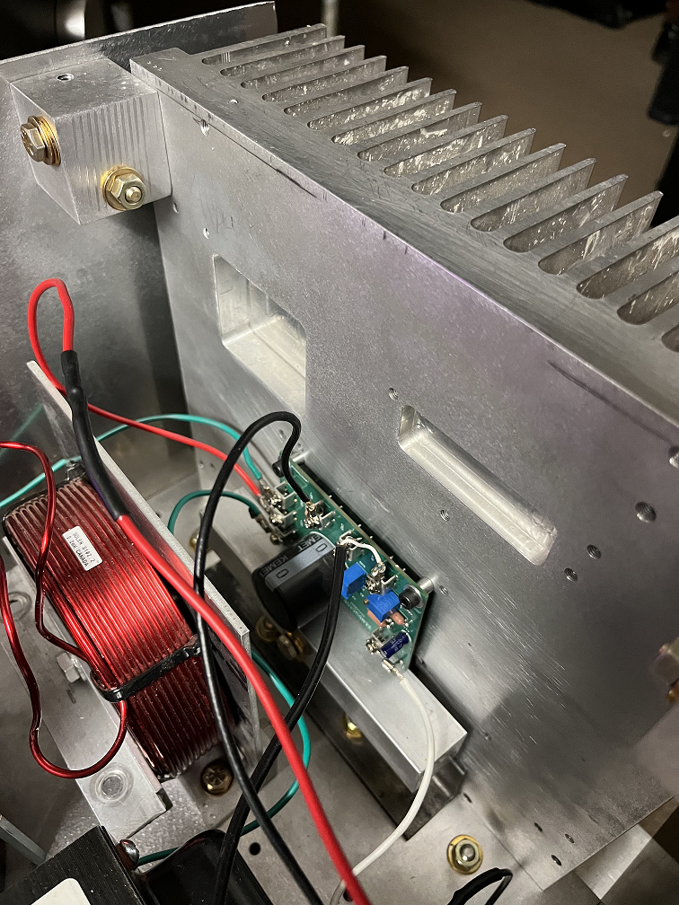

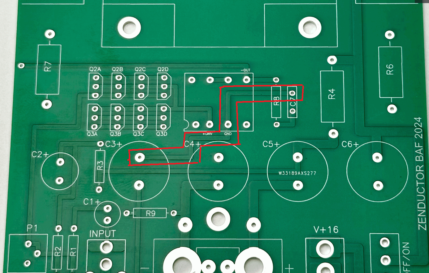

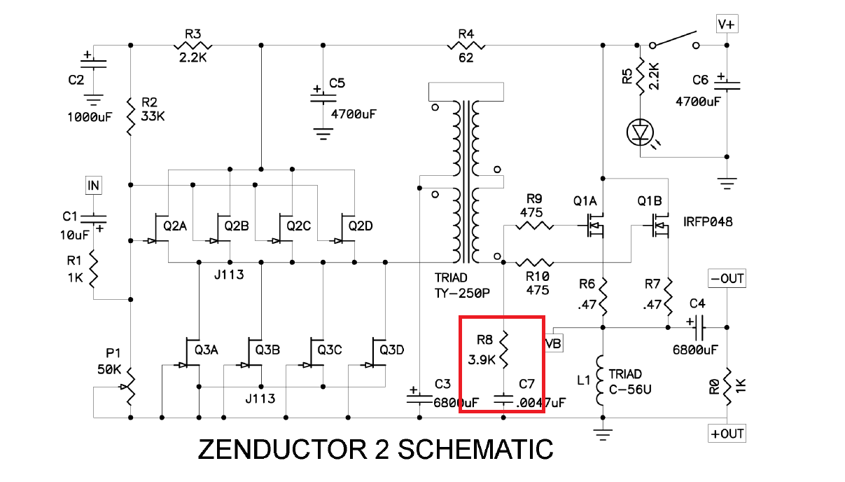

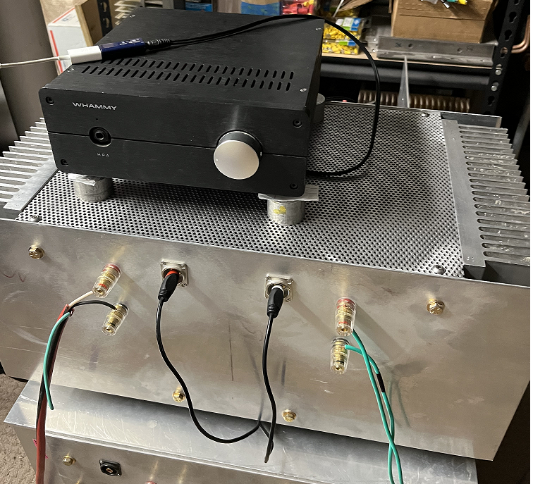

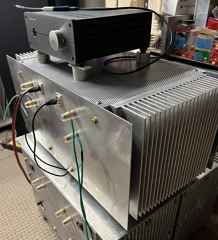

Or....just make it HUUUGE. Take a few months off of DIY audio and it'll take me another few months to catch up. Finished a massive chassis for Zenductor V1, 400VA, 22V, 2.3A bias, used 193V for the inductor. I rolled my own PCBs of course. May have found a discrepancy between schem and board for the new version, as I plan on making it bigger, as usual. Attached are a few pics. It appears the gnd connection of C7 on the schematic does not match the board, on the board it goes to the + of C3...?
Very nice, I’m drooling over that industrial, indestructible unit 👍👍
A fancy looking enclosure is nice to have but given a choice I prefer yours since it looks great and will last ( until your next build 😂).

I think you are right. Electrically it probably doesn't make a difference, 0.047 microFarad in series with 6.8mF is still 0.047microFarad. It's odd that the trace (or transformer pin) is labelled 'GND' on the board, but it is not ground.[...] It appears the gnd connection of C7 on the schematic does not match the board, on the board it goes to the + of C3...?

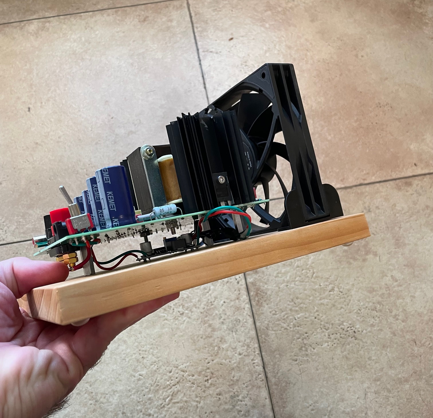

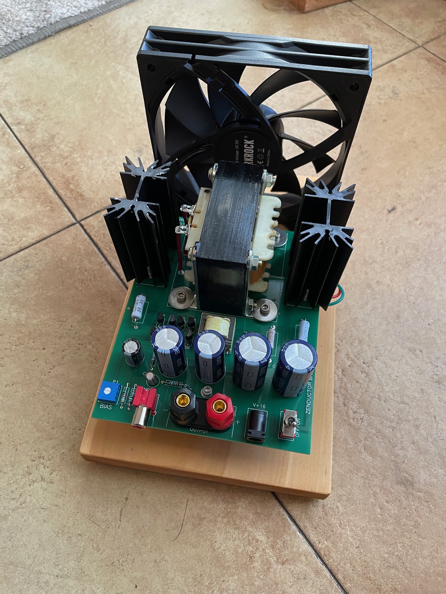

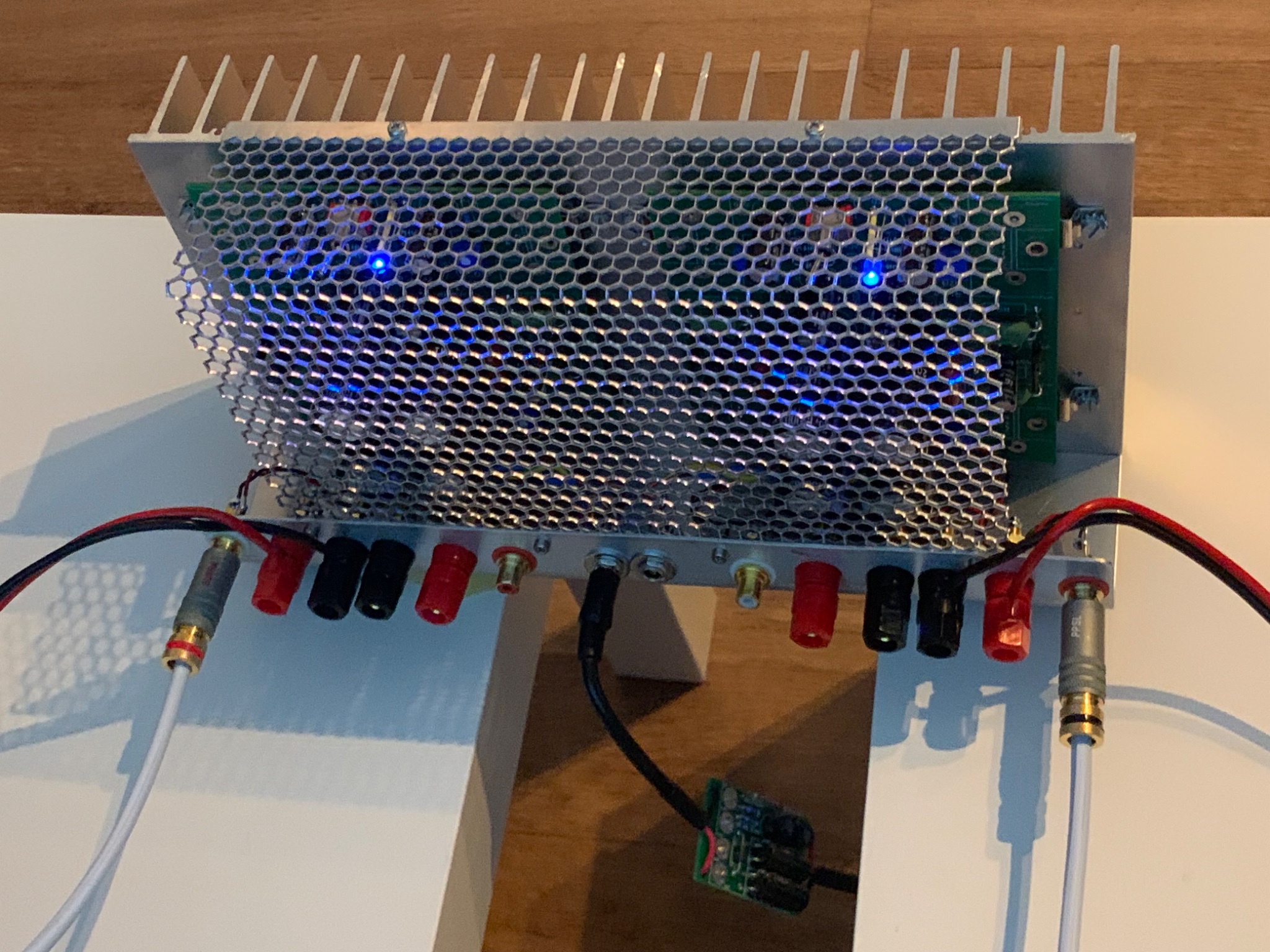

Screwed to a board w/ some sticky button feet, via existing standoffs. I've tapped power just after the switch to feed to a buck converter (fits under the board) to output 6v for the 120 mm fan (nominally a 12v fan). I can't hear the fan unless my ear is < 1 ft from it. I can't hear any fan e-noise coming thru the speakers. Heatsinks are about 125 F (51 c) up near the top, I can find about 140 F (60 c) if I search around to get a reading off the devices or near to them. 1.38 V across the inductor (re-biased). 3D printed a bracket to mount the fan, which was fun, but prob you could manage without (LMK if you want the file).

Mid 50C's on the heat sinks is standard on Pass amps, huh?
My F5M (no fan) runs about the same 125 F (51 c), but that's hottest point on the sinks for the F5M and coolest point for the ZD2.Mid 50C's on the heat sinks is standard on Pass amps, huh?
F5M might be hotter inside the box, while ZD2 has no inside / outside, so maybe not exactly apples-to-apples...
