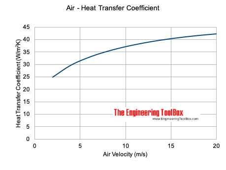

Regarding heat sinks and cooling: It seems from Nelson's and other measurements that the heat sinks as is are dispersing ~12 W (16 V * 1.5A / 2 heatsinks) each at a Delta T of 50°C (or K) (75°C heatsink temp minus 25°C room temperature), so about 4K/W or, since they are about 200 cm^2 or 0.02m^2 (from my measurement of the fin lengths), about 12 W/m^2/K without any forced air flow.
Looking at
with a small fan and air at a few m/s you are not going to gain a factor 5, but more like a factor 2. But that still gets you a significant gain (factor 5?) in transistor lifetime, and also brings the heatsink temperature below the pain threshold, to maybe 50°C.

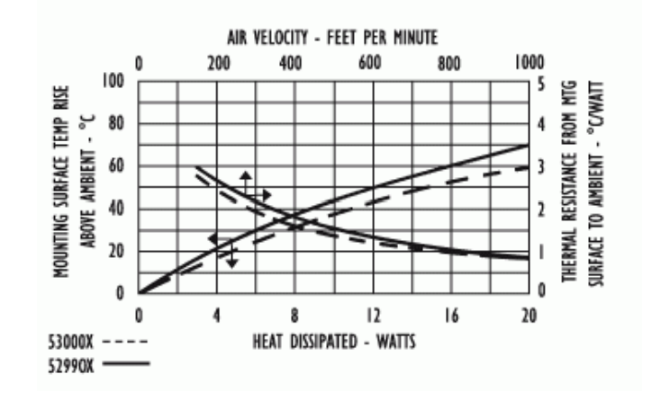

This also seems to be roughly in agreement with this graph
from the heatsink datasheet, at the Mouser link @birdbox provided, where 12 W corresponds to a Delta T of ~45°C (rising dashed curve and lower and left scales), and 200 ft/minute = 1 m/s air speed gets you 2.5°C/W (falling dashed curve and upper and right scales), so 30°C above ambient, or 55°C total, for 12 W.

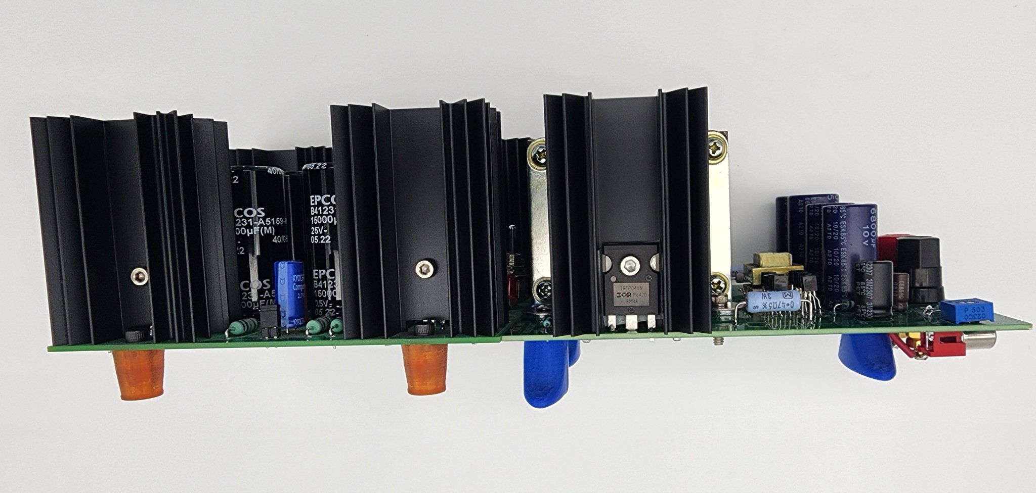

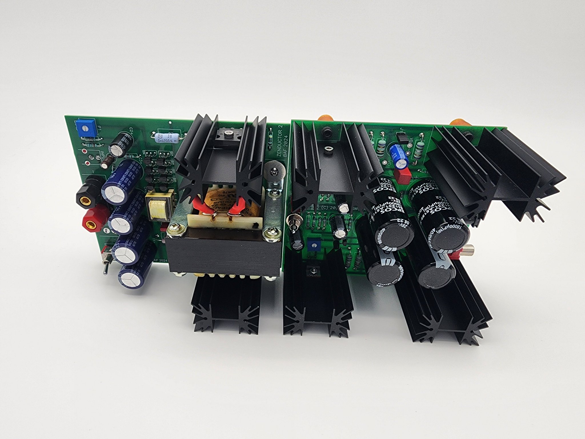

The heat sinks on this amp is looking lot smaller than aca amp. But both amps have similar output mosfets and bias currents .. so do we need to use bigger heatsinks here , at least of the sizes used for aca amp
The heat sinks used on Zenductor II are the same size as the ACA Mini. In fact, it's the very same part as far as I can tell.
If you have little kids and want to keep the temps down a little, I don't think there's anything wrong with stacking on a little more heat sink instead of backing off on the bias for risk mitigation.
ACA Mini on left, Zenductor II on right.
