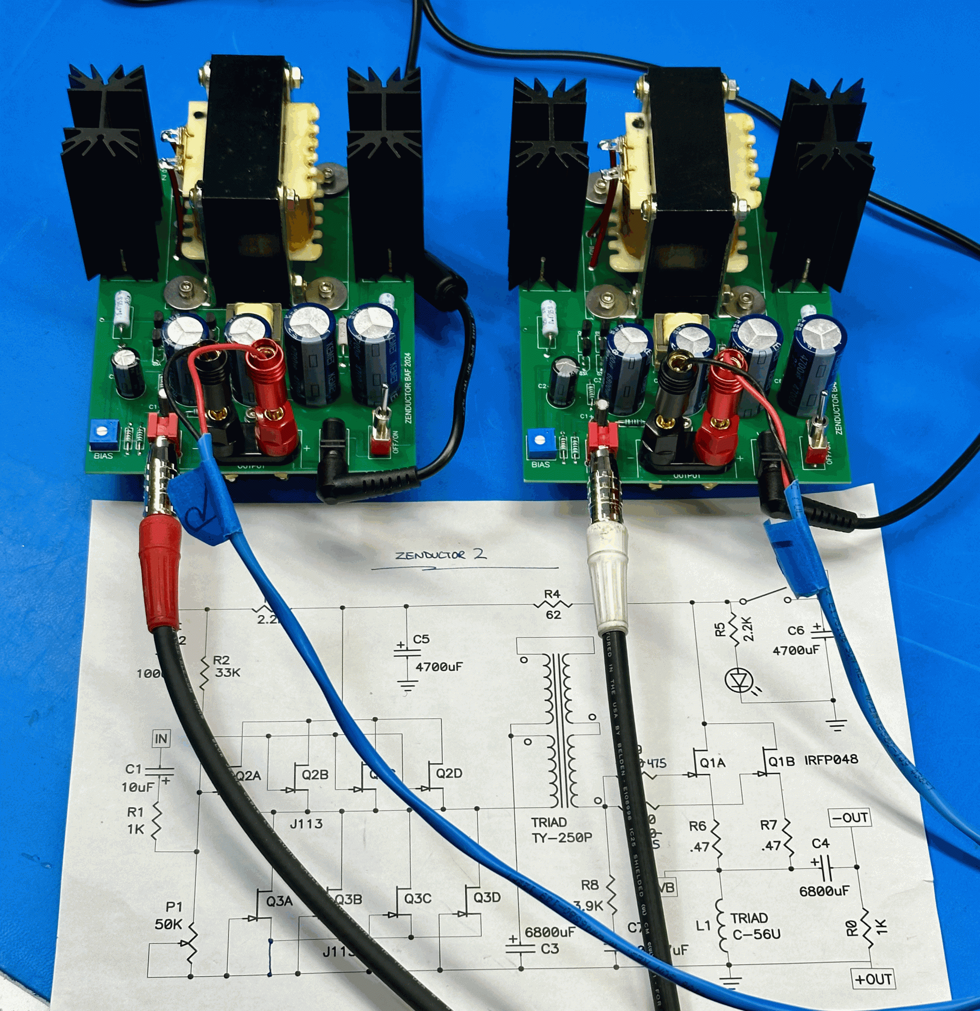

A quick question: I see third harmonic dominance below about 200 Hz. The crossover frequency point between 2nd and 3rd dominance moves a bit with bias.
Is third harmonic increase expected at low frequencies, maybe due to the interstage transformer?
Of course there's always the possibility of user error, but my measurements seem to generally agree between Analog Discovery 2 + Audio Analyzer Suite and Focusrite Scarlett Solo + REW, and also in broad terms with Nelson's overall distortion graphs in the Zenductor 2 note.
