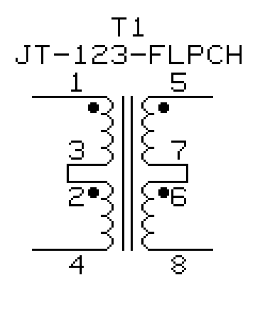

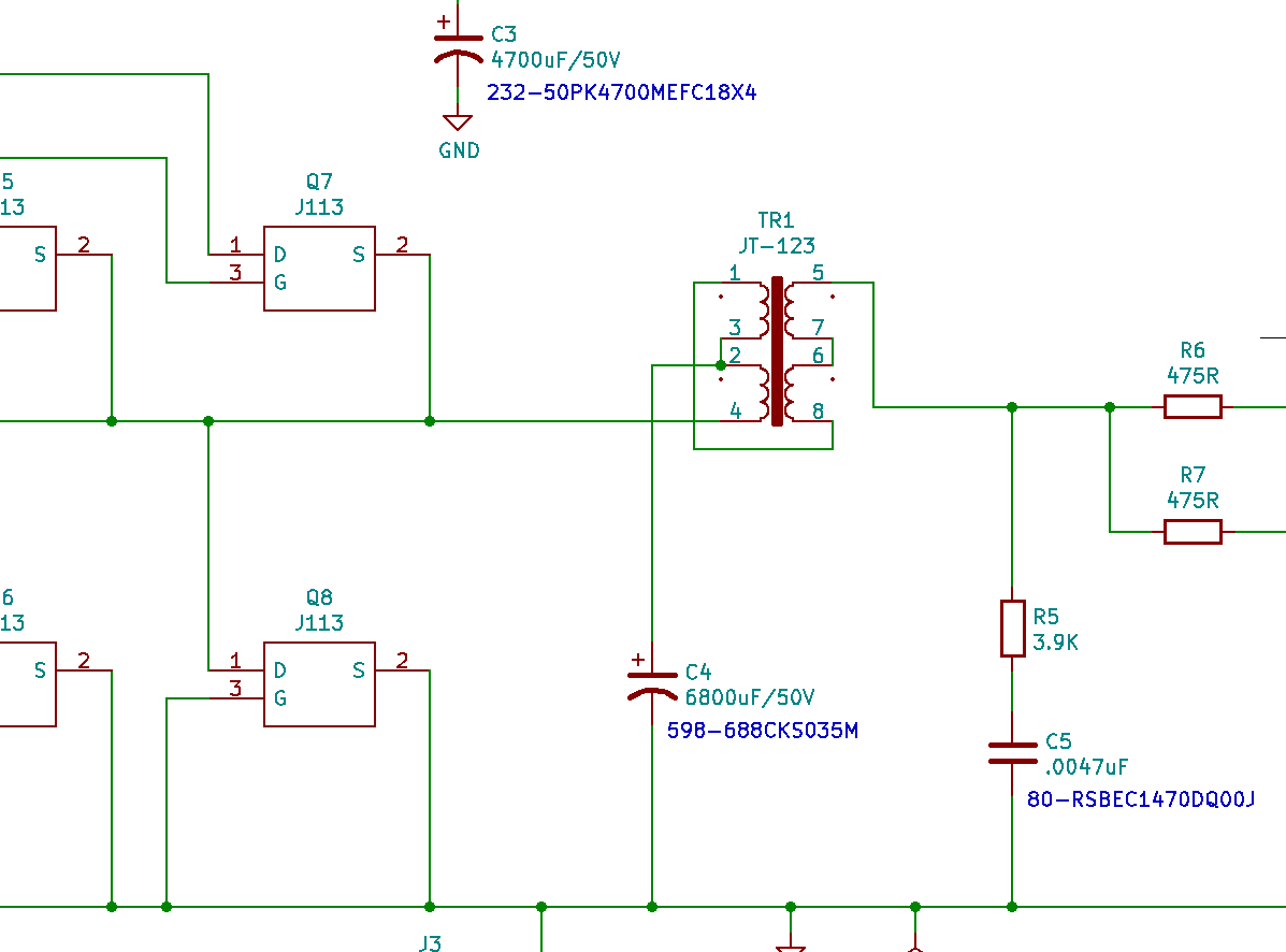

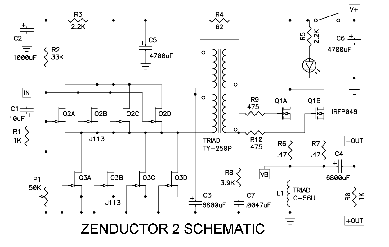

got a chance to listen to NP's BAF talk regarding Zenductor 2, I'm fairly certain we can use the JT-123 FLPCH and get a bit of a perfromance gain. I attached part of my PCB schematic, the JT-123 pinout, and ZENDUCTOR 2 scheme.... just chekcing to see if my transformer connections are correct...?

Why use 8 components when you can use just 2? and because I like customization personally.

`8 instead of 2...'?
Not sure if you are referring to the input jfets, but if so the substitution of 8 instead of two is for cost.
J113s are cheeeap, whereas 2sk170/LSK170 are very much not. Do some shopping. The J113 is not as `good' as the Toshiba/Linear Systems parts, but paralleling four pairs minimises the performance impact of the substitution.

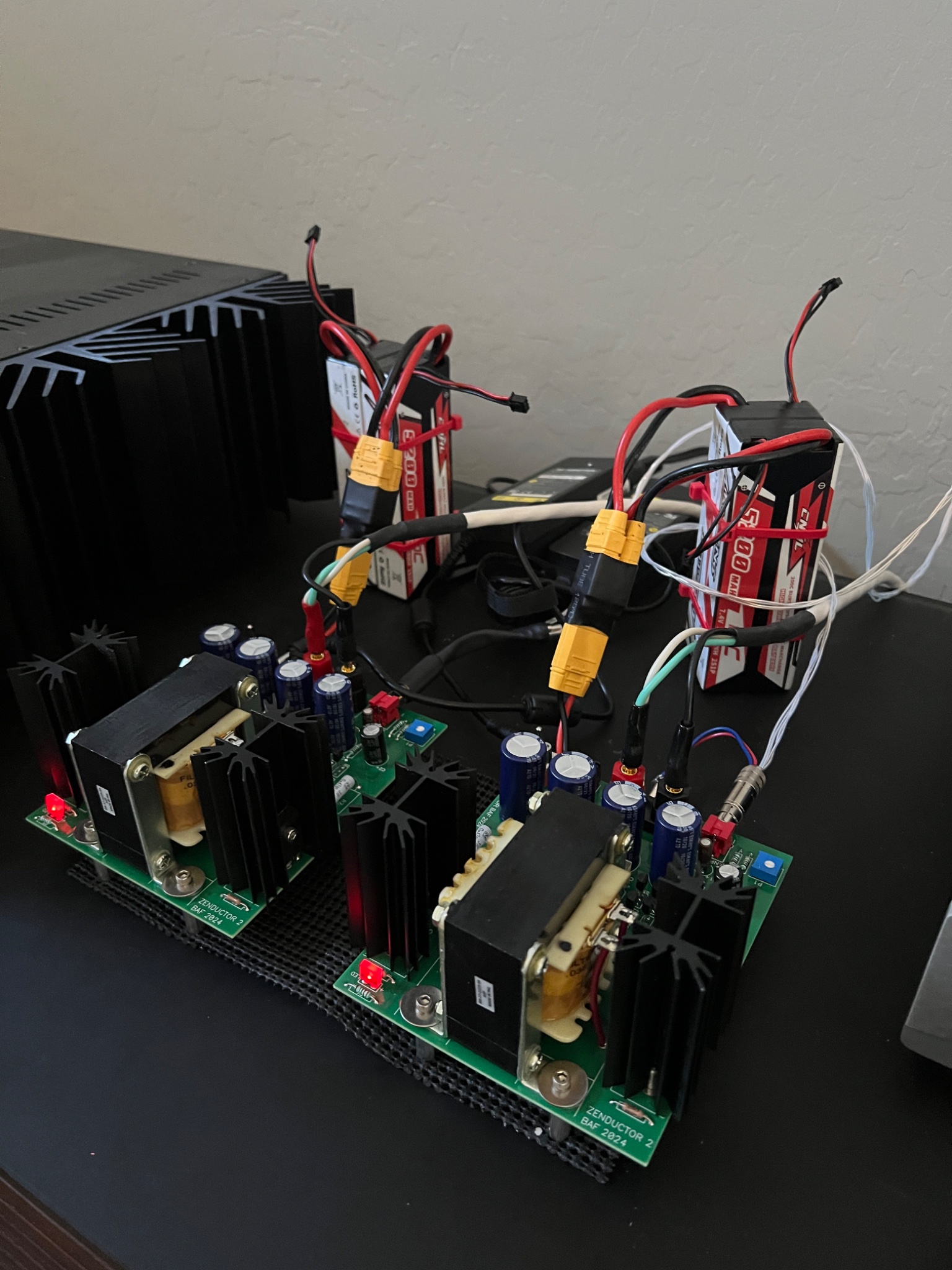

Well, a little birdy sent me a box and we now have the Zenductor 2 running on 2S of 2S1P 5.2Ah packs at 16V at full charge, I’ve run the inductor voltage between 1.2 and 1.5v, and because the lipo discharge rate is so linear it doesn’t change much during listening of about 2 hours of battery run time. The battery power improves an already amazing amp when powered by the 16v bricks.
Characteristically, the lipo power delivers some incredible depth and width to the sound stage, with elements appearing in their own space as if all of the elements are on floating shelfs, being stable, deep, and very separate from the others. Musical elements are just vivid and large with this amp. The batteries just really exploit the strengths of the design and take it beyond. It’s a very enjoyable amp. The bass extension is jaw dropping on battery power, just as it is with the mini. The bricks cannot even come close to the lower octave power and the smoothness on top.
Thank you to Michael R, 6L6, Vincent and of course Papa for removing parts…..it’s a great achievement and gift to the community. I wish everyone could hear this in my listening room. I’ve been building tube and SS for a long time and this one is a masterpiece.

I don’t have a part number but any 4S lipo of at least 2.0A or larger will do to power one amp for about 45min. I just happen to have these large 5.2A 2S packs that I use in series. Lots of affordable 4S lipos available on Amazon or the retailer of your choice.
I have tons of lipos and just relegate old packs for audio use.
