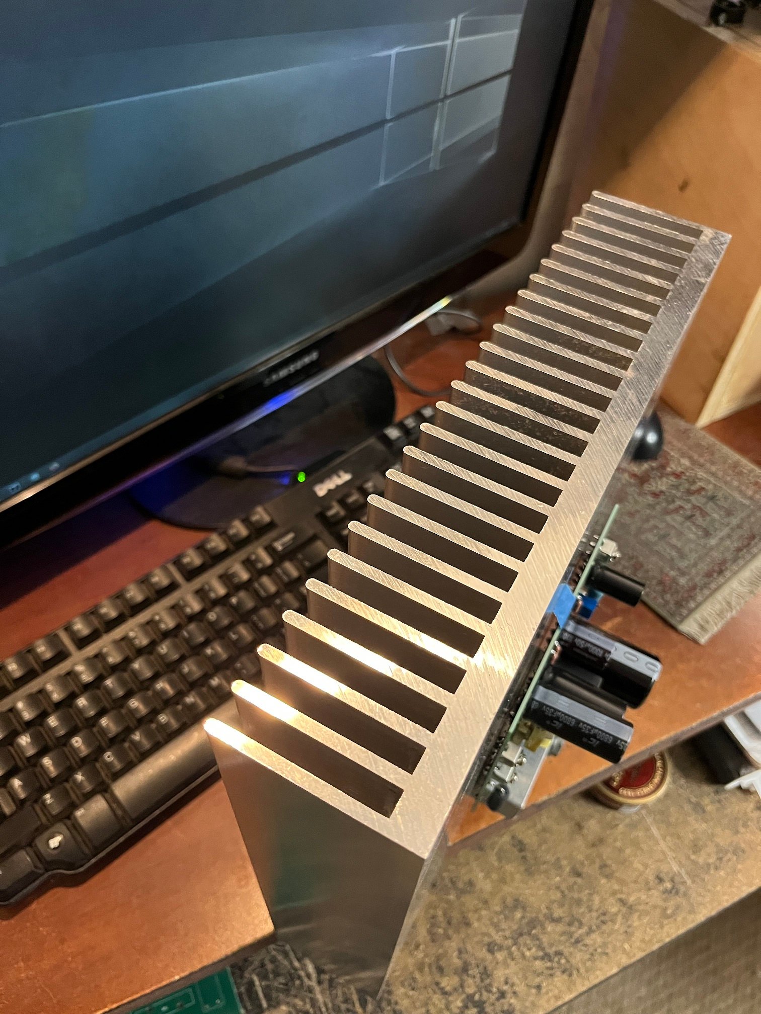

EDIT: with a single layer of heatsinks, in a bias at 1.1 they were running above 65C.. one was in the 70s. When I just stacked ( not glued down nor thermal goo ), the stack temps dropped At a bias of 1.4V, the bottom heatsinks are running in the low 60s and the tops are running in the low 50s. I fully expect the dissipation will be better when I join the heatsinks with goo and glue.
Oh I just received the fan and buck converters from Amazon... the same ones that @AdamThorne is using. I fully expect that I can bring the heat down to the 50s... Because, this is one HOT baby.

I stacked the heatsinks, "high rise" mode. Still not glued/clamped together. No fan.
Room temp is 22C.
High Rise mode for each amp, bias, top/bottom, top/bottom.
Left amp 1.42V, 49/66, 53/68. Right amp 142V, 56/73, 46/57
Single heatsink ( the Pass Toaster mode )
Left 1.45, 78, 79. Right 1.49V, 86, 70.
GULP.... 86C... yep, I checked it.
BTW, the low value on the Right amp is for the op amp that I had put on backwards. I ought to check the soldering to make sure it's OK.
When I returned to High Rise mode, the bias and temps dropped back. I find it interesting that the bias goes up with temps... could this be a runaway issue? Like, if I turned the bias to 1.5 it might just never come back from a Valhalla Immolation. Is there a Valhalla for Zenductors?
IMHO, I could drop the bias or I could add more cooling. I am fearless.. More cooling on the way.

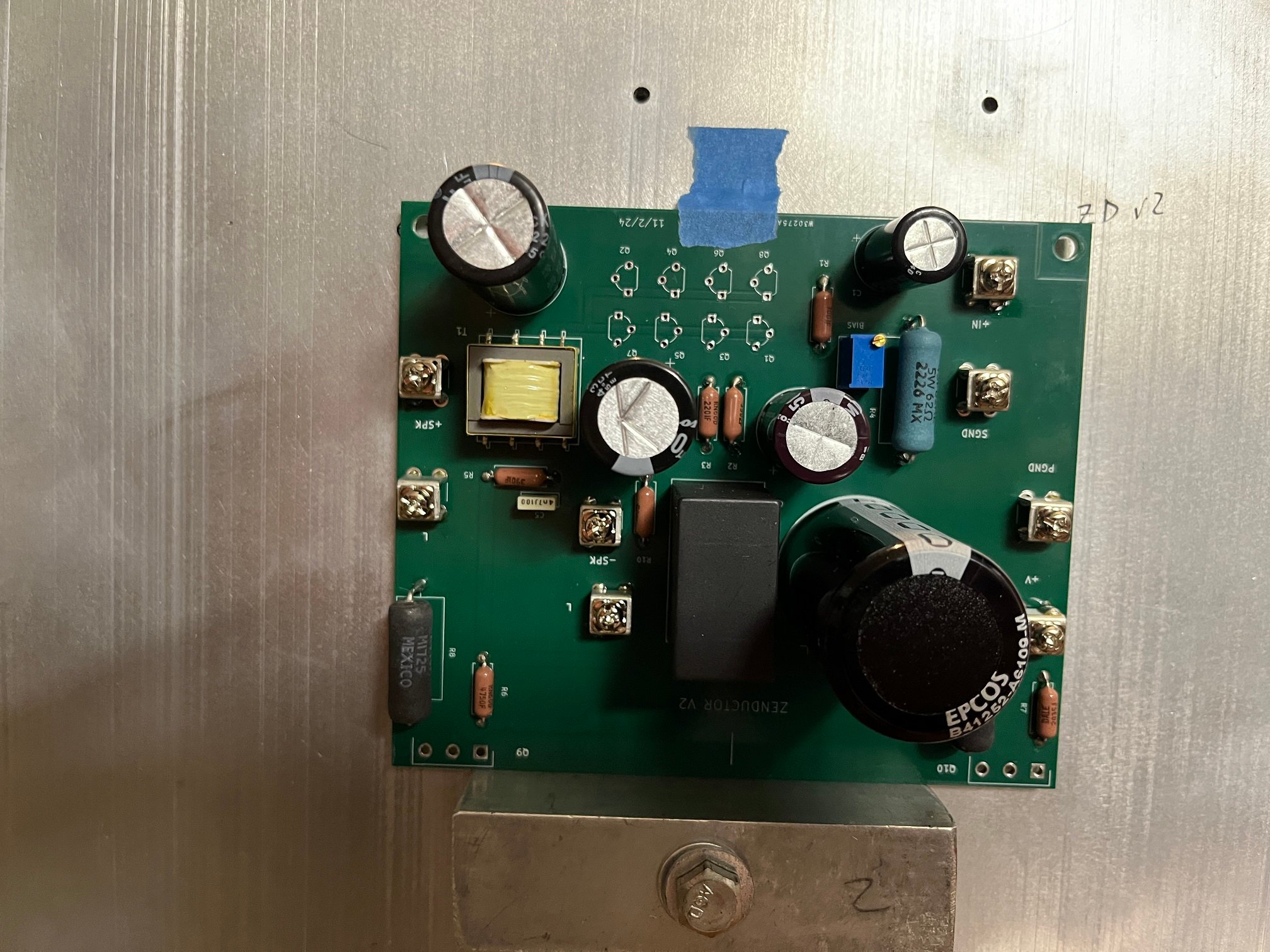

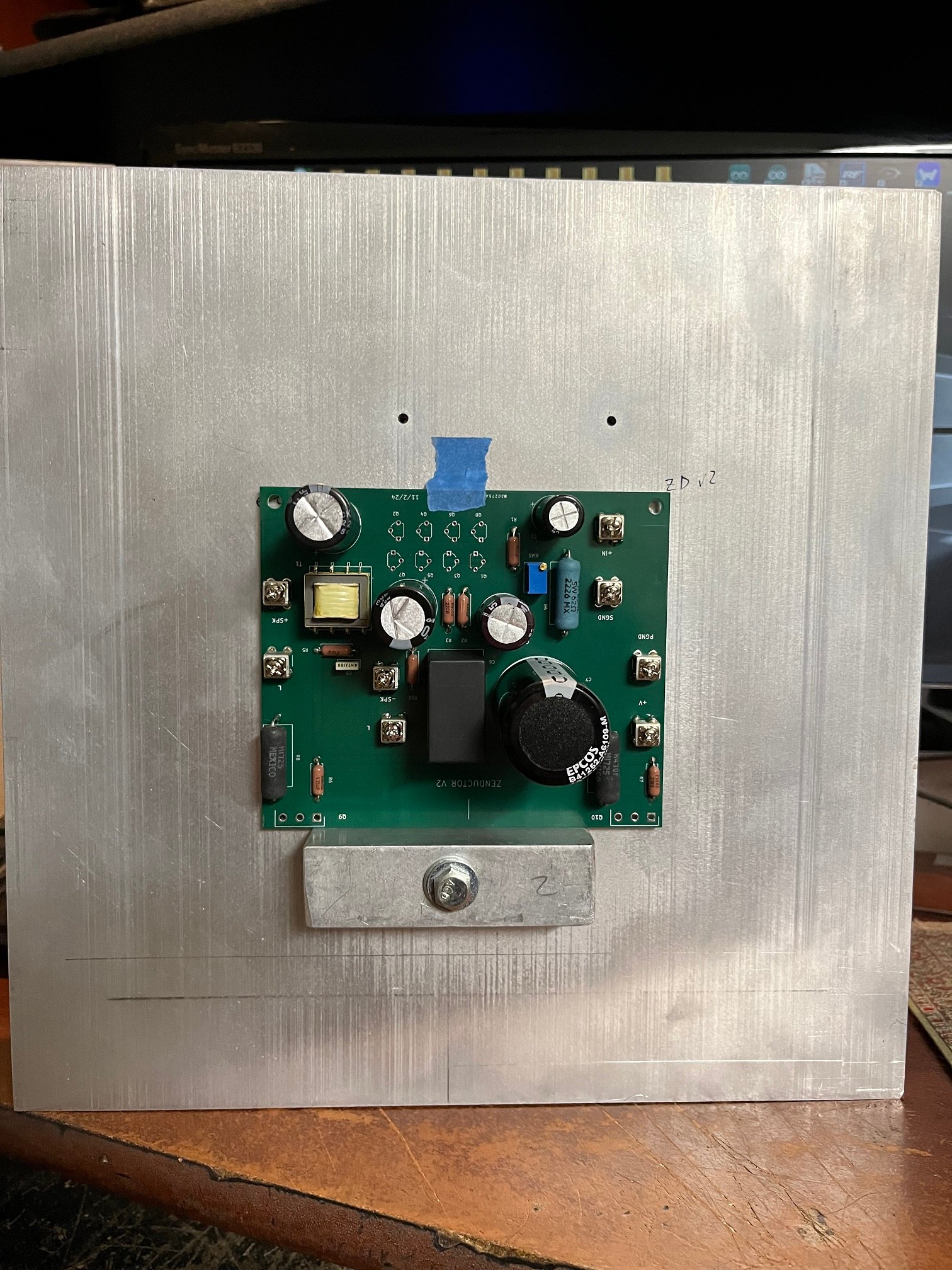

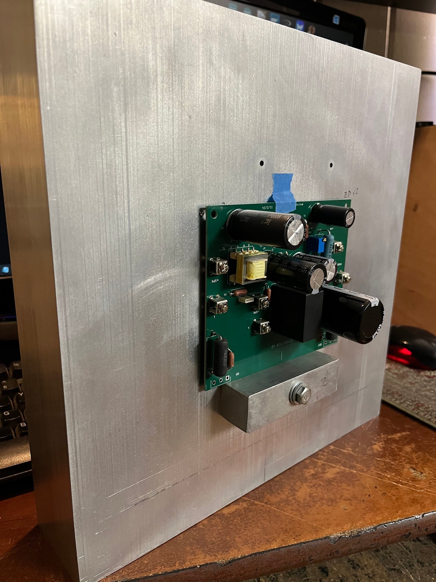

I am the guy that Nelson describes as breaking into a sweat when confronted with the 3 legged critters. For the J113, I am assuming that a raw IDSS match is all thats needed?
