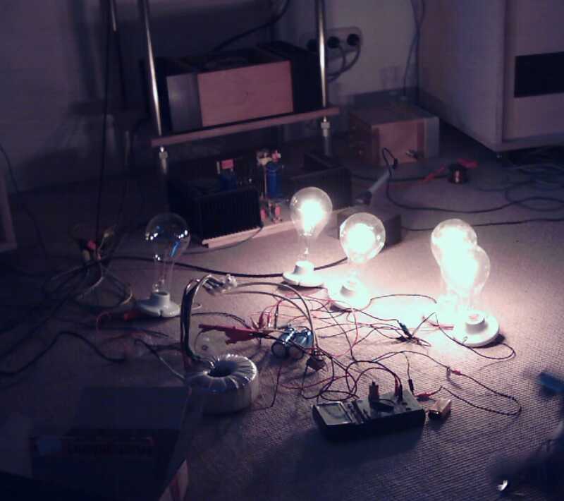

as i understand it, in this case (http://www.passdiy.com/projects/zenlite1.htm) some inductivity would be very advantageous....

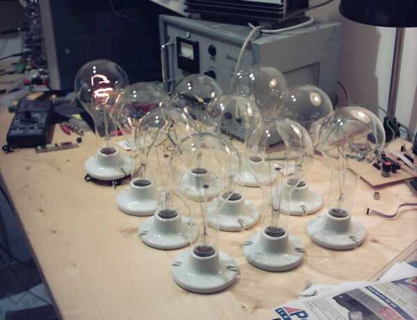

I bought them in mexico city on the street. 10 * 300W + ceramic sockets about 30€. Very happy KLM managed to transport without breaking them.
Now the hard decision is: balanced? balanced and x-ed?
At the Home Depot, the same ceramic sockets were $0.97
thats about the same as in mexico: 120peso for 10 sockets, ca. 200 for 10 bulbs.
now testing: 4 bulbs at 47V give 5.7A and the transformer 18+18V 500VA has 29°C after 1h.
