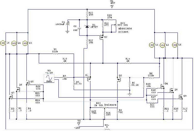

how about zenlight X?
This could be cool...
You would only need about 130 watts of heatsinking to get 25-30 watts into 8 ohms. Of course, you would need 6 250 watt bulbs, which will have about 60 watts each on them!
sorry about the poor image quality
Haven't constructed it, but it simulates well... seems stable (maybe even more than the aleph X) I think it would work. It require hefty supplies, that is for sure!
I was using IRFI540G parts for the simulation (they were what was in my library) but I don't see why IRFP240's or any of the other popular transistors wouldn't work.
Actually, looking at it again, it will do about 35 watts into 8 or 6 ohms, current limited. It really does need more bias current. If you raise the + rail to 60V, it will do about 60 watts into 4 ohms, but the dissipation on the transistors goes up to about 200 watts- about 32 watts each. The bulbs double their dissipation too.

Re: how about zenlight X?
Way Cool. Sort of an Aleph X lite.

Are you in a position to clean up the schematic you posted? I would find it much more interesting if I could see it clearly. Being's that I'm a carpenter, not an E.E., I need all the help I can get with electronics, i.e. a clean schematic for a start. If you are able, a description of how the circuit operates would be fantastic. A show of options and their associated benefits would be most useful.
