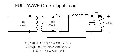

how to use transformer correctly
This is a diagram of a power supply I gleaned from a Hammond faq. I have 50-0-50 volt secondaries. If I read this schematic correctly, I could end up with 45 volts, no center tap and a whole bunch of current!
Any comments?
John
I'm not having any luck with the graphics.......
Any comments?
John
