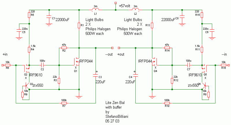

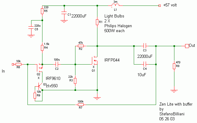

The schematic below show some modification that reflects listning tests preference.
The first is the rail: from 45 volts to 57 , with 2 light bulbs the current trough the circuit is 1.9A.
The second is the implementation of a cascode operation for the buffer. The Ztx550 infact cascodes the Irf9610 .
IMHO the amplifier sounds VERY good and I like the changes that cascoding the buffer produce.They are mainly a sense of lack of compressions especially in the sound of the bass guitars.

In Nelsons balanced circuit without output C´s the bias - setting resistors are lower value, i don´t understand why.
What i would like to know: with the input buffer, why C2 is still 100uF? I don´t have 100uF film cap, isn´t a much lower value enough?

I don't want to rain on any parade, but the bipolar transistor is not cascoding the input device. Its connection makes just a diode in series with the Drain.
More to the point, the input P channel Mosfet doesn't benefit from cascoding as its Drain is already seeing a low impedance (ground) and the Drain-Source voltage is held constant because the input to the main gain stage (which the Source of the input device looks at) is a virtual ground.
