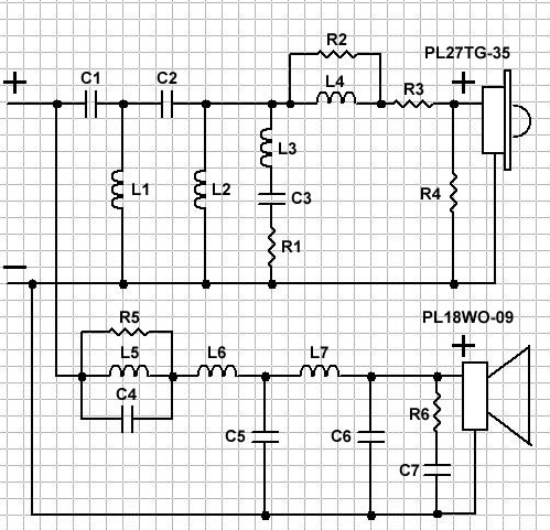

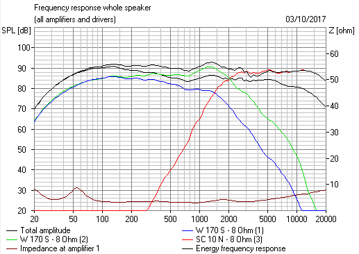

Take a difficult woofer, which incidentally, Troels Gravesen doesn't think is strictly suitable for a 2.5kHz two way:
Give it a weird and low 1.7kHz crossover.

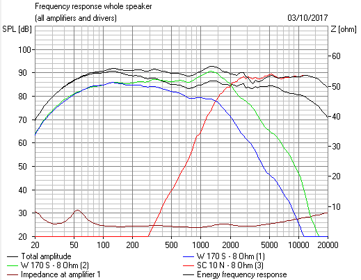

I just ran the sim with imported Zaph FRD and ZMA files for the woofer. It's not pretty. That lump at 1.2kHz is stubborn. And we know about the breakup at about 4.5kHz. Little bit better with a 0.7mH bass coil, IMO. It worked a bit better as a regular MTM too.
I just dug up his old SP95 design which has been hidden from his site for a while now and I see where he said that. I did catch him hinting at it not being suitable in a 2-way elsewhere a while ago too.
At this point it is a fair bit better. At least it no longer makes me want to shut off the sound on 90% of recordings like it used to. I really find that the 3.2khz cut makes a nice difference and makes the speaker less fatiguing. I only have the EQ cut but 4-5db too. When I cut at 1khz (which is as close to 1.2 as I can get), it doesn't seem to make much of an improvement. The bump here is not particularly offensive to me I guess.
I will maybe try to put a notch filter on the woofer in the crossover for the 3.2khz region, but only if my next build doesn't wind up re-using drivers from these speakers. I was considering Troels' 3-way using the dual 8531 woofers and the 4" revelator mid, but I don't know yet which direction I will go. So many designs I would like to try, as well as the possibility of designing my own possibly even going with an active XO system.

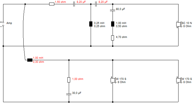

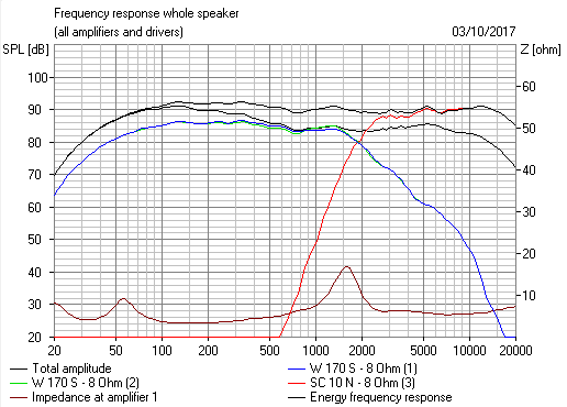

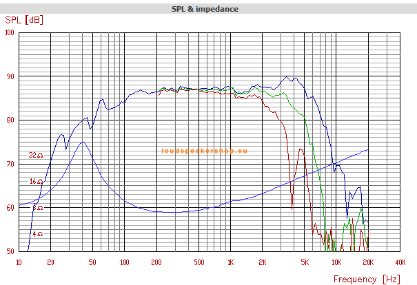

Well, I've made tremendous progress with this rank-bad Zaph 2.5 design! 😀
The problem really is that the bass is too difficult for a overly simple 2.5 way circuit.
The Zaph 2.0 two-way looks OK. Which is why eriksquires gets on with it with his 4531.
See the 18W/8531G00 (Sliced paper) bass gets some serious rolloff. Big old 2.7mH bass coil! And more of a third order filter.
I see no need for measuring equipment or microphones since we have the ZMA and FRD files for the woofer. Can't be bothered with the tweeter, since they are all much the same and dominated electrically by the filter.
My TMM design is MUCH better than Zaph's IMNSHO, even if I don't like the woofers at all. Phase is better and more aligned. FR is smoother. Impedance could be improved, but not too shocking. I have speakers with impedance like this, and they work, and would be excellent bi-wired. The tweeter is not working so hard so will sound sweeter.
A few notes. I didn't work too hard at the tweeter so impedance is not strictly accurate. I did think Zaph should have used a smaller (2.7R) resistor in the LCR. But not a biggie. In fact a single 1mH coil would work almost exactly the same. I would keep the coils well apart and right-angled. That 1mH in the tweeter circuit could pick up a lot of bass-coil rubbish.

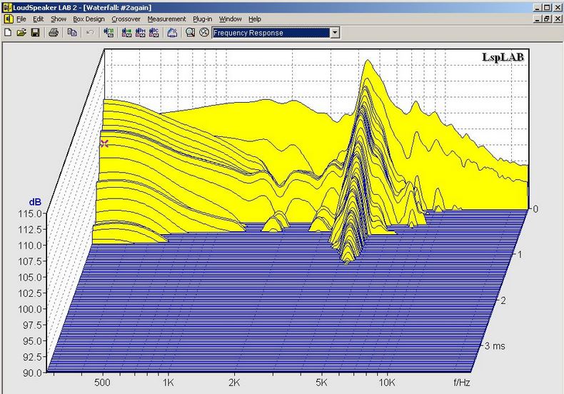

Originally the problem was a large peak at 1 kHz. Now it seems to be a problem at 3.2kHz. Have you:
1. Tried a completely different amp and source. Even if the amp is a cheap one you can see if maybe your dac is the problem or maybe there's some hidden frequency adjustment in your AV amp.
2. Listened to the woofers individually with a frequency scan (I use one from you-tube). This is without the crossover. Then hook up each woofer individually to the crossover and listen to that. If there is a large peak you will hear it.
3. If the woofers are sounding good then add in the tweeter and see what happens. Run a sweep again on the entire speaker.
What I'm getting at is that even if you do not have test equipment you can accomplish much by just listening. Also, I find for myself that it helps to deal with one thing at a time when troubleshooting.

What we think is going on here is this in the 2.5 way:
Not only is that a low crossover, but a very shallow one too. Compounded by a considerable BW3 overlap that pushes the tweeter even harder. 16uF and 0.25mH is VERY low for a 1" Tweeter, and I think the LCR notch could be deeper, because Troels uses 2.2R in his 6600 Fs LCR.
I think a more phase-aligned TMM design will help distortion:
This just works better at every level IMO. You could even add a 4.5kHz tank-notch easily enough around 15R and 1.2uF across the bass coil.
Tweeter sound depends quite critically in keeping it away from overly low and shallow crossover. My little Monacor HT-22/8 cone tweeters are happy as Larry on 3rd order 3.5kHz. Give them second-order 2.5 kHz and they just don't sound as clean.
Now, ACOUSTICALLY the second order filter sounds better than the third. But it adds distortion, and after an hour or so it annoys me. This is the whole Little Girl with a Guitar syndrome. Great on Folk, rubbish on dense orchestral music.
The Michael Chua 1.7 kHz crossover is a very different animal. Steep LR4 4th order slopes and the characteristic crossover impedance peak of phase-aligned: Vifa PL18 Frequency Response

Everybody seems to be in denial about how wretched this horribly overpriced Scanspeak sliced paper 18W-8531-G00 6" woofer actually is.
If my 5-y-o nephews admitted to slicing the cone with a knife and then gluing it back together before I got home, would I be pleased? Not really too thrilled, TBH.
Below is Michael Chua's preferred paper Vifa PL18W0 woofer. Much better response that I might work with. Lastly is a typical metal woofer. Well, forget about it, IMO. Unless you are seriously good at filters.
