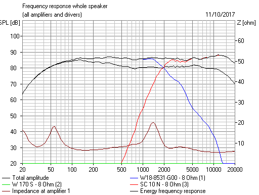

So far so good. What I have discovered is that my least favourite speaker in the Universe, aka 6" plus 1", works quite well in negative polarity. Clearly the Scanspeak 18W/8531 G00 is well constructed. Solid cast frame, damping rings an' all the rest of it.

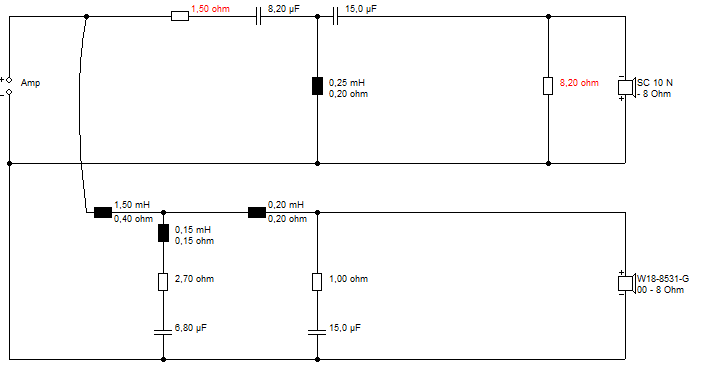

If I was stuck with these drivers, I would build it as a two way. The 8.2R shunt is just a bit of impedance correction for my modelled SC 10 N Visaton tweeter. The actual 6600 scanspeak tweeter is near 3 ohms.
638519d1507073096-zaph-madisound-zrt-2-5-a-zaph-2-5-tower-8531-6600-jpg
The two way works quite well. I have used real ZMA and FRD files. I like the power response. Only thing I don't like is the impedance bump at 1.4 kHz.
If it all got on my nerves, I'd consider some creative variation on the Ekta-Grande. But I'd try and get the impedance up and flatter.

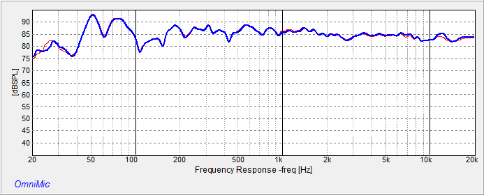

Initial measurements
Well here are my first measurements. Gated at 4ms before first reflections but I added what they call a blended response below 600hz which I understand allows a longer gate as required to get a measurement out of it.
The measurements were taken in the middle of the room at 2.83V, at tweeter height & 1 meter away. The FR graphs of left and right speaker are both on the same image.

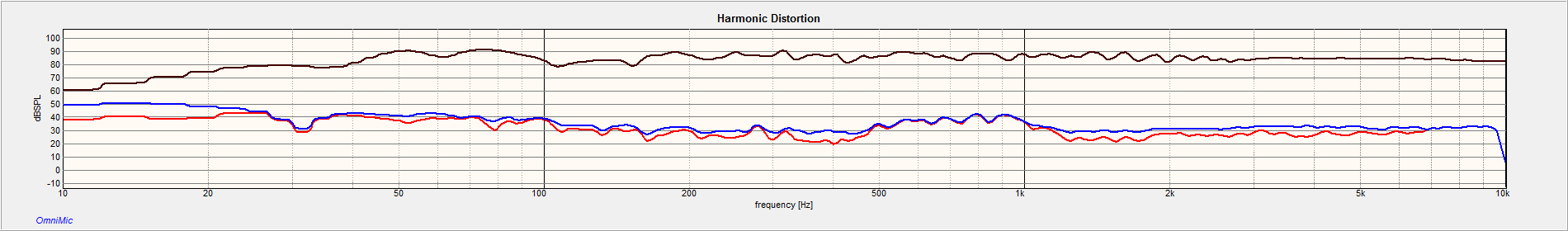

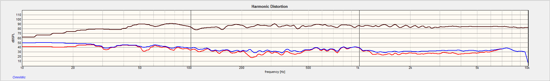

The distortion plots show the 2nd harmonic and then a total of 2nd to 5th harmonics.

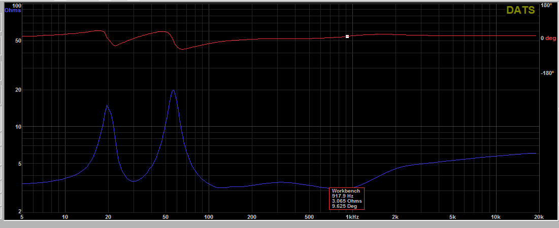

impedance measurement. Basically identical on the other speaker. Pretty wide area around 3 ohms. Maybe not ideal, but, my amp is supposed to be able to handle 4 ohm speakers and I can tell now that even just 2.8V is fairly loud so I don't need a lot of watts at my usual listening levels.
To my untrained eyes, I don't see any glaring problems in any of this. The response in the low frequencies needs to be taken with a grain of salt due to the way the measurement was taken. BTW the FR graph has 1/24 octave smoothing.

That's pretty good for an in-room response, and from both speakers.
The crossovers appear to be working as they should, no major peaks or dips.
The slight peak around 600c/s seems typical and should not be audible,being narrow band.

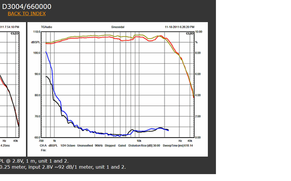

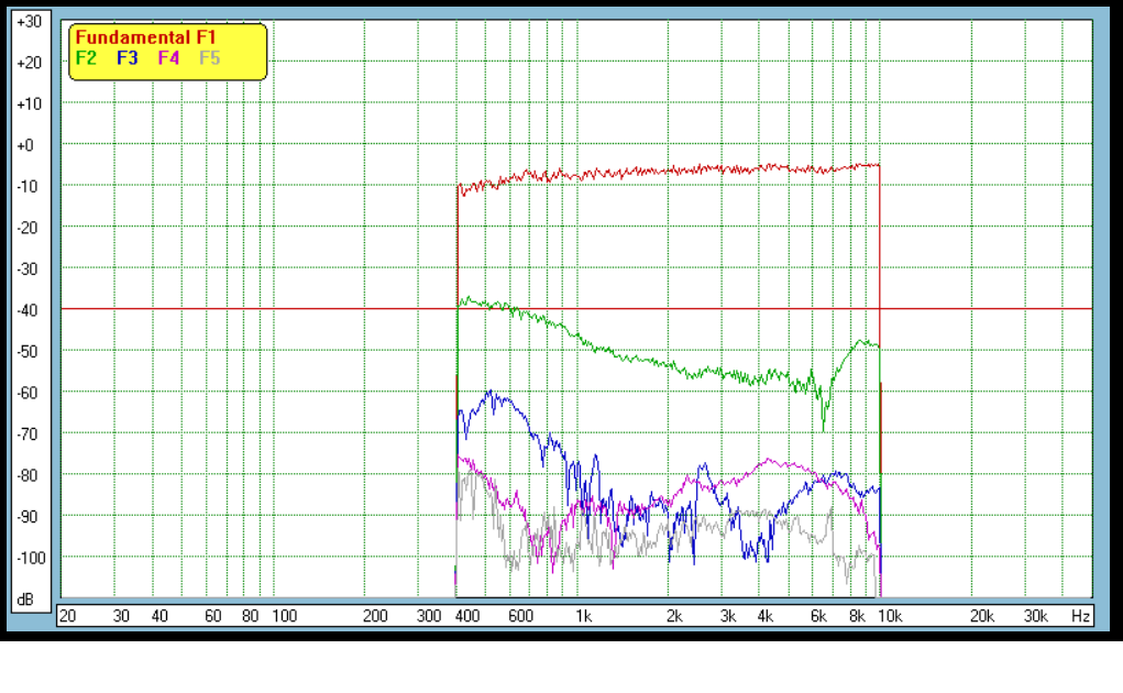

I wonder if you are hearing the distortion in the 700-1000Hz range. Maybe coming from the tweeter which may not sound pleasant.
Attached is a test on the tweeter from Troel's site. The distortion rises below 1500 Hz or so and it may be that the 2nd order crossover is not enough for the low crossover point. Some are more sensitive than others; thinking of system7 especially 😀.
My ZRT2.0 has a bit of distortion (not measured; just listening) but you need to turn it up a fair amount. It is however a 3rd order crossover with quite a bit of padding.
The link SS-domes
Here is a test from Zaph's site. Shows rising 3rd order below 1000Hz; however distortion is actually pretty low in comparison to the other tweeters he tested😕.
It's a possibility. My higher order distortion measured higher than Zaphs across the board but that was through the crossover. Maybe I did something wrong in that measurement too. Just got the equipment today so I have to learn how to take accurate measurements and more about interpreting them.
