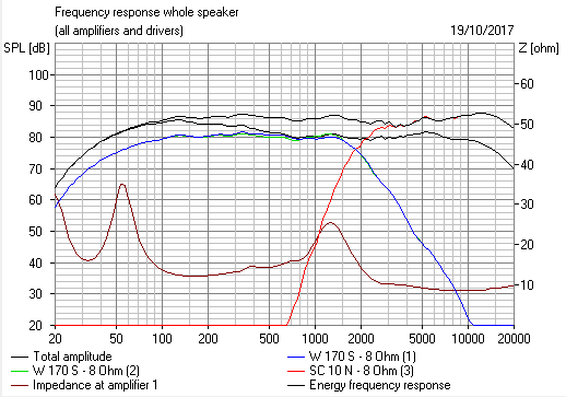

Zaph 2.5 way modelled with Zaph's own FRD and ZMA bass files, AFAIK. I've winged it on a slightly different tweeter.
638377d1506990231-zaph-madisound-zrt-2-5-a-zaph-2-5-0-5mh-bass-coil-png

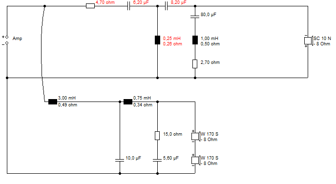

I wouldn't give up on this expensive investment. I found a third order series MTM or TMM looked much better, below. Tweeter crosses around 2.2kHz on steeper slopes. Less 5kHz cone breakup from the basses. I haven't allowed for the 3 ohm tweeter, but that's not hard.

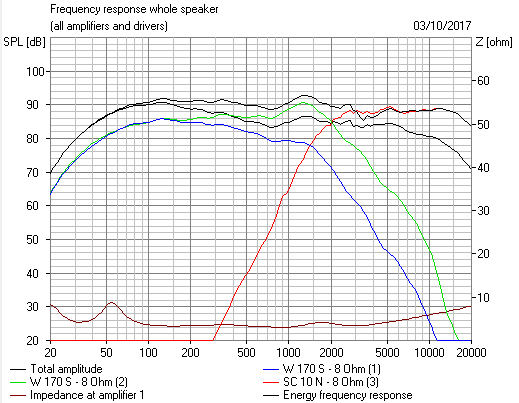

FWIW, below is the steeper circuit I was playing with. One of many ways to skin this cat. Using Scanspeak FRD and ZMA on the bass which I believe to be about right. The tweeter circuit needs more adjustment though, because your 3 ohm tweeter is going to work differently.
attachment.php
Impedance correction on a bass has a lot going for it, IMO. Damps the voicecoil.
