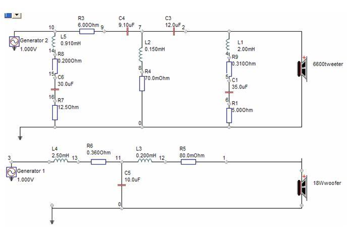

The Zaph design is, in fact, a sort of 2kHz Butterworth with a 90 degree phase on the tweeter according to my sim. Which must push it harder than usual.
634408d1504895806-zaph-madisound-zrt-2-5-a-zrt-2-5way-crossover-gif
I posted the files here, if you want to try this:
http://www.diyaudio.com/forums/multi-way/311454-zaph-madisound-zrt-2-5-a-15.html#post5218875
I don't have the 6600 tweeter files, but they always seem to work much the same to me.

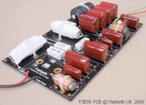

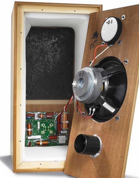

Here's a couple of Harbeth two-ways to enjoy. These are much steeper filters! Lot of design gone into those! I always prefer steeper low-distortion designs.
